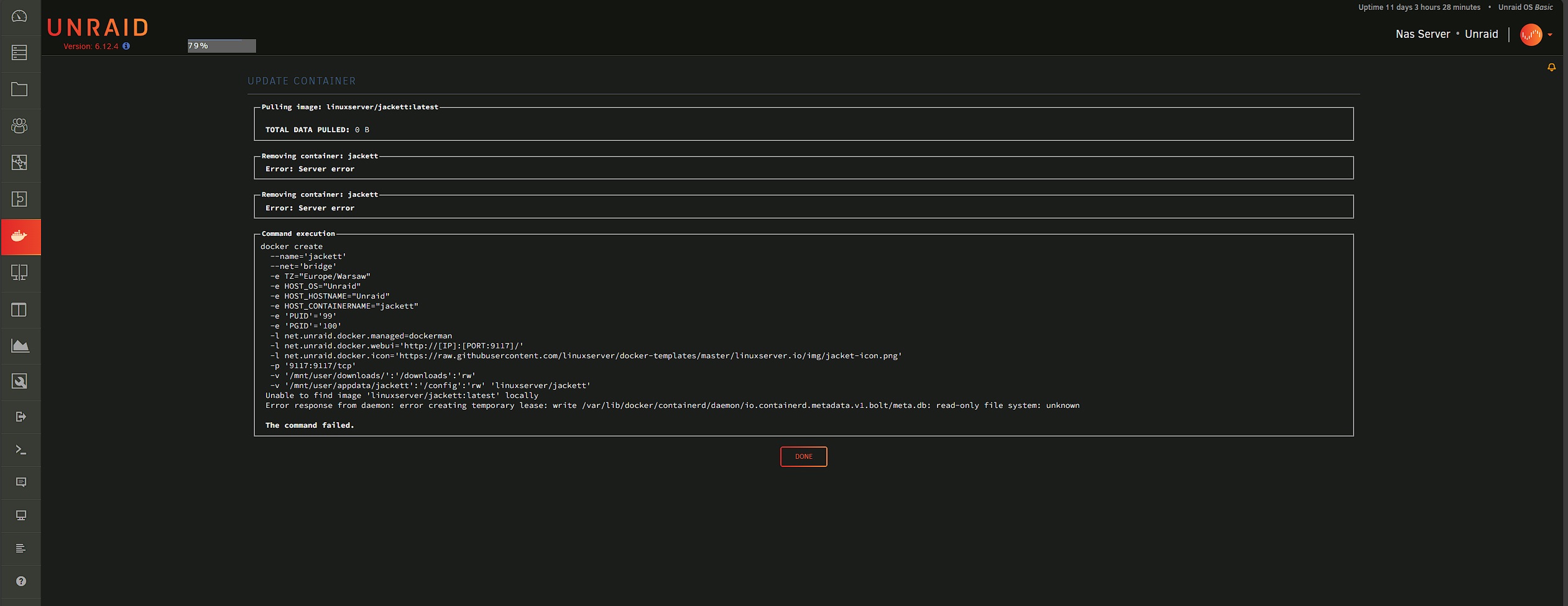

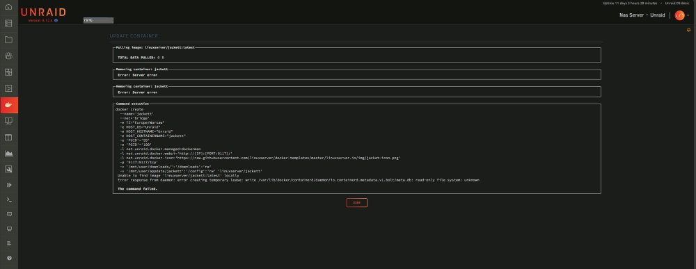

  5. Hi, I can not start, remove, edit, update, install any container anymore. Also have some orphaned containers I can't delete because of "Server error" When I try to edit then apply a container it throws error (see picture). What's wrong with my unraid installation? unraid-diagnostics-20230921-1529.zip
  6. Ok, after I have deleted the BTRS.key, no more errors. I don't know from where did I get this file. I followed an online guide one and a half year ago when I bought the basic license. On that guide there was a link to download unraid image to be written on the usb. I don't know what the guide was, I tried to look in my browsing history but with no success. Anyway there are no more that errors. Thanks
