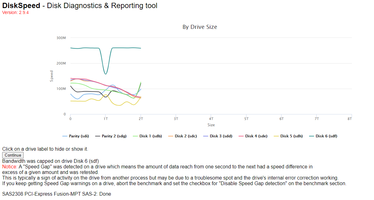

  15. Then wouldn't my performance improve when writing to the Seagate drives? It seems to actually be faster when it was on the WD. Now that it hit 1TB it has moved onto a Seagate disk and seems even slower, albeit not much slower. Is this just a normal function of calculating parity? Also, I'm assuming that read speeds won't be this problematic. What is the best way to test this before dropping $90 on Unraid? I've already spent a week trying to set this up, I'd hate to waste the money too only to realize I'll be better off going back to Lubuntu with the old RAID card.
  16. I understand I won't be getting the best performance from the WD drives. I'm even okay with half the speed. Before switching to unraid I had these exact drives in a traditional RAID 5 connected to the onboard P410i and was getting 40-60 MiB/s. Not to mention at present it is writing to a Seagate drive which is perpendicular recording. I'm not expecting blazing fast speeds. Just better than 4 MiB/s. Once I'm finished dumping all my existing media on the array I'll be adding a TiB of SSD cache and will hopefully never be moving this much data to the array again so SMR should be a non-issue. I just didn't want to hit the SSDs when I have 8TiB of media to get everything started. At this rate my trial license will run out before I get a chance to actually test my PLEX setup with all my data.
  17. So I started up a large transfer again. The speed starts out great at about 130 MiB/s. After about 2 minutes it's down to 30 MiB/s. At the 5 minute mark it's down to 20 and just keeps sliding downward. By 10 minutes it's at 4-5 MiB/s and just stays there.
  18. Everything seems normal with one obvious outlier that is oddly fast. Not sure what this means.
  19. Maybe slightly faster? Seems pretty much the same to me. But copying to my desktop I get about 130 MiB/s from the USB drive.
