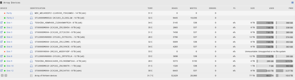

  9. Ok, I built a new config, kept the parity drive in my jbod (going to work on moving off asap), and I'm currently doing a no-write parity check. Everything SEEMS to be functioning. Even the data in disk7 seems to be there. And accessible. So take aways get the fuck off jbod usb is bad. and replace drive 1 asap.
  10. Well I have moved one disk out, specifically the 14tb parity disk. However now the system isnt seeing it at all. And currently I am unable to move the other 4 disks out. Gonna have to buy a new sata expansion card. and trays. *edit* Ok moved the parity drive back into the JBOD and I can see it again. It still is listed as disabled but at least I can see it again.
  11. Well... so what do you think my option is at this point? It sounds like you're saying I'm boned.
  12. I dont think I have anything irreplaceable on them. Its like 75% plex. And everything should be covered by parity.

  14. Well that is a lot of corruptions for a disk that SMART is telling me is healthy.
  15. Phase 1 - find and verify superblock... Phase 2 - using internal log - zero log... - scan filesystem freespace and inode maps... - found root inode chunk Phase 3 - for each AG... - scan (but don't clear) agi unlinked lists... - process known inodes and perform inode discovery... - agno = 0 - agno = 1 - agno = 2 Metadata corruption detected at 0x438a03, xfs_inode block 0x100227290/0x4000 bad CRC for inode 4297224872 bad magic number 0x241a on inode 4297224872 bad version number 0x6d on inode 4297224872 bad next_unlinked 0xdeda645c on inode 4297224872 inode identifier 1575615604729810958 mismatch on inode 4297224872 bad CRC for inode 4297224873 bad magic number 0x241a on inode 4297224873 bad version number 0x6d on inode 4297224873 bad next_unlinked 0xdeda645c on inode 4297224873 inode identifier 1575615604729810958 mismatch on inode 4297224873 bad CRC for inode 4297224874 bad magic number 0x241a on inode 4297224874 bad version number 0x6d on inode 4297224874 bad next_unlinked 0xdeda645c on inode 4297224874 inode identifier 1575615604729810958 mismatch on inode 4297224874 bad CRC for inode 4297224875 bad magic number 0x241a on inode 4297224875 bad version number 0x6d on inode 4297224875 bad next_unlinked 0xdeda645c on inode 4297224875 inode identifier 1575615604729810958 mismatch on inode 4297224875 bad CRC for inode 4297224876 bad magic number 0x241a on inode 4297224876 bad version number 0x6d on inode 4297224876 bad next_unlinked 0xdeda645c on inode 4297224876 inode identifier 1575615604729810958 mismatch on inode 4297224876 bad CRC for inode 4297224877 bad magic number 0x241a on inode 4297224877 bad version number 0x6d on inode 4297224877 bad next_unlinked 0xdeda645c on inode 4297224877 inode identifier 1575615604729810958 mismatch on inode 4297224877 bad CRC for inode 4297224878 bad magic number 0x241a on inode 4297224878 bad version number 0x6d on inode 4297224878 bad next_unlinked 0xdeda645c on inode 4297224878 inode identifier 1575615604729810958 mismatch on inode 4297224878 bad CRC for inode 4297224879 bad magic number 0x241a on inode 4297224879 bad version number 0x6d on inode 4297224879 bad next_unlinked 0xdeda645c on inode 4297224879 inode identifier 1575615604729810958 mismatch on inode 4297224879 bad CRC for inode 4297224880 bad magic number 0x241a on inode 4297224880 bad version number 0x6d on inode 4297224880 bad next_unlinked 0xdeda645c on inode 4297224880 inode identifier 1575615604729810958 mismatch on inode 4297224880 bad CRC for inode 4297224881 bad magic number 0x241a on inode 4297224881 bad version number 0x6d on inode 4297224881 bad next_unlinked 0xdeda645c on inode 4297224881 inode identifier 1575615604729810958 mismatch on inode 4297224881 bad CRC for inode 4297224882 bad magic number 0x241a on inode 4297224882 bad version number 0x6d on inode 4297224882 bad next_unlinked 0xdeda645c on inode 4297224882 inode identifier 1575615604729810958 mismatch on inode 4297224882 bad CRC for inode 4297224883 bad magic number 0x241a on inode 4297224883 bad version number 0x6d on inode 4297224883 bad next_unlinked 0xdeda645c on inode 4297224883 inode identifier 1575615604729810958 mismatch on inode 4297224883 bad CRC for inode 4297224884 bad magic number 0x241a on inode 4297224884 bad version number 0x6d on inode 4297224884 bad next_unlinked 0xdeda645c on inode 4297224884 inode identifier 1575615604729810958 mismatch on inode 4297224884 bad CRC for inode 4297224885 bad magic number 0x241a on inode 4297224885 bad version number 0x6d on inode 4297224885 bad next_unlinked 0xdeda645c on inode 4297224885 inode identifier 1575615604729810958 mismatch on inode 4297224885 bad CRC for inode 4297224886 bad magic number 0x241a on inode 4297224886 bad version number 0x6d on inode 4297224886 bad next_unlinked 0xdeda645c on inode 4297224886 inode identifier 1575615604729810958 mismatch on inode 4297224886 bad CRC for inode 4297224887 bad magic number 0x241a on inode 4297224887 bad version number 0x6d on inode 4297224887 bad next_unlinked 0xdeda645c on inode 4297224887 inode identifier 1575615604729810958 mismatch on inode 4297224887 bad CRC for inode 4297224888 bad magic number 0x241a on inode 4297224888 bad version number 0x6d on inode 4297224888 bad next_unlinked 0xdeda645c on inode 4297224888 inode identifier 1575615604729810958 mismatch on inode 4297224888 bad CRC for inode 4297224889 bad magic number 0x241a on inode 4297224889 bad version number 0x6d on inode 4297224889 bad next_unlinked 0xdeda645c on inode 4297224889 inode identifier 1575615604729810958 mismatch on inode 4297224889 bad CRC for inode 4297224890 bad magic number 0x241a on inode 4297224890 bad version number 0x6d on inode 4297224890 bad next_unlinked 0xdeda645c on inode 4297224890 inode identifier 1575615604729810958 mismatch on inode 4297224890 bad CRC for inode 4297224891 bad magic number 0x241a on inode 4297224891 bad version number 0x6d on inode 4297224891 bad next_unlinked 0xdeda645c on inode 4297224891 inode identifier 1575615604729810958 mismatch on inode 4297224891 bad CRC for inode 4297224892 bad magic number 0x241a on inode 4297224892 bad version number 0x6d on inode 4297224892 bad next_unlinked 0xdeda645c on inode 4297224892 inode identifier 1575615604729810958 mismatch on inode 4297224892 bad CRC for inode 4297224893 bad magic number 0x241a on inode 4297224893 bad version number 0x6d on inode 4297224893 bad next_unlinked 0xdeda645c on inode 4297224893 inode identifier 1575615604729810958 mismatch on inode 4297224893 bad CRC for inode 4297224894 bad magic number 0x241a on inode 4297224894 bad version number 0x6d on inode 4297224894 bad next_unlinked 0xdeda645c on inode 4297224894 inode identifier 1575615604729810958 mismatch on inode 4297224894 bad CRC for inode 4297224895 bad magic number 0x241a on inode 4297224895 bad version number 0x6d on inode 4297224895 bad next_unlinked 0xdeda645c on inode 4297224895 inode identifier 1575615604729810958 mismatch on inode 4297224895 bad CRC for inode 4297224872, would rewrite bad magic number 0x241a on inode 4297224872, would reset magic number bad version number 0x6d on inode 4297224872, would reset version number bad next_unlinked 0xdeda645c on inode 4297224872, would reset next_unlinked inode identifier 1575615604729810958 mismatch on inode 4297224872 would have cleared inode 4297224872 bad CRC for inode 4297224873, would rewrite bad magic number 0x241a on inode 4297224873, would reset magic number bad version number 0x6d on inode 4297224873, would reset version number bad next_unlinked 0xdeda645c on inode 4297224873, would reset next_unlinked inode identifier 1575615604729810958 mismatch on inode 4297224873 would have cleared inode 4297224873 bad CRC for inode 4297224874, would rewrite bad magic number 0x241a on inode 4297224874, would reset magic number bad version number 0x6d on inode 4297224874, would reset version number bad next_unlinked 0xdeda645c on inode 4297224874, would reset next_unlinked inode identifier 1575615604729810958 mismatch on inode 4297224874 would have cleared inode 4297224874 bad CRC for inode 4297224875, would rewrite bad magic number 0x241a on inode 4297224875, would reset magic number bad version number 0x6d on inode 4297224875, would reset version number bad next_unlinked 0xdeda645c on inode 4297224875, would reset next_unlinked inode identifier 1575615604729810958 mismatch on inode 4297224875 would have cleared inode 4297224875 bad CRC for inode 4297224876, would rewrite bad magic number 0x241a on inode 4297224876, would reset magic number bad version number 0x6d on inode 4297224876, would reset version number bad next_unlinked 0xdeda645c on inode 4297224876, would reset next_unlinked inode identifier 1575615604729810958 mismatch on inode 4297224876 would have cleared inode 4297224876 bad CRC for inode 4297224877, would rewrite bad magic number 0x241a on inode 4297224877, would reset magic number bad version number 0x6d on inode 4297224877, would reset version number bad next_unlinked 0xdeda645c on inode 4297224877, would reset next_unlinked inode identifier 1575615604729810958 mismatch on inode 4297224877 would have cleared inode 4297224877 bad CRC for inode 4297224878, would rewrite bad magic number 0x241a on inode 4297224878, would reset magic number bad version number 0x6d on inode 4297224878, would reset version number bad next_unlinked 0xdeda645c on inode 4297224878, would reset next_unlinked inode identifier 1575615604729810958 mismatch on inode 4297224878 would have cleared inode 4297224878 bad CRC for inode 4297224879, would rewrite bad magic number 0x241a on inode 4297224879, would reset magic number bad version number 0x6d on inode 4297224879, would reset version number bad next_unlinked 0xdeda645c on inode 4297224879, would reset next_unlinked inode identifier 1575615604729810958 mismatch on inode 4297224879 would have cleared inode 4297224879 bad CRC for inode 4297224880, would rewrite bad magic number 0x241a on inode 4297224880, would reset magic number bad version number 0x6d on inode 4297224880, would reset version number bad next_unlinked 0xdeda645c on inode 4297224880, would reset next_unlinked inode identifier 1575615604729810958 mismatch on inode 4297224880 would have cleared inode 4297224880 bad CRC for inode 4297224881, would rewrite bad magic number 0x241a on inode 4297224881, would reset magic number bad version number 0x6d on inode 4297224881, would reset version number bad next_unlinked 0xdeda645c on inode 4297224881, would reset next_unlinked inode identifier 1575615604729810958 mismatch on inode 4297224881 would have cleared inode 4297224881 bad CRC for inode 4297224882, would rewrite bad magic number 0x241a on inode 4297224882, would reset magic number bad version number 0x6d on inode 4297224882, would reset version number bad next_unlinked 0xdeda645c on inode 4297224882, would reset next_unlinked inode identifier 1575615604729810958 mismatch on inode 4297224882 would have cleared inode 4297224882 bad CRC for inode 4297224883, would rewrite bad magic number 0x241a on inode 4297224883, would reset magic number bad version number 0x6d on inode 4297224883, would reset version number bad next_unlinked 0xdeda645c on inode 4297224883, would reset next_unlinked inode identifier 1575615604729810958 mismatch on inode 4297224883 would have cleared inode 4297224883 bad CRC for inode 4297224884, would rewrite bad magic number 0x241a on inode 4297224884, would reset magic number bad version number 0x6d on inode 4297224884, would reset version number bad next_unlinked 0xdeda645c on inode 4297224884, would reset next_unlinked inode identifier 1575615604729810958 mismatch on inode 4297224884 would have cleared inode 4297224884 bad CRC for inode 4297224885, would rewrite bad magic number 0x241a on inode 4297224885, would reset magic number bad version number 0x6d on inode 4297224885, would reset version number bad next_unlinked 0xdeda645c on inode 4297224885, would reset next_unlinked inode identifier 1575615604729810958 mismatch on inode 4297224885 would have cleared inode 4297224885 bad CRC for inode 4297224886, would rewrite bad magic number 0x241a on inode 4297224886, would reset magic number bad version number 0x6d on inode 4297224886, would reset version number bad next_unlinked 0xdeda645c on inode 4297224886, would reset next_unlinked inode identifier 1575615604729810958 mismatch on inode 4297224886 would have cleared inode 4297224886 bad CRC for inode 4297224887, would rewrite bad magic number 0x241a on inode 4297224887, would reset magic number bad version number 0x6d on inode 4297224887, would reset version number bad next_unlinked 0xdeda645c on inode 4297224887, would reset next_unlinked inode identifier 1575615604729810958 mismatch on inode 4297224887 would have cleared inode 4297224887 bad CRC for inode 4297224888, would rewrite bad magic number 0x241a on inode 4297224888, would reset magic number bad version number 0x6d on inode 4297224888, would reset version number bad next_unlinked 0xdeda645c on inode 4297224888, would reset next_unlinked inode identifier 1575615604729810958 mismatch on inode 4297224888 would have cleared inode 4297224888 bad CRC for inode 4297224889, would rewrite bad magic number 0x241a on inode 4297224889, would reset magic number bad version number 0x6d on inode 4297224889, would reset version number bad next_unlinked 0xdeda645c on inode 4297224889, would reset next_unlinked inode identifier 1575615604729810958 mismatch on inode 4297224889 would have cleared inode 4297224889 bad CRC for inode 4297224890, would rewrite bad magic number 0x241a on inode 4297224890, would reset magic number bad version number 0x6d on inode 4297224890, would reset version number bad next_unlinked 0xdeda645c on inode 4297224890, would reset next_unlinked inode identifier 1575615604729810958 mismatch on inode 4297224890 would have cleared inode 4297224890 bad CRC for inode 4297224891, would rewrite bad magic number 0x241a on inode 4297224891, would reset magic number bad version number 0x6d on inode 4297224891, would reset version number bad next_unlinked 0xdeda645c on inode 4297224891, would reset next_unlinked inode identifier 1575615604729810958 mismatch on inode 4297224891 would have cleared inode 4297224891 bad CRC for inode 4297224892, would rewrite bad magic number 0x241a on inode 4297224892, would reset magic number bad version number 0x6d on inode 4297224892, would reset version number bad next_unlinked 0xdeda645c on inode 4297224892, would reset next_unlinked inode identifier 1575615604729810958 mismatch on inode 4297224892 would have cleared inode 4297224892 bad CRC for inode 4297224893, would rewrite bad magic number 0x241a on inode 4297224893, would reset magic number bad version number 0x6d on inode 4297224893, would reset version number bad next_unlinked 0xdeda645c on inode 4297224893, would reset next_unlinked inode identifier 1575615604729810958 mismatch on inode 4297224893 would have cleared inode 4297224893 bad CRC for inode 4297224894, would rewrite bad magic number 0x241a on inode 4297224894, would reset magic number bad version number 0x6d on inode 4297224894, would reset version number bad next_unlinked 0xdeda645c on inode 4297224894, would reset next_unlinked inode identifier 1575615604729810958 mismatch on inode 4297224894 would have cleared inode 4297224894 bad CRC for inode 4297224895, would rewrite bad magic number 0x241a on inode 4297224895, would reset magic number bad version number 0x6d on inode 4297224895, would reset version number bad next_unlinked 0xdeda645c on inode 4297224895, would reset next_unlinked inode identifier 1575615604729810958 mismatch on inode 4297224895 would have cleared inode 4297224895 - agno = 3 - agno = 4 - agno = 5 - agno = 6 - agno = 7 - process newly discovered inodes... Phase 4 - check for duplicate blocks... - setting up duplicate extent list... - check for inodes claiming duplicate blocks... - agno = 0 - agno = 2 - agno = 6 - agno = 4 - agno = 5 - agno = 7 - agno = 1 - agno = 3 entry "bzbui_skin_bg-4x.gif" in shortform directory 4297224844 references free inode 4297224872 would have junked entry "bzbui_skin_bg-4x.gif" in directory inode 4297224844 would have corrected i8 count in directory 4297224844 from 9 to 8 bad CRC for inode 4297224872, would rewrite bad magic number 0x241a on inode 4297224872, would reset magic number bad version number 0x6d on inode 4297224872, would reset version number bad next_unlinked 0xdeda645c on inode 4297224872, would reset next_unlinked inode identifier 1575615604729810958 mismatch on inode 4297224872 would have cleared inode 4297224872 bad CRC for inode 4297224873, would rewrite bad magic number 0x241a on inode 4297224873, would reset magic number bad version number 0x6d on inode 4297224873, would reset version number bad next_unlinked 0xdeda645c on inode 4297224873, would reset next_unlinked inode identifier 1575615604729810958 mismatch on inode 4297224873 would have cleared inode 4297224873 bad CRC for inode 4297224874, would rewrite bad magic number 0x241a on inode 4297224874, would reset magic number bad version number 0x6d on inode 4297224874, would reset version number bad next_unlinked 0xdeda645c on inode 4297224874, would reset next_unlinked inode identifier 1575615604729810958 mismatch on inode 4297224874 would have cleared inode 4297224874 bad CRC for inode 4297224875, would rewrite bad magic number 0x241a on inode 4297224875, would reset magic number bad version number 0x6d on inode 4297224875, would reset version number bad next_unlinked 0xdeda645c on inode 4297224875, would reset next_unlinked inode identifier 1575615604729810958 mismatch on inode 4297224875 would have cleared inode 4297224875 bad CRC for inode 4297224876, would rewrite bad magic number 0x241a on inode 4297224876, would reset magic number bad version number 0x6d on inode 4297224876, would reset version number bad next_unlinked 0xdeda645c on inode 4297224876, would reset next_unlinked inode identifier 1575615604729810958 mismatch on inode 4297224876 would have cleared inode 4297224876 bad CRC for inode 4297224877, would rewrite bad magic number 0x241a on inode 4297224877, would reset magic number bad version number 0x6d on inode 4297224877, would reset version number bad next_unlinked 0xdeda645c on inode 4297224877, would reset next_unlinked inode identifier 1575615604729810958 mismatch on inode 4297224877 would have cleared inode 4297224877 bad CRC for inode 4297224878, would rewrite bad magic number 0x241a on inode 4297224878, would reset magic number bad version number 0x6d on inode 4297224878, would reset version number bad next_unlinked 0xdeda645c on inode 4297224878, would reset next_unlinked inode identifier 1575615604729810958 mismatch on inode 4297224878 would have cleared inode 4297224878 bad CRC for inode 4297224879, would rewrite bad magic number 0x241a on inode 4297224879, would reset magic number bad version number 0x6d on inode 4297224879, would reset version number bad next_unlinked 0xdeda645c on inode 4297224879, would reset next_unlinked inode identifier 1575615604729810958 mismatch on inode 4297224879 would have cleared inode 4297224879 bad CRC for inode 4297224880, would rewrite bad magic number 0x241a on inode 4297224880, would reset magic number bad version number 0x6d on inode 4297224880, would reset version number bad next_unlinked 0xdeda645c on inode 4297224880, would reset next_unlinked inode identifier 1575615604729810958 mismatch on inode 4297224880 would have cleared inode 4297224880 bad CRC for inode 4297224881, would rewrite bad magic number 0x241a on inode 4297224881, would reset magic number bad version number 0x6d on inode 4297224881, would reset version number bad next_unlinked 0xdeda645c on inode 4297224881, would reset next_unlinked inode identifier 1575615604729810958 mismatch on inode 4297224881 would have cleared inode 4297224881 bad CRC for inode 4297224882, would rewrite bad magic number 0x241a on inode 4297224882, would reset magic number bad version number 0x6d on inode 4297224882, would reset version number bad next_unlinked 0xdeda645c on inode 4297224882, would reset next_unlinked inode identifier 1575615604729810958 mismatch on inode 4297224882 would have cleared inode 4297224882 bad CRC for inode 4297224883, would rewrite bad magic number 0x241a on inode 4297224883, would reset magic number bad version number 0x6d on inode 4297224883, would reset version number bad next_unlinked 0xdeda645c on inode 4297224883, would reset next_unlinked inode identifier 1575615604729810958 mismatch on inode 4297224883 would have cleared inode 4297224883 bad CRC for inode 4297224884, would rewrite bad magic number 0x241a on inode 4297224884, would reset magic number bad version number 0x6d on inode 4297224884, would reset version number bad next_unlinked 0xdeda645c on inode 4297224884, would reset next_unlinked inode identifier 1575615604729810958 mismatch on inode 4297224884 would have cleared inode 4297224884 bad CRC for inode 4297224885, would rewrite bad magic number 0x241a on inode 4297224885, would reset magic number bad version number 0x6d on inode 4297224885, would reset version number bad next_unlinked 0xdeda645c on inode 4297224885, would reset next_unlinked inode identifier 1575615604729810958 mismatch on inode 4297224885 would have cleared inode 4297224885 bad CRC for inode 4297224886, would rewrite bad magic number 0x241a on inode 4297224886, would reset magic number bad version number 0x6d on inode 4297224886, would reset version number bad next_unlinked 0xdeda645c on inode 4297224886, would reset next_unlinked inode identifier 1575615604729810958 mismatch on inode 4297224886 would have cleared inode 4297224886 bad CRC for inode 4297224887, would rewrite bad magic number 0x241a on inode 4297224887, would reset magic number bad version number 0x6d on inode 4297224887, would reset version number bad next_unlinked 0xdeda645c on inode 4297224887, would reset next_unlinked inode identifier 1575615604729810958 mismatch on inode 4297224887 would have cleared inode 4297224887 bad CRC for inode 4297224888, would rewrite bad magic number 0x241a on inode 4297224888, would reset magic number bad version number 0x6d on inode 4297224888, would reset version number bad next_unlinked 0xdeda645c on inode 4297224888, would reset next_unlinked inode identifier 1575615604729810958 mismatch on inode 4297224888 would have cleared inode 4297224888 bad CRC for inode 4297224889, would rewrite bad magic number 0x241a on inode 4297224889, would reset magic number bad version number 0x6d on inode 4297224889, would reset version number bad next_unlinked 0xdeda645c on inode 4297224889, would reset next_unlinked inode identifier 1575615604729810958 mismatch on inode 4297224889 would have cleared inode 4297224889 bad CRC for inode 4297224890, would rewrite bad magic number 0x241a on inode 4297224890, would reset magic number bad version number 0x6d on inode 4297224890, would reset version number bad next_unlinked 0xdeda645c on inode 4297224890, would reset next_unlinked inode identifier 1575615604729810958 mismatch on inode 4297224890 would have cleared inode 4297224890 bad CRC for inode 4297224891, would rewrite bad magic number 0x241a on inode 4297224891, would reset magic number bad version number 0x6d on inode 4297224891, would reset version number bad next_unlinked 0xdeda645c on inode 4297224891, would reset next_unlinked inode identifier 1575615604729810958 mismatch on inode 4297224891 would have cleared inode 4297224891 bad CRC for inode 4297224892, would rewrite bad magic number 0x241a on inode 4297224892, would reset magic number bad version number 0x6d on inode 4297224892, would reset version number bad next_unlinked 0xdeda645c on inode 4297224892, would reset next_unlinked inode identifier 1575615604729810958 mismatch on inode 4297224892 would have cleared inode 4297224892 bad CRC for inode 4297224893, would rewrite bad magic number 0x241a on inode 4297224893, would reset magic number bad version number 0x6d on inode 4297224893, would reset version number bad next_unlinked 0xdeda645c on inode 4297224893, would reset next_unlinked inode identifier 1575615604729810958 mismatch on inode 4297224893 would have cleared inode 4297224893 bad CRC for inode 4297224894, would rewrite bad magic number 0x241a on inode 4297224894, would reset magic number bad version number 0x6d on inode 4297224894, would reset version number bad next_unlinked 0xdeda645c on inode 4297224894, would reset next_unlinked inode identifier 1575615604729810958 mismatch on inode 4297224894 would have cleared inode 4297224894 bad CRC for inode 4297224895, would rewrite bad magic number 0x241a on inode 4297224895, would reset magic number bad version number 0x6d on inode 4297224895, would reset version number bad next_unlinked 0xdeda645c on inode 4297224895, would reset next_unlinked inode identifier 1575615604729810958 mismatch on inode 4297224895 would have cleared inode 4297224895 No modify flag set, skipping phase 5 Phase 6 - check inode connectivity... - traversing filesystem ... Metadata corruption detected at 0x438a03, xfs_inode block 0x100227290/0x4000 entry "bzbui_skin_bg-4x.gif" in shortform directory inode 4297224844 points to free inode 4297224872 would junk entry would fix i8count in inode 4297224844 - traversal finished ... - moving disconnected inodes to lost+found ... Phase 7 - verify link counts... No modify flag set, skipping filesystem flush and exiting.
  16. What is the best way to repair the emulated file system? I've never had to before, is there a tool?
  17. So I've got a Terramaster JBOD attached via USB. and actually never had problems before. But I can work on moving them off if its a common issue. as for the disk7 being unmount able problem is my solution just going to be reformat and backfill data?
  18. So I woke up this morning to both a parity and a array drive being disabled and i'm not sure why. Neither had ever had any problems or shown any possible issues. And both are less then a year old. So far the only step I have taken is to reboot the machine to no avail. Given one of the drives is a parity I'm hesitant to mess around too much without knowing exactly what I need to do to fix it. For some reason (or at least i'm not sure) even though my drive is emulated when I go into docker it doesnt list any containers. Any ideas? attached are my diag file. tower-diagnostics-20240325-0905.zip
