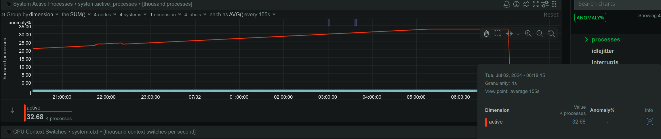

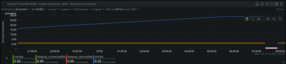

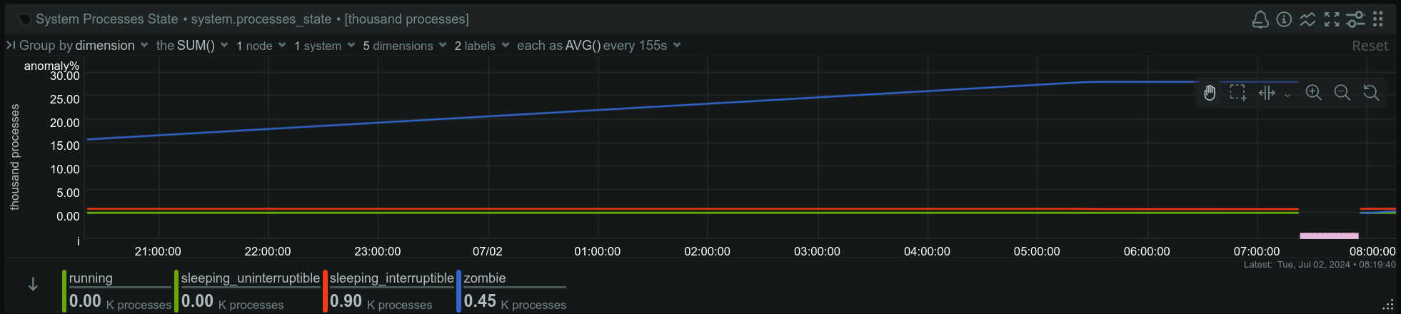

  4. Ok, I think that I have it figured out..... It ran perfectly fine for over a week in safe mode with docker and VM's disabled. Then I rebooted not in safe mode, but still with docker and VM's disabled. Still was perfectly fine for days. Then I turn on docker and it crashes within 24 hours. Ok... so there's a problem somewhere involving docker. I don't see much in the logs once again. But I did look through Netdata to find any interesting graphs. The one the jumps out at me is number of processes. I see a steadily increasing number of processes. More interestingly still, they're zombie processes. Ok, so I look for zombie processes on the terminal, and I see an ever increasing number of defunct ffmpeg processes. And the parent process? A Shinobi script. That's what's happening, I think. I moved into my new home weeks ago, and I set everything up... EXCEPT for my security cameras. They're still not hooked up. Shinobi is trying to get a camera feed and can't, and it seems to be causing an endless loop of defunct ffmpeg processes, for whatever reason. Maybe I should report this as a Shinobi defect, as well. Still I need to wait and see if I have the stability that I'm expecting on the server because I literally only just found this.... but it seems very likely I got it! Really appreciate the help in steering me to the right direction.
