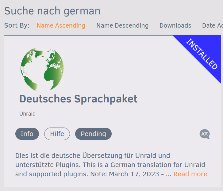

2) Community Apps stuck
For some unknown reason, the CA plugin tells me, the german language pack was "pending".
No Idea what this means, its stuck. I was able to delete the pack from the "OS language" page, no change. I reinstalled it from the "OS language" page, as you can see, still "pending" (and no other action is possible).
How can I "unlock" this plugin  for CA???
Solved by Squid
What other plugins did you try to install?
"Pending" comes from the underlying plugin system and means that another plugin has not finished installing (or there's a bug in the system).
To clear it out, as you won't be able to handle any plugin related operation you need to either reboot or
rm /tmp/plugins/pluginPending/*
Tnx! that rm did the job, it now shows as installed as it should. Still no idea how and why it get stuck at "pending", I remember there was an update for it last week, looks like it never made it thru completely.

Update: today there was an Update to the language pack again, and, guess what? its now stuck and pending again (yeah, now I know what to delete, but there is something wrong with the pack and somebody should investigate).
Install Plugin Applications
language: installing language pack Executing hook script: pre_plugin_checks language: XML file doesn't exist or xml parse error Executing hook script: post_plugin_checks
This was shown onscreen.

2 hours ago, MAM59 said:
it is just that the App Gui thinks
Yeah, I maybe a bit too correct, but:
* the language pack update still gets stuck with "pending" but...
during the last few updates, it happened again, but today I have tried a new "trick" and it seems to work.
Usually I use the "Action Center" from the "App" window, "select all" and let them update.
Doing this will 100% get the German language pack stuck with "pending" state.
But I remebered last week when there was an update for the lang pack only, this worked flawlessly.
So today, I selected "all but the lang pack", did the updates and afterwards selected the lang pack and updated it alone.
And, guess what? it worked.
So I think somebody should check what the difference is between a mass update and a single one...
