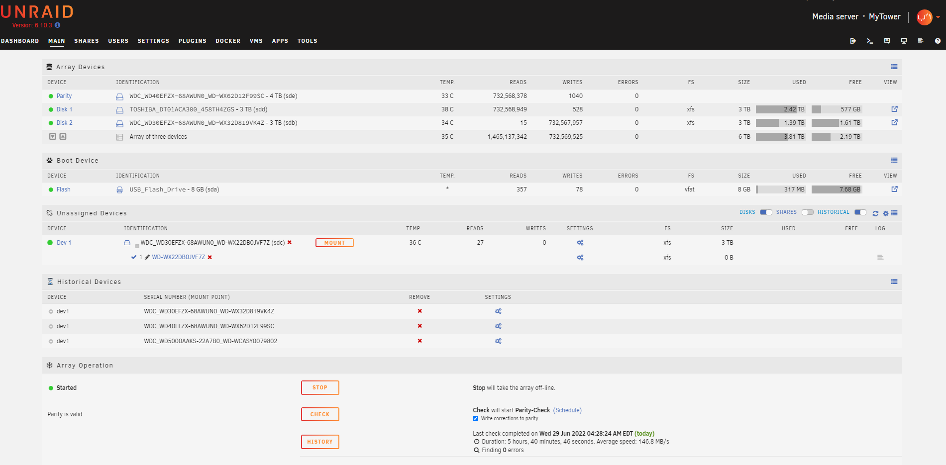

  11. Got the new drive and finished the swap. Everything went as planned. Anything else I should do now? mytower-diagnostics-20220629-0803.zip

  14. Yes. Can I just replace the drive and allow the data to be rebuilt from parity or should I clone the drive to a new one and then add it to the array?
