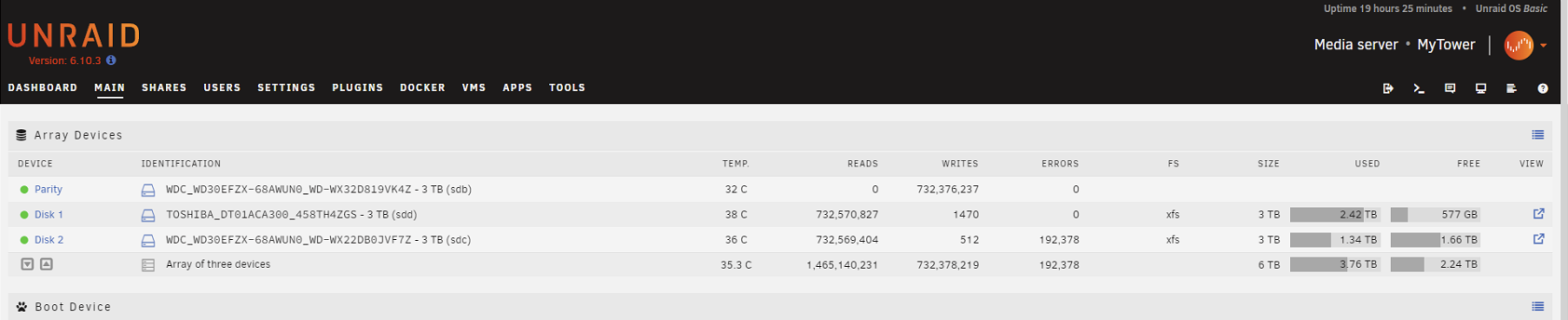

  16. Well, looks like I spoke too soon. There were over 192,000 errors found on the new data disk during the building of the parity. Did I get a bad disk? Do I need to start over? Run a FS check on the data disk?

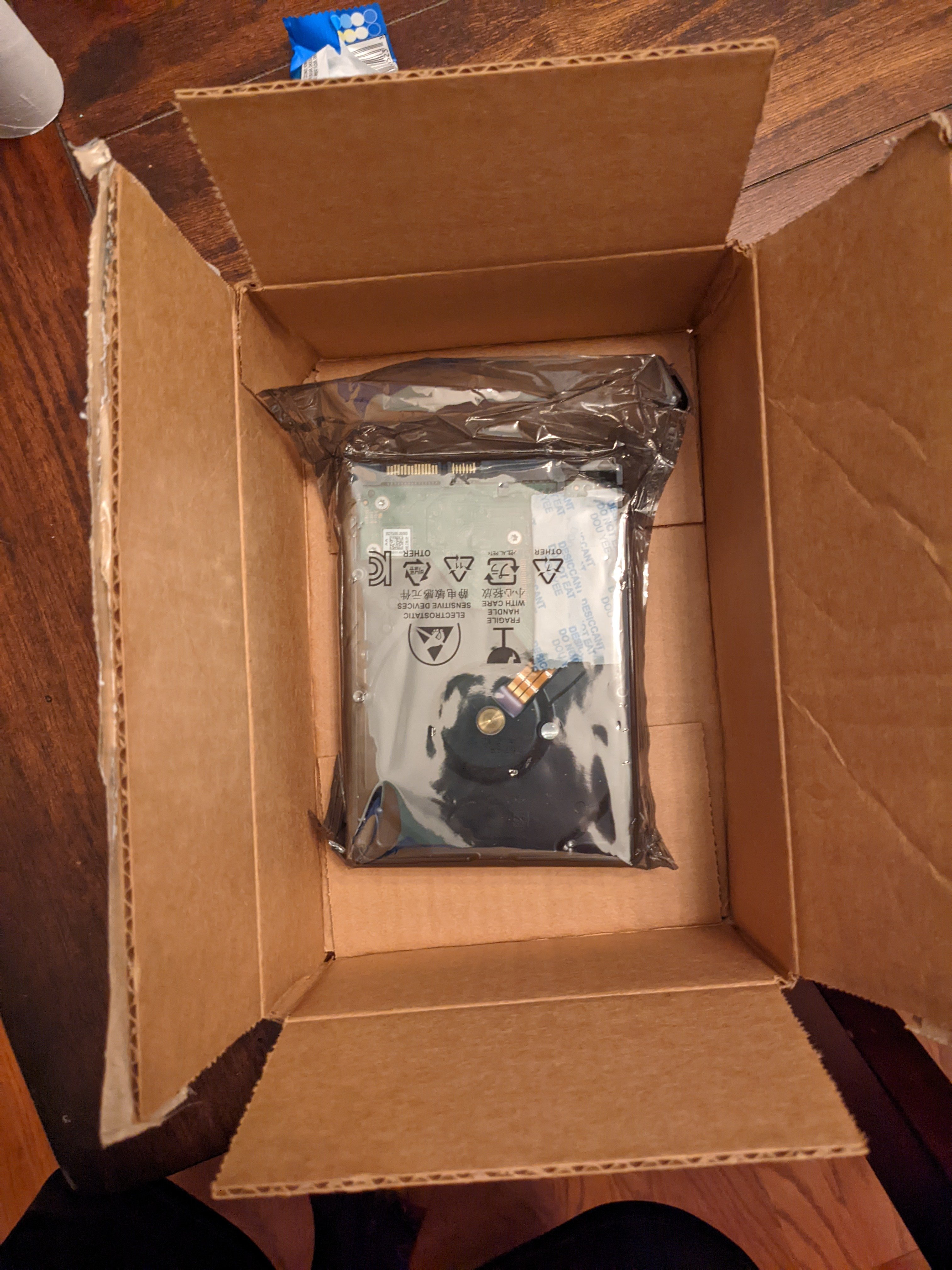

  19. My 2nd hard drive arrived loose in a box with no support. Should I ask for a replacement? That thing could have bounced all over in that box.

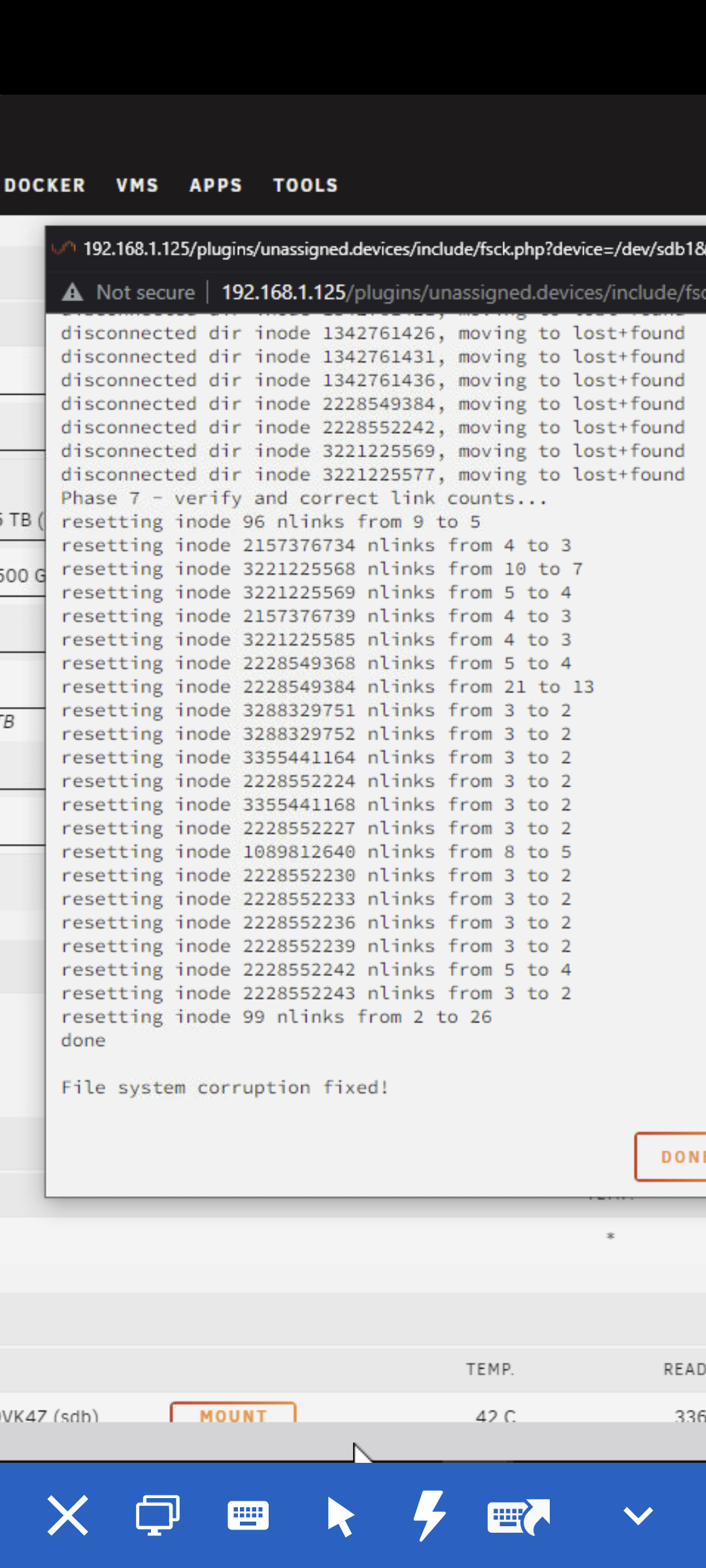

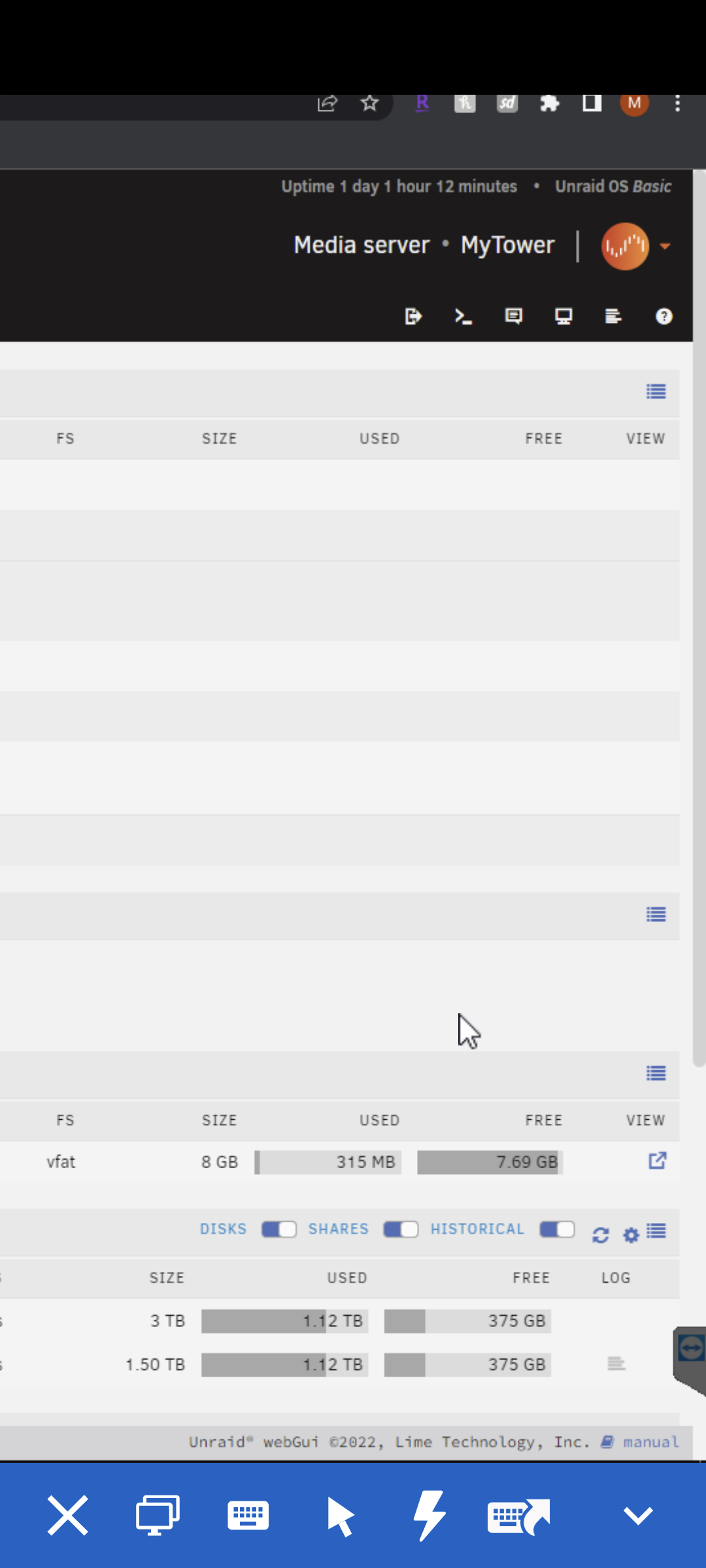

  23. It mounted! Screenshot shows 1.2TB on the drive.
  24. Ok. What next? See if it mounts?

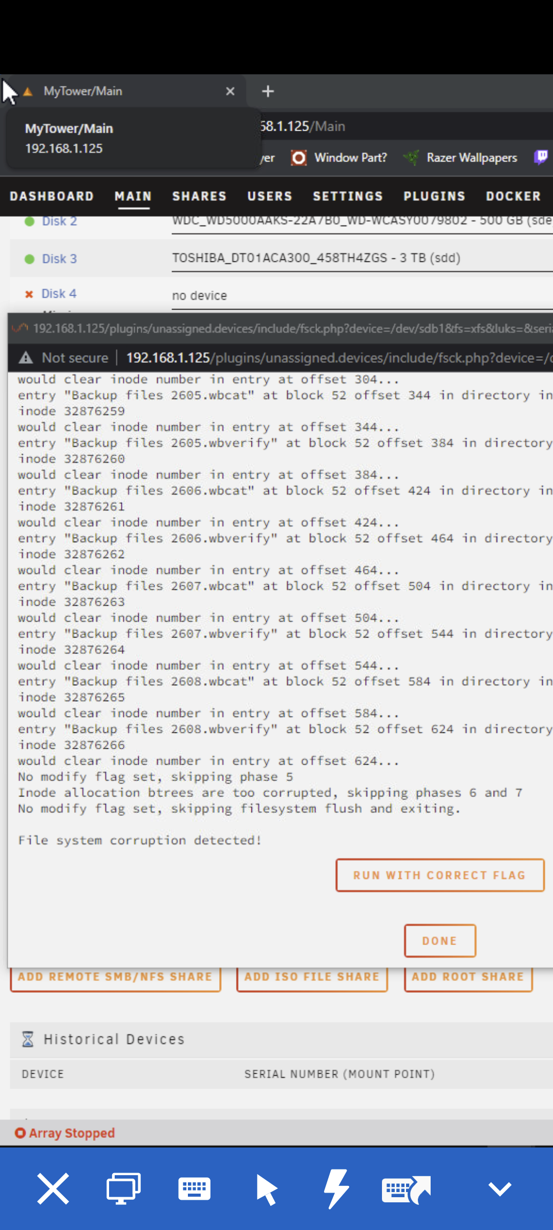

  25. Tried to take a screenshot remotely. Not the best but here's the result.
