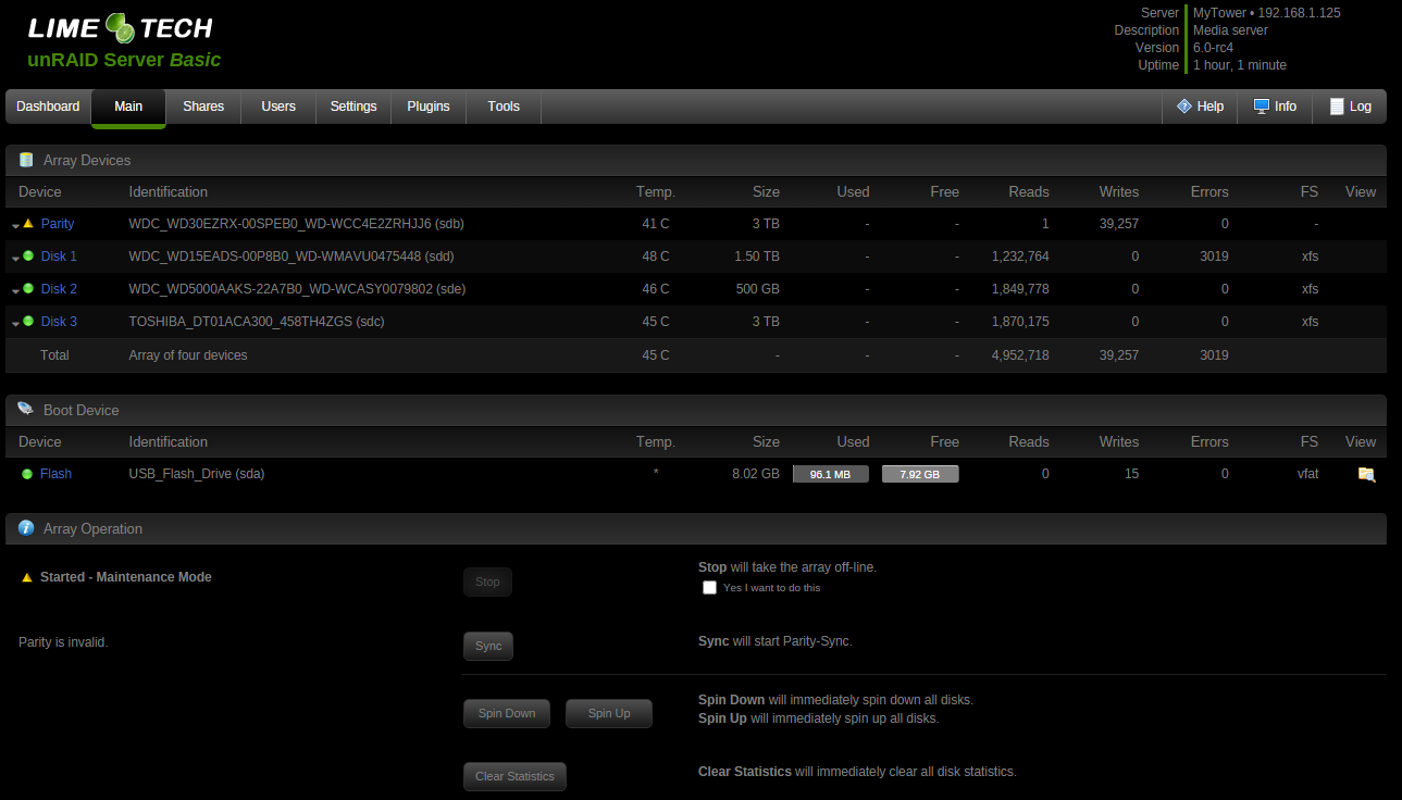

I have a small server running unRAID 6.0 rc4. I have a 3TB WD drive for parity and 3 data drives. This morning I tried to save a file to the server but couldn't access it. I went to the webgui where I encountered an invalid parity. I shut the system down to check cables and such. When I brought the system back up I noticed it took a lot longer than usual and saw some errors for one of my data drives during boot. When the webgui finally appeared it said the data drive was unmounted and parity invalid. I shut the system down again and reseated all cables to all the drives. During the boot process I noted similar errors and a longer time to boot. I decided to check the disk in maintenance mode and it says the superblock read failed, fatal error -- Input/output error. I also still have an invalid parity. So what should I do next? Is there any other info I need to provide? I have attached a screenshot of the main tab.

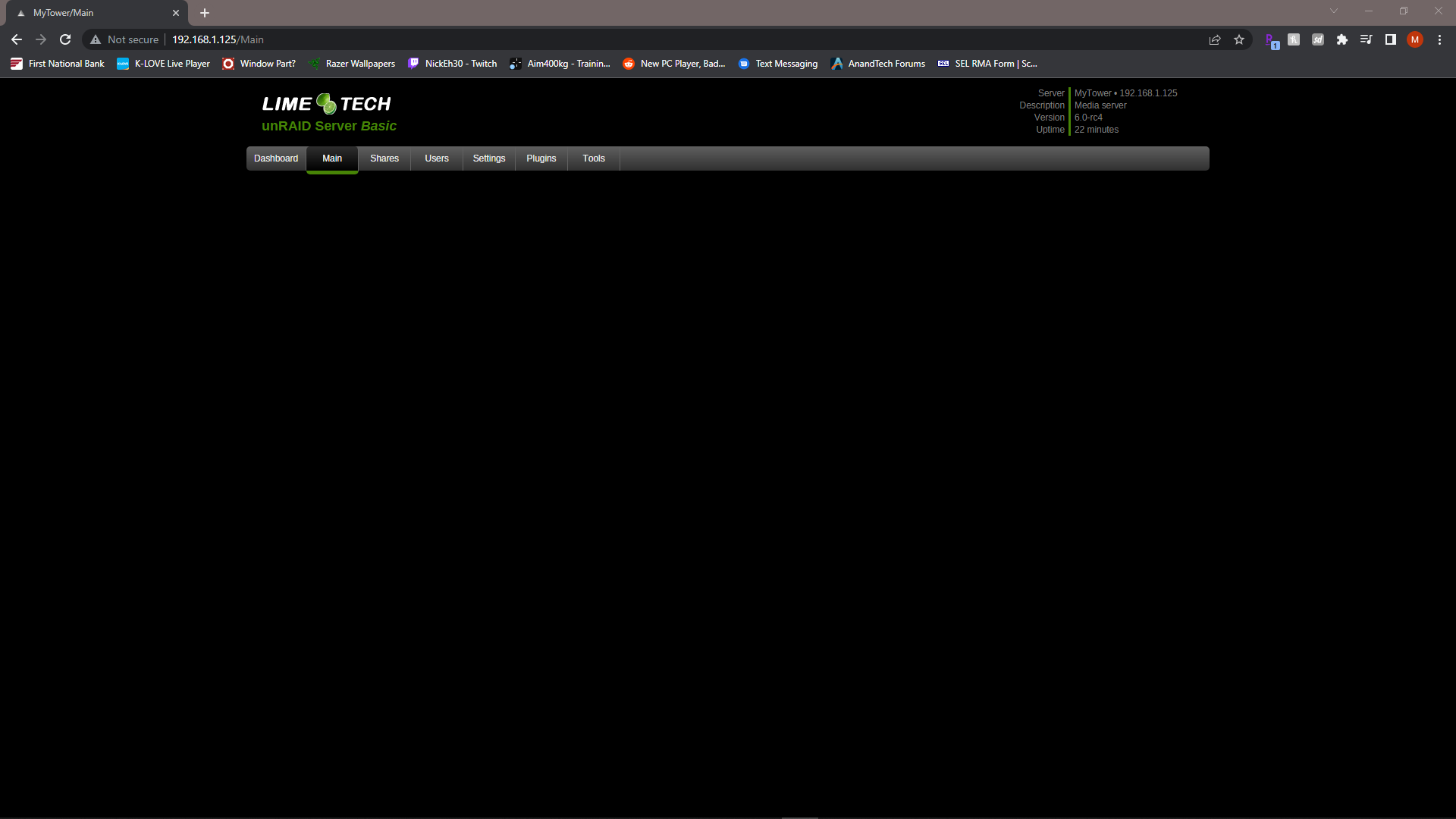

OK. I ordered 2 new drives that should be here later today. But now I have another problem. I went to the plugins page to check for updates. And now the web gui is completely blank except for the tabs. Doesn't matter what I click on I get no info below the tabs. I tried rebooting, but the same thing occurs.

XFS is the file system. See screenshot from earlier.

Screenshot shows them mounted as XFS. Diagnostics from that old version inconclusive regarding whether they were mountable.
On second thought, maybe the screenshot doesn't show them mounted. There is no used or free space for any.
Another disadvantage of running such an old version. Nobody remembers what it is supposed to look like.
And it shows reading all data disks and writing parity, just as you would expect from parity rebuild, but of course it would do that regardless of whether they were mountable since parity doesn't know about filesystems.
