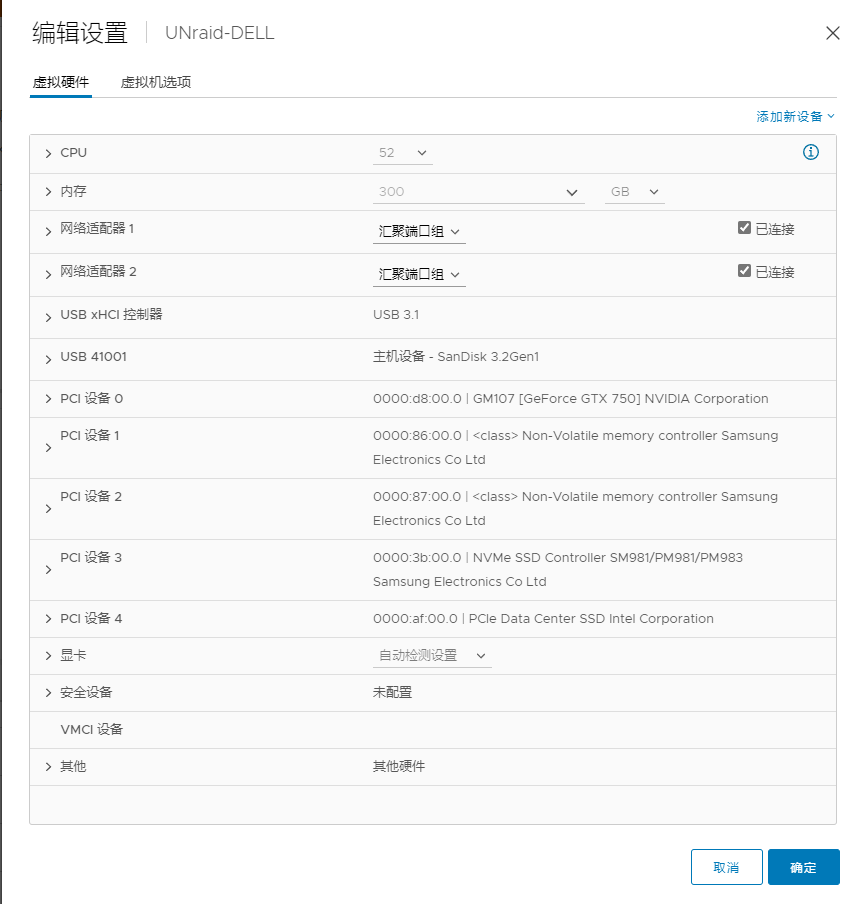

  3. grateful! blacklist-nouveau.conf is a shielded driver that comes with esxi. nvidia.conf is to set the PCI passthrough as the first choice. After a few days of testing, I found out that this is not an esxi problem. It is not a question of whether to add parameters. I guess this should be some kind of limitation made by the nvidia driver, I don't know how to use unraid to compile and install the driver, so I used esxi to virtualize a debian11, kernel 5.10.0-22-amd64, I downloaded countless nvidia drivers to compile and install for the kernel, and found the minimum version that can be used normally It's 470.82.01. Excuse me, is it possible to compile a 470.82.01 driver for our group of esxi users? If not, is my only solution to fallback to unraid_6.9.2?

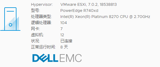

  6. After updating from rtx750 to 1660s, it cannot be driven normally, and it cannot work after reinstalling or using a new system. My unraid work has been under esxi for two years. I have always used rtx750 for emby, and now I can no longer drive it after updating to 1660s, nvidia-smi crashes directly, and the command freezes. It is also impossible to output the report, because nvidia-smi cannot output it.
