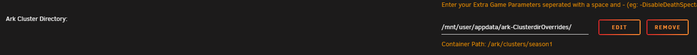

  2. @ich777 just to let you know, I successfully got a modded, clustered ASA up and running! I have a few requests/observations to hopefully make it easier for other users to get it spun up. And with less questions about it posted here 😁 The Game.ini file is not automatically generated inside the same folder as GameUserSettings.ini(Default Location is /mnt/user/appdata/YourArkContainter/ShooterGame/Saved/Config/WindowsServer). This file is pretty important if you want to fine-tune your server's settings. If the file is manually put there, the server will see it(After some tweaking which I will cover below), but it would be nice if it was automatically generated. I have read that sometimes this is just the Ark Server files being clunky but just thought I would bring it up. Port 7777 is the default port for the servers, but it seems like the UDP variable has to be deleted and readded with the different port number for it to actually update to the new port number. Could this be something I am doing wrong? Is there a way to add a separate line for the Mods list? With it being in Extra Game Params, it can be difficult to edit with a long modlist on one line with all the other params. All the server is looking for is -mods= and then the modIDs. Maybe it could be made easier by allowing a copy-paste list in a variable or have it look for a txt file that has all the modIDs. Spit-balling here, but I think the main thing is just making it easier. It works now, but having a dedicated variable in the container might help people. Having some built-in logic for Clustering would be awesome. For Clusters to work you have to have the -clusterid= and the -ClusterDirOverride= variables in the extragame parameters. But what you also have to do is set up a volume map from the container to a folder location on your Unraid server(assuming you're running multiple containers on one machine). Then you have to set the volume-map inside the container as the variable for the ClusterDirOverride. (For Example: /ark/clusers --> /mnt/user/appdata/Clusterdirectories, but the variable on the start line would be -ClusterDirOverride="/ark/clusters"). Since it is just a container volume map, could you add to the template a boolean option to cluster the server or not? Then, if true, check the mapping variable for the user's assigned folder location that the mapping will point to. If the folder is not there the container could generate that folder, assuming PID and GID are left the same in the container variables. Then you could add a variable for the -clusterid that is based on that same boolean value being true. That way those commands are always on the startup line unless the boolean is set to false. Also I don't think if these are clustered together, that it would need a separate steamcmd, but I could be mistaken here. But if I am right, it might save on download time if there was a separate steamcmd directory it could point at and use for all the servers instead of having to download it each time for each server.(I am still learning here so I could have a misunderstanding of how this works) I mentioned that Game.ini and GUS.ini needed some tweaking to get it recognized by the server. What I have noticed(And still don't have a great workaround for) is the container seems to use the previous values of the game.ini and the GUS.ini unless portions of the GUS.ini file are missing at startup. Then it will read the whole file and apply settings. The only way I have figured this out was in trial and error of getting the settings updated. And to further compound the problem, sometimes even doing that process fails to work. My request is can you have the container check and update the server based on the GUS.ini and the Game.ini file every time the server starts? It seems like at the moment it is not working reliably. That's all I have for now. If you could make those updates, I could write out a workflow for how to get modded clusters up and going. And I might have it wrong on some areas, so let me know if I do. Really enjoying doing this and learning more about how this OS/Container works!
