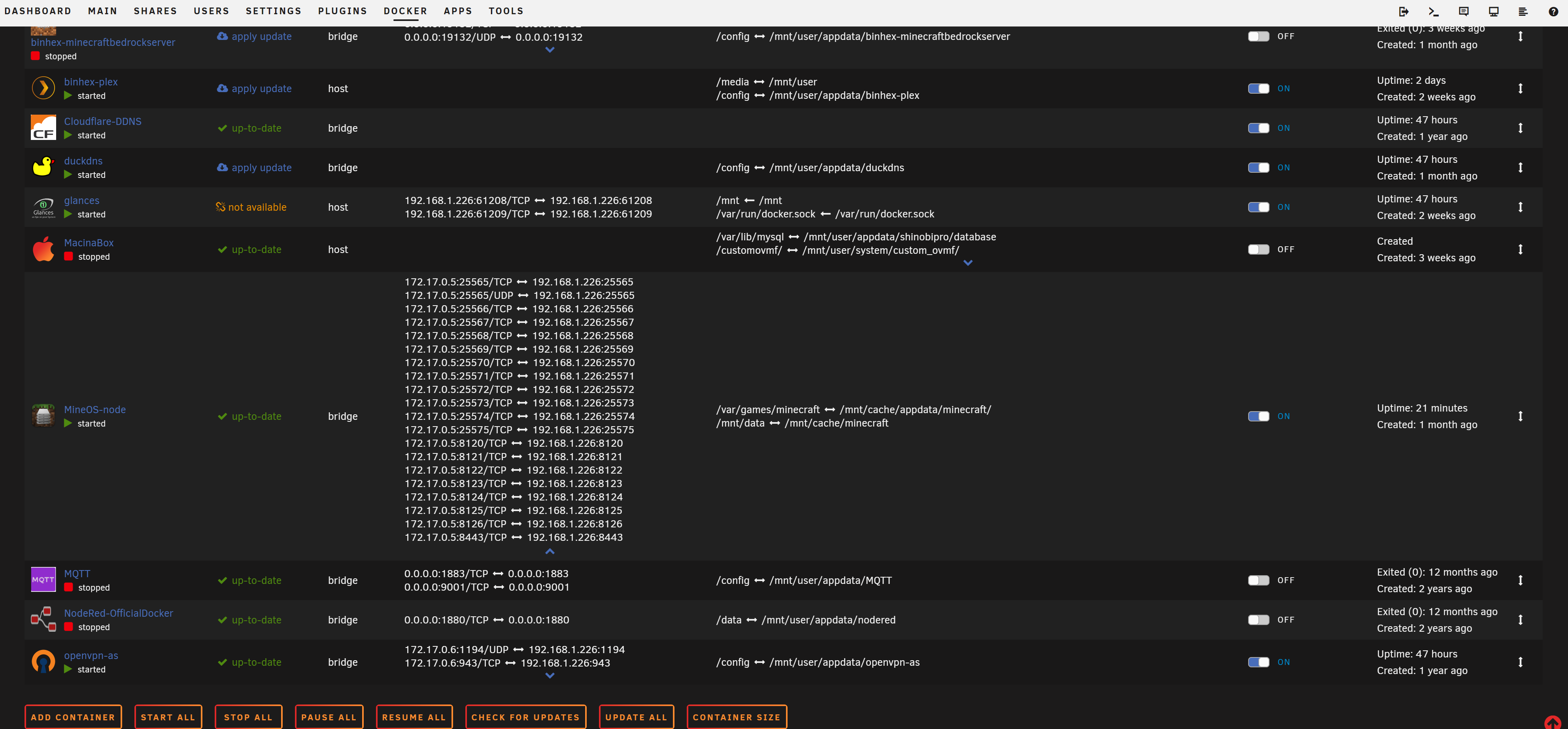

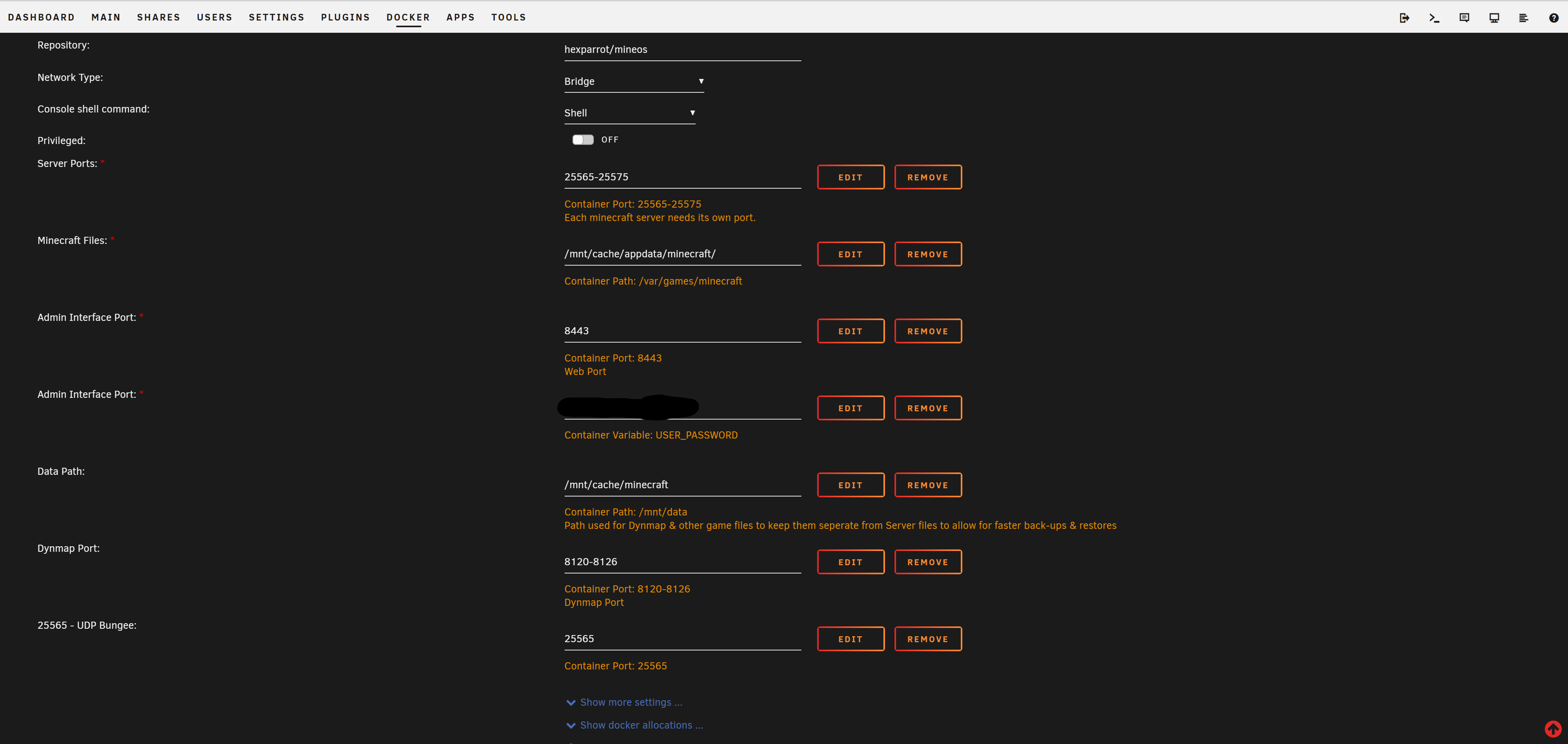

Hi new here. My docker image file is getting full. I check my container sizes and it seems to be my mineos filling it not sure how to fix the issue

I don't use that container. The usual cause of filling docker.img is an application writing to a path that isn't mapped. Other than the mapping for appdata, the only mapped container path is /mnt/data. Is the application writing to a different path?
Thanks. It was and easy fix /mnt/data was mapped wrong. Once I mapped it correctly docker now at 30% and all is good. Thanks again @trurl

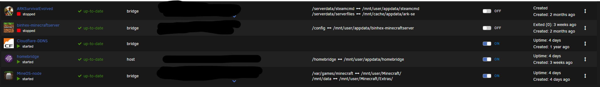

I have this exact same issue, but I am not sure how you fixed it exactly? I see my container path is set to mnt/data but I am not sure where I need to change it to? What did you change yours to?? I can post some pictures if that would help, but the ones you have posted are very similar

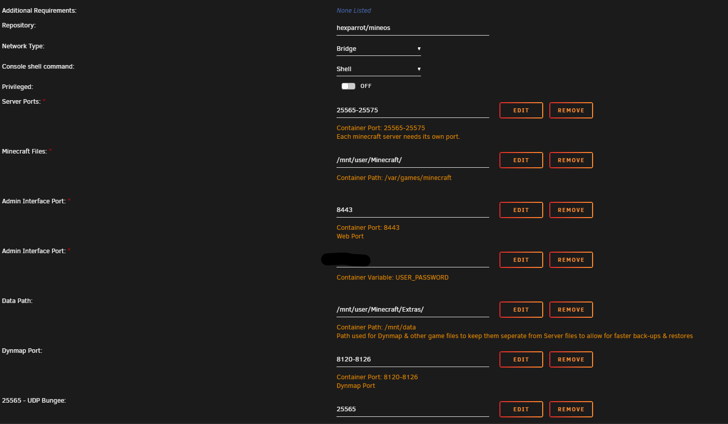

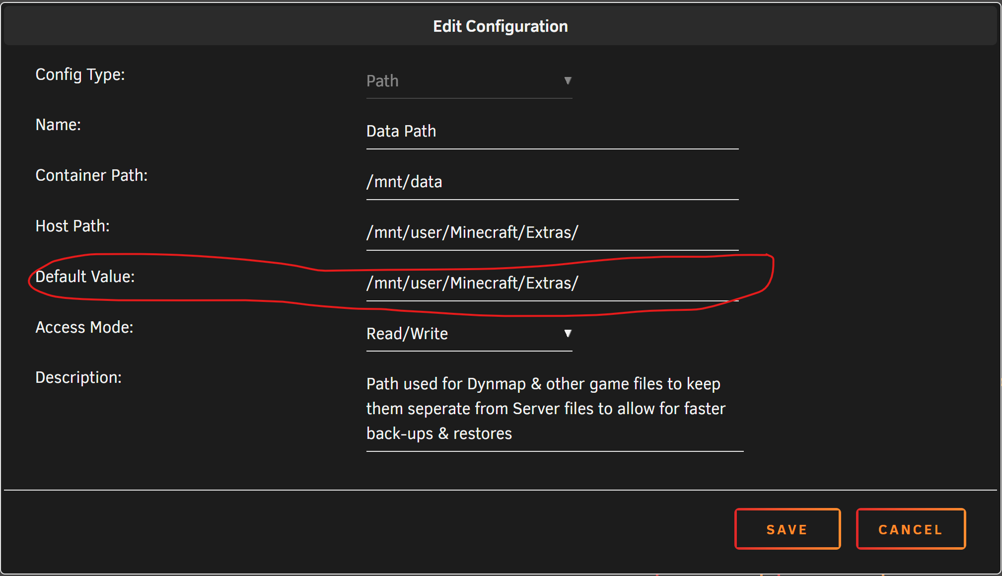

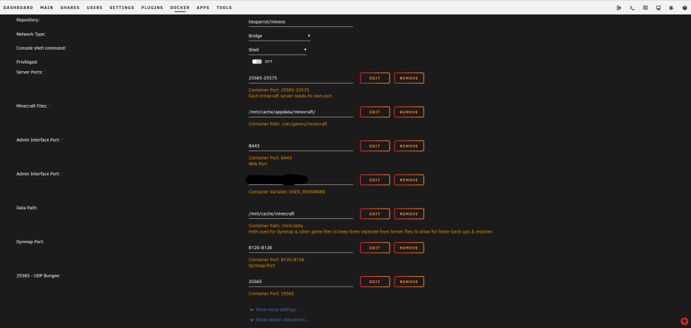

I figured out my issue. It was the default value was set to a share not on the server so it was all going to the docker image. As soon as I swapped it to the correct folder share, it uninstalled and reinstalled then the docker image cleared instantly. Hope this helps someone.

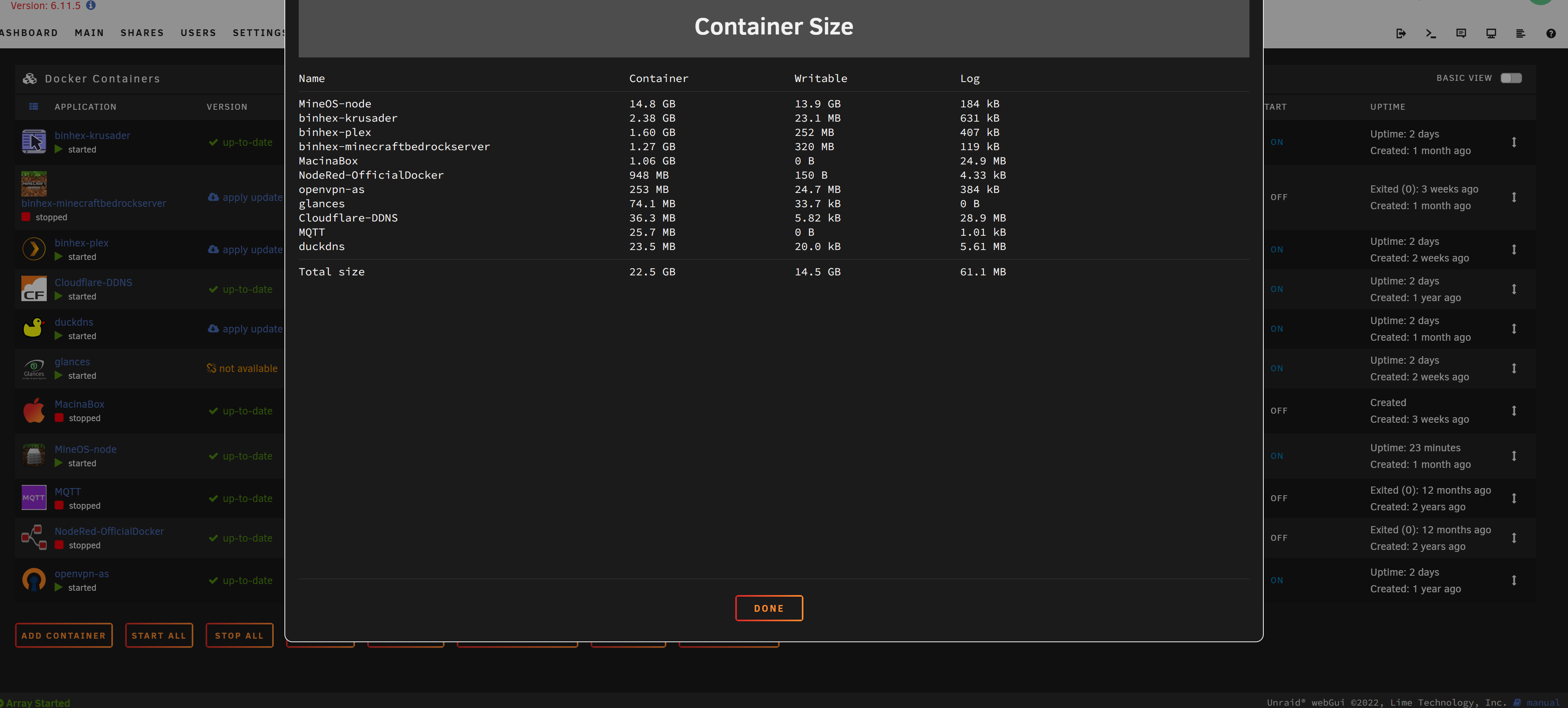

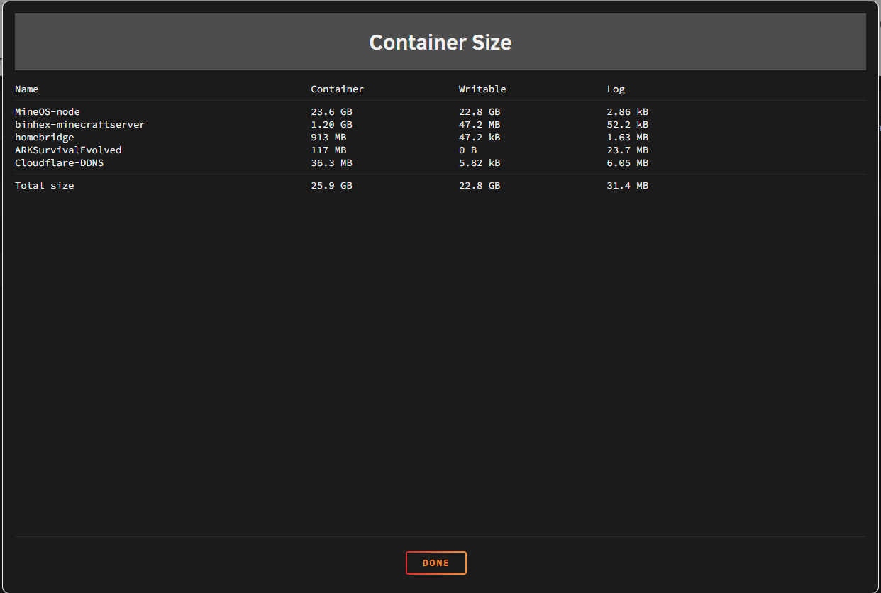

Go to Docker page, click Container Size button at bottom, and post results.

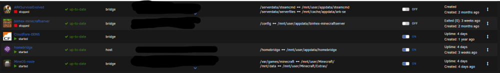

It's still MineOS taking up the space but I have no idea why it keeps filling up if I have the data stored on a dedicated cache drive...
Here is this. Dunno if it will help or not.

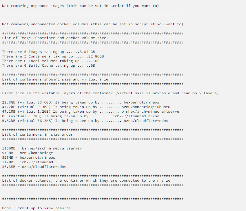

Also wanted to add this. It's a script from a SpaceInvaderOne video that checks for volumes on the docker image. Right now, the only thing I see is the container itself is filling up. But I am not sure why?

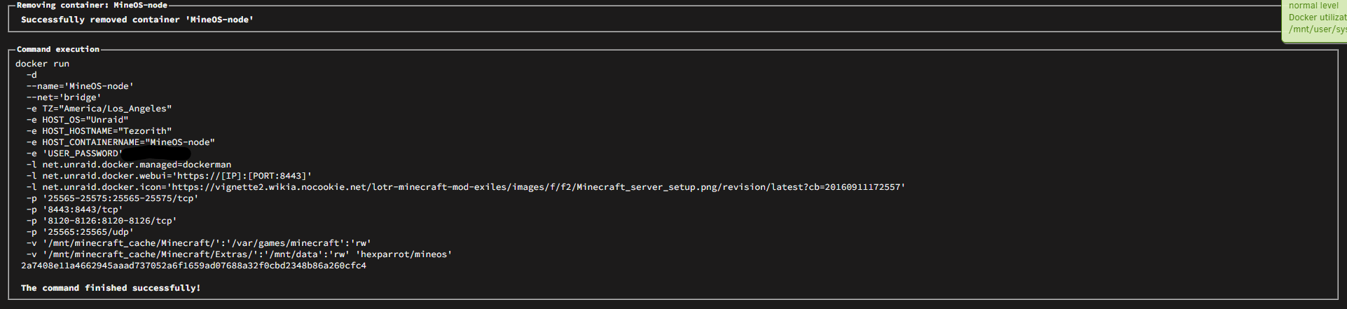

Well I tried updated a Port Range, which caused the docker run command to fail and delete the container. Currently at work so I am not sure of the damage, but when I was remotely installing the container back, I realized that the user folder that was inside the mnt folder wasn't on the cache drive I had selected. Once I went back up and was able to select my cache drive, I believe that fixed it, but I am not sure at what cost. I have backups of my world so it should be ok. I'll report back later tonight.

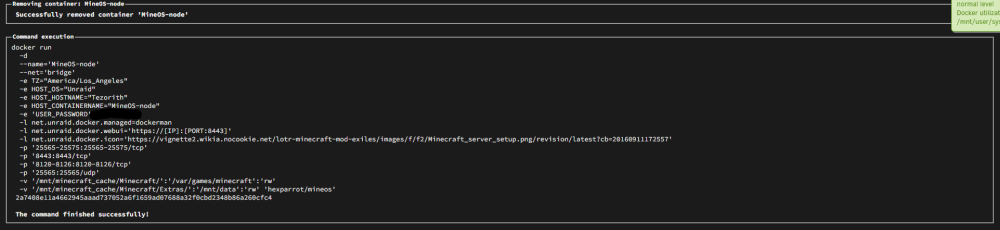

Ok so the docker image is still filling up after a fresh install and correctly mapping the locations. I was able to do a Docker Run like you asked @trurl and I have attached it here. Any chance it's still something I have configured wrong? Any time I update the docker container, it dumps the image. If that helps you at all.
