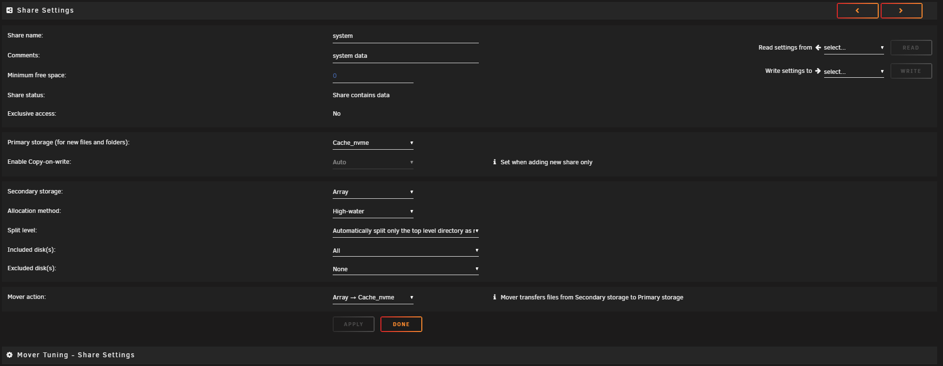

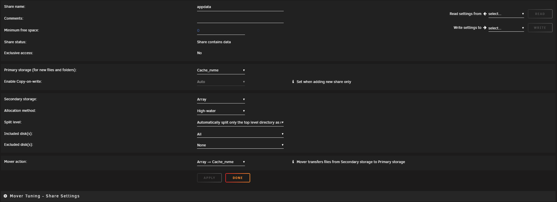

Hello Unraid Forum, I've recently acquired a powerful server after a long time, and I've been struggling to identify the problem. Here are the server specifications: AMD Ryzen 5800x 16 Core 32 GB DDR4 RAM at 3600Hz 1 x 2 TB SSD Disk set as Cache for Data 1 x NVMe SSD set as Cache for Appdata 1 x NVMe set as Cache for Windows Virtual Machine (WM) Additional components: 1 x Nvidia Quadro P400 for Plex transcoding 1 x Nvidia GTX 1060 for Windows Virtual Machine (WM) And these HDDs: Parity: WDC WD80EFAX-68KNBN0_VGG2W4GG - 8 TB (sdg) - 25°C WDC WD80EFAX-68KNBN0_VDJTZNYK - 8 TB (sdb) - 24°C WDC WD80EFAX-68KNBN0_VAJ1M4ZL - 8 TB (sdh) - 22°C TOSHIBA HDWG440_X180A07UFZ0G - 4 TB (sdj) - 15°C TOSHIBA HDWG440_X180A07YFZ0G - 4 TB (sdk) - 12°C WDC WD40EFZX-68AWUN0_WD-WX52DB1ASP92 - 4 TB (sdl) - 14°C WDC WD60EFAX-68SHWN0_WD-WX11D39LFHVL - 6 TB (sdc) - 17°C ST4000VN008-2DR166_ZDH5Z3HE - 4 TB (sdi) - 15°C ST4000VN008-2DR166_ZGY401DB - 4 TB (sde) My boot device is: Flash DataTraveler 3.0 - 31 GB (sda) The problem is that it seems to freeze when updating Docker or when the server is performing certain tasks. It hangs very easily. I'm attaching logs in the hope that someone can identify any major issues. pilsner-diagnostics-20240119-2139.zip

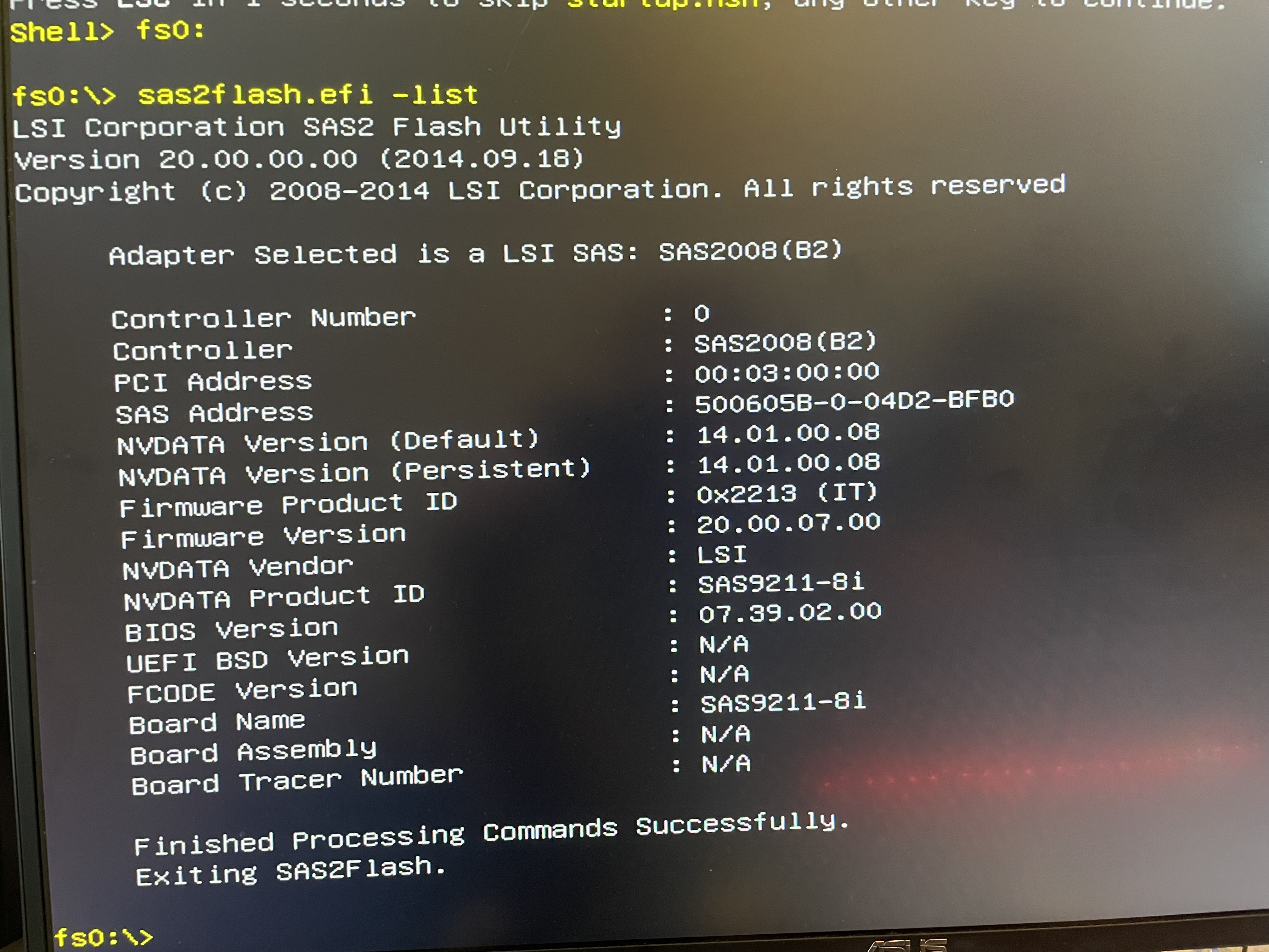

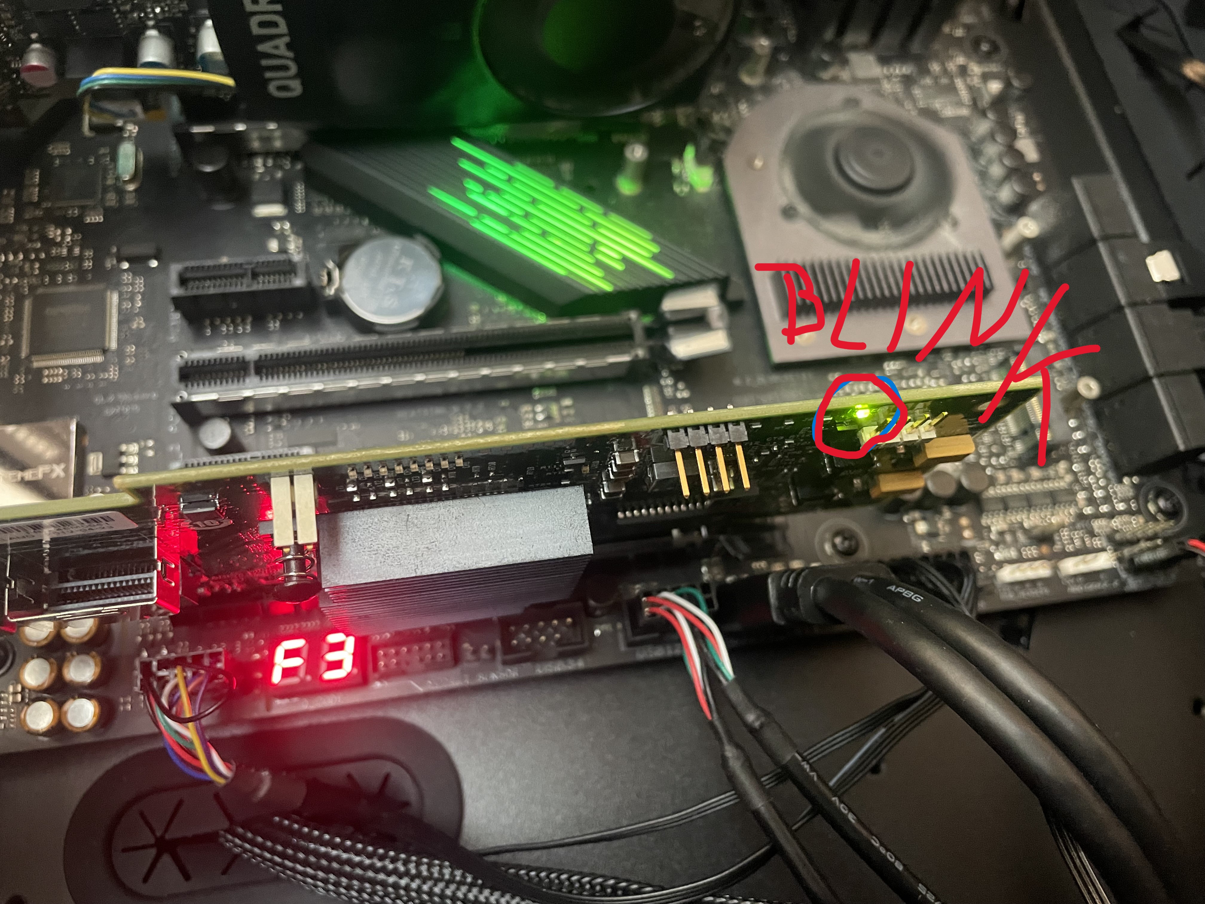

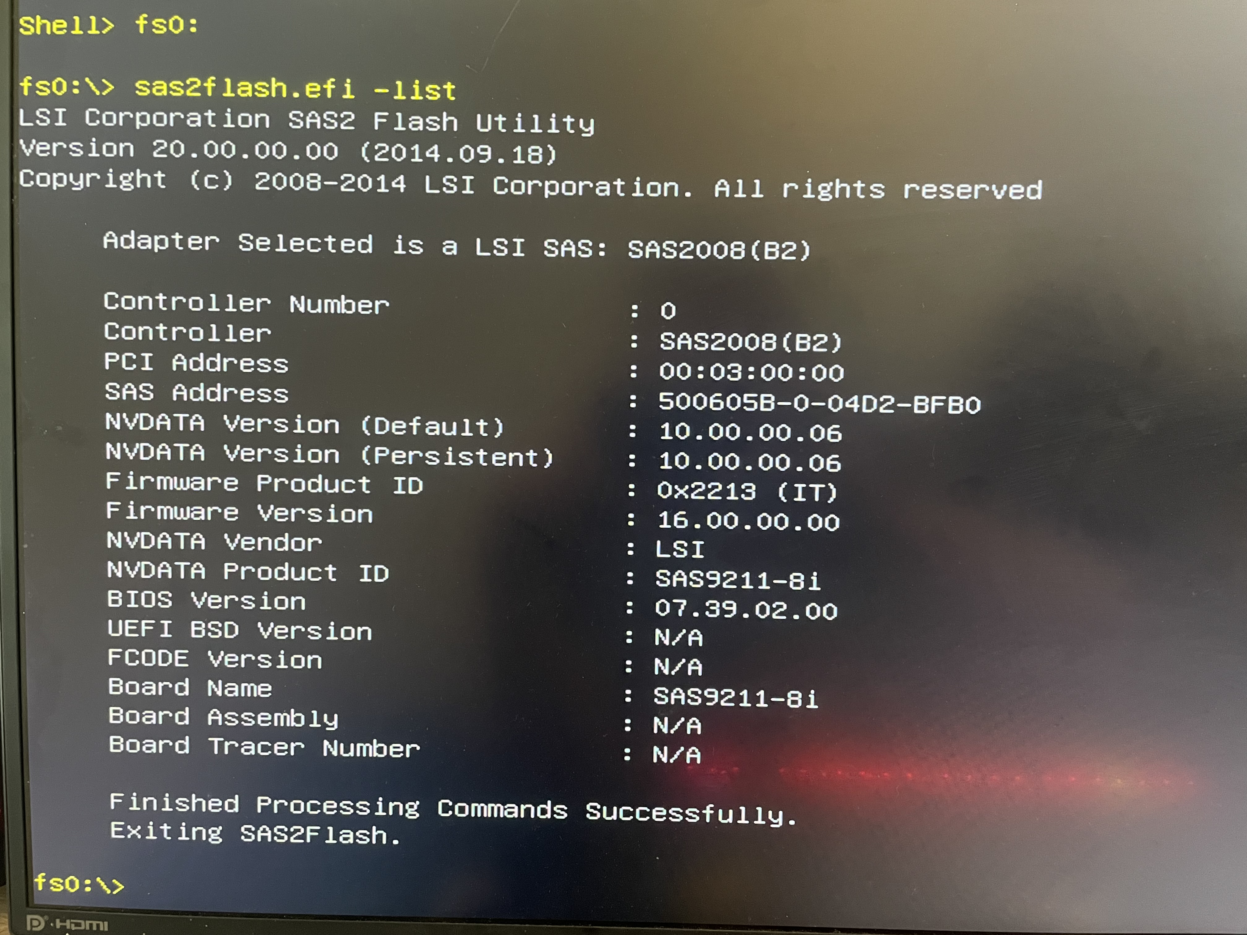

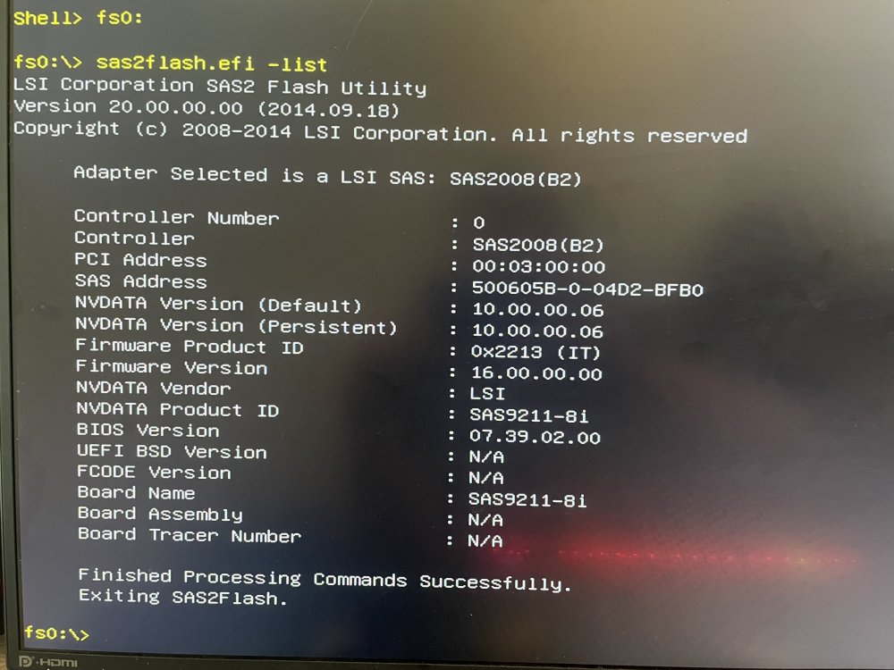

Hello Unraid Forum, You are my last hope now. I have been trying to get this to work without any luck. The first thing I did was to boot from a DOS USB and type the following commands: 1. megarec -writesbr 0 sbrempty.bin 2. megarec -cleanflash 0 Everything worked fine, and the clean was successful. However, when I tried to do the next step: 1. Reboot to DOS (yes, you must reboot) and type 2. sas2flsh -o -f 2118it.bin I encountered an error message: "Failed to initialize PAL." After that, I created an EFI bootable drive, found all the necessary files, and proceeded with the following steps in EFI shell: 1. fs0: (may be different on your machine) 2. dir (to verify you are on the correct USB stick!) 3. sas2flash -o -f 2118it.bin -b mptsas2.rom 4. sas2flash -o -sasadd <500605B0xxxxxxxx> In EFI, it seemed to load the necessary files correctly, and when I use sas2flash.efi -list, it even shows 0x2213 (IT), which seems promising. Now to the problem: I can't see the drives that are connected to the card. I have a green blinking light at the back of the card (see picture 2). I am not getting the prompt to press Ctrl+C to enter its BIOS... I am totally lost now. Where should I start? Do I need to enable something in the BIOS to get the card to work? My motherboard is Asus Strix 570x E Gaming. I'm not even sure if the files I used in the EFI folder and DOS folder are correct. I will also attach them. If somebody has a complete set of files, I would love to have them so I can make it work. dos.zip efi.zip

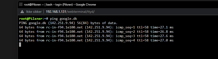

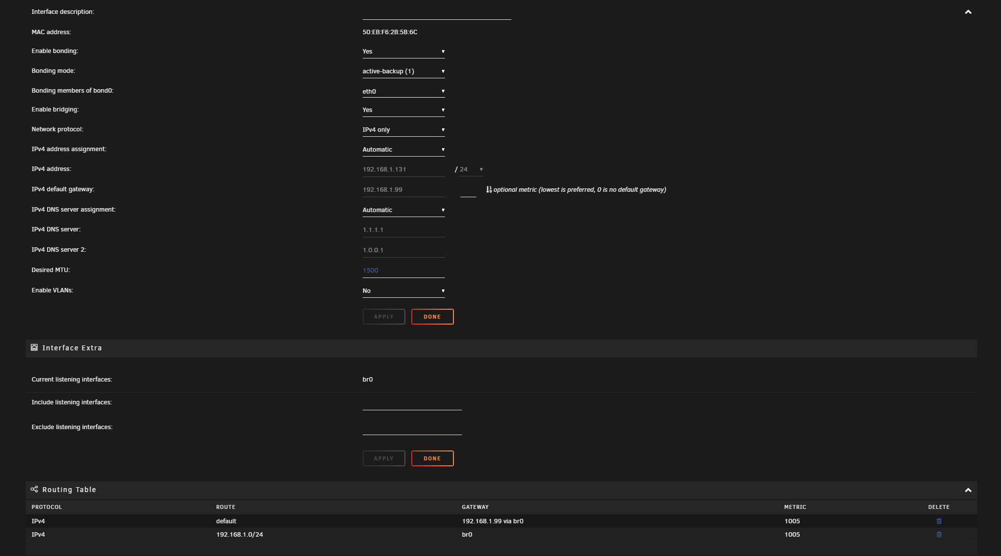

Hello Unraid Forum Got this problem with community applications, Network,,, plugin: installing: community.applications.plg Executing hook script: pre_plugin_checks plugin: downloading: community.applications.plg ... plugin: community.applications.plg download failure: SSL verification failure Executing hook script: post_plugin_checks I'm able to Ping google from console : ping google.dk and i get Reply ? i did try to delete network.cfg also still no internet on the server- Controller Question

Found the problem. it did make the network to bridge insted of host. -.-' u always find the solution afther making a forum post :I- Execution error Server error
