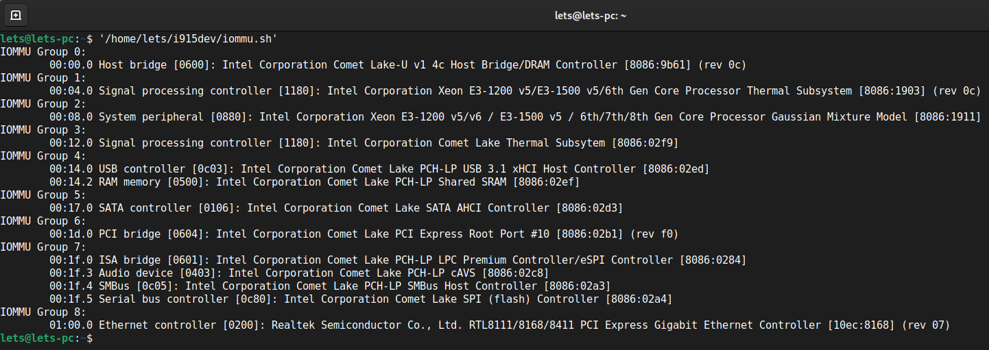

  1. As can be seen on the screenshot, iGPU(which is 00:02:0) does not belong to any IOMMU group. I need it in a group to try VM passthrough. Any idea why or how to fix it?
