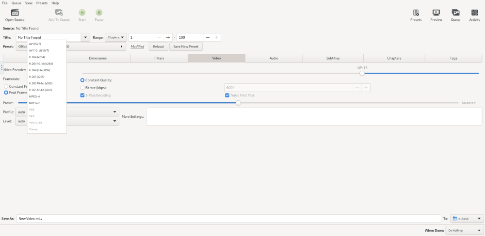

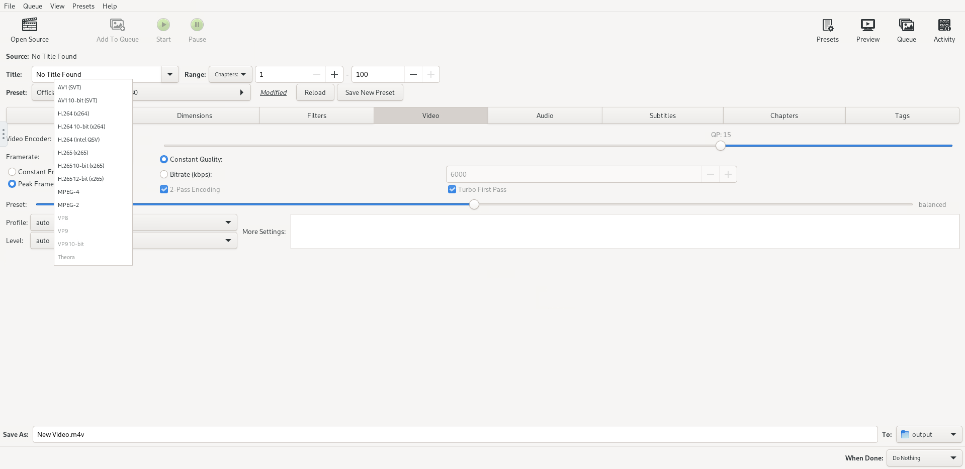

  4. Hey, I don't know if you can help me with this, but I'll try anyways. I want to run the Handbrake Container from jlesage (you can see my settings in the screenshot) to convert movies to H.265 using the iGPU. I'm running a self built system with an i3 12100. Everything on my system works fine, only Handbrake doesn't show the option for H.265 (QSV). However H.264 (QSV) works just fine, which means that the container can access the iGPU. I've already asked jlesage for help by starting an issue on github. https://github.com/jlesage/docker-handbrake/issues/265 She said that the container doesn't seem to detect the hardware properly, but she doesn't seem to know a solution. I've seen a Reddit thread where someone said that updating their graphics driver fixed a similar issue for them. Since the closest I have to a graphics driver is your Intel GPU-TOP Plugin, and because I'm quite desperate to get this working, I'm asking if you have any advice - even though I know you're probably not responsible for this. qserver-diagnostics-20230630-1439.zip
