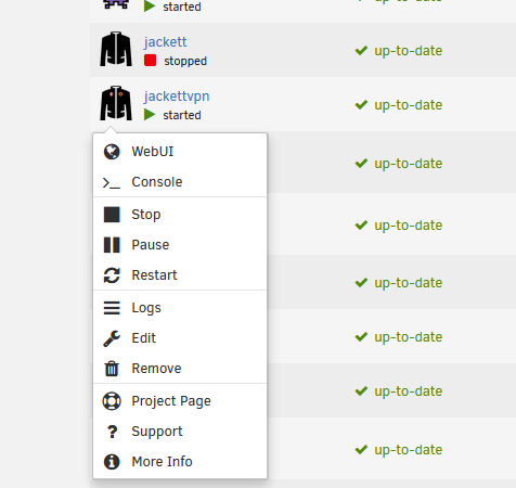

  4. My file browser is fine, maybe I was not clear enough. So let me rephrase. 1. After installation I have run the docker with wg off, it started normally, log file was created and filled with usual stuff. 2. I have copied the wg0.conf file to wireguard directory. Enabled wireguard in docker config. 3. The docker starts, shows up as running, but every attempt to click on logs or console here: [picture attached] the pop up windows immediately disappears. When I click on the "Logs" button at the right time, the window shows a ton of quickly scrolling text (like linux boot) and then immediately closes. 4. The log file jackettvpn created in step one is not updated, the file modification time does not change and nothing is being added. Therefore it is difficult for me to diagnose. Is there any way to make the docker not restart (I did follow the Dyon's instruction from a few posts up) or to force it to log everything somewhere, so I can actually find out what's wrong with it? Thanks
  5. I'm also unable to get it to work. After enabling wireguard, the log file is not updated anything, the log and console windows disappear immediately. I have tried the wg0.conf file on another machine, works flawlessly. I can't even tell you anything more as there is nothing in the logs...
