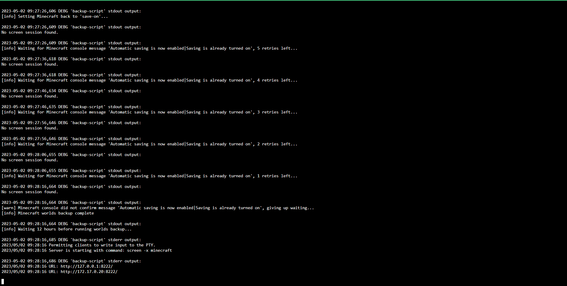

  4. I have been having an issue with disconnections on the server. Whenever the server has been idle for an extended amount of time nobody can connect to the server and the webui is detached. I have attached the logs for the docker container and the error I get when trying to connect to the webui. Everything works fine after a restart but then that defeats the purpose of an always running server if I have to keep restarting it. I also like this version of the minecraft server because of the automatic backups.

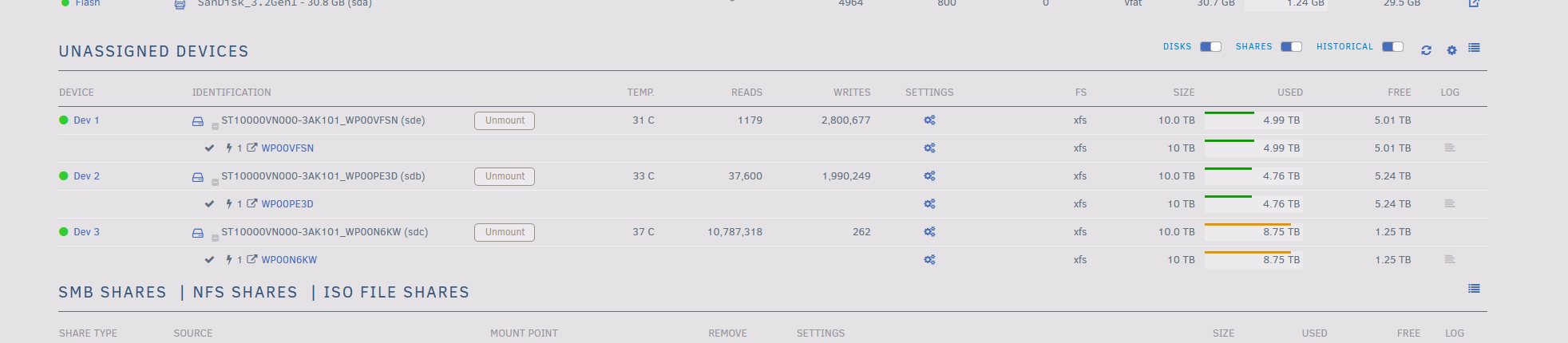

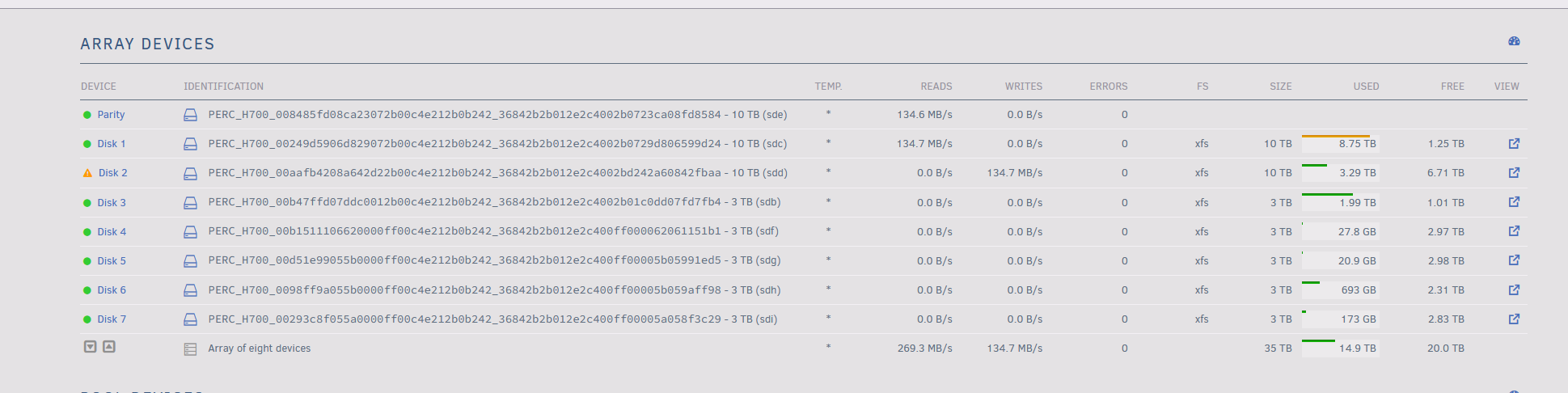

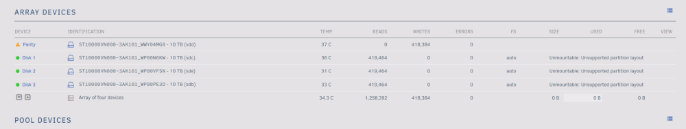

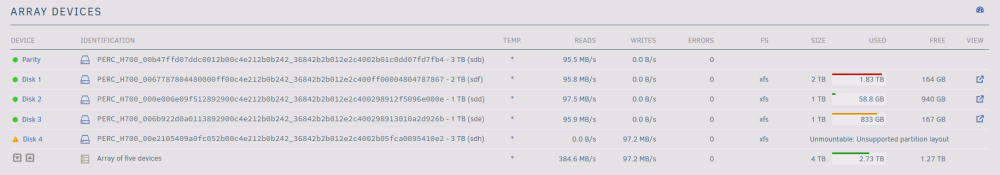

  6. I am currently moving to a new server for unraid, I am moving from a Dell T610 to a consumer pc I built but I am having issues with the hard drives. Because the Dell T610 had a PERC H700 raid controller the names of the hard drives were all over the place and weren't the ID of the actual drive, instead it was of the raid pool, of which I just made a raid 0 for each individual drive. You can see this in the image below. I am only taking the 10TB drives with me, the parity is also a 10TB Seagate Ironwolf (there is also an additional 10TB drive which I have put in and transferred all the data from the old 3TBs over, this screenshot was taken before that). I have moved the drives over to the new server, same USB boot drive, but as I am plugging the drives straight into the motherboard now their serial number can be used as the ID, and unraid was confused, so I created a new config to put the drives in order, the same parity drive was used in order to ensure I keep my data intact. However I now get "unmountable: unsupported partition layout" on the drives now. They have been confirmed to work on unraid before with no issues so I am confused as to why it won't mount. I have tried an xfs_repair through the GUI as per unraids guide and it did something, but it didn't fix it. I can also mount the drives through unassigned drives and I can see all my data is there. I was thinking of formatting each drive individually and move the data around but 1 move of the data will take 2 days at best, so that is a last case scenario. I don't want to have to download >10TB worth of movies and tv shows again. My diags are attached as well. If anyone can help me that would be greatly appreciated Old Setup on Dell T610 Drives can be mounted through unassigned devices and data is intact Error I am having manticore-diagnostics-20230422-0944.zip Edit: I just tried another xfs_repair on one of the drives and it says it has a bad primary superblock and now it is trying to find a secondary superblock Edit: I got this during the xfs_repair: "..found candidate secondary superblock... unable to verify superblock, continuing...". Not sure if this is normal or not
