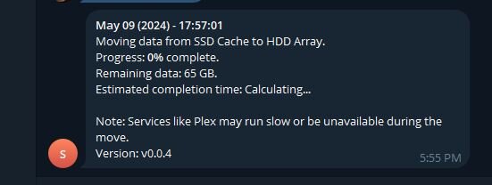

Hi there, Sorry for the delays, I've been rather busy. I've installed the script in its final state on my Unraid 6.12.10 about 3-4 days ago. So far, the script works exactly as intended on multiple consecutive file transfers! Outstanding work my friend, thank you! You should definitely talk about this script and make it go wide - one of the better more useful features I'd been asking for on Unraid. Thanks again!

Completed without a hitch. Great work! If you can get this script constantly running, it'll be incredible. EDIT: Whoa snap! It DOES work on a loop! Congrats! I'm sold!

Great work amigo. For the moment, I'm getting response from DRY_RUN and from running the standard script while Mover is running. So far so good. I left INCREMENT at 25 to see how well that part works, and I did get a notification at 0% which is great. You could package and sell this with Unraid, it's just that excellent. Keep you posted on the whole move!

So far I've been able to insert the new script with my credentials. I left it at 25% increments. Would be a teensy tiny bit interesting to have a "Mover starting (0% completed)" message... just so we know it's actually started. I'll let you know once I get to 25% completed.

Well, I can also modify the script for myself, but if you're interested in making this available to a wider audience, yes I would think it'd be interesting to add the option. Even switching between "time" or "percentage" would be a great add. I understand. I'm in the process of transferring over 6TB but my cache drive is only 120GB... so that becomes many MANY Mover jobs 😂But I don't mind restarting it manually. It's just that if you make it a continuously running script, then frequency does need to be adjusted -- I'm getting notifications every 45 seconds or so and my arm is numb from the vibration of my Apple Watch 😂 Great Idea to be able to toggle between Telegram and Discord. If you ever want to make this a bit more interesting, perhaps there is a way to have the system generate its own notification, and that would send it through whichever Webhook is already configured for the user. I've chosen Telegram, but there's at least 10 different options to Unraid notifications... Maybe there's an easier way? If you need some testing or other feedback, I'm your man. I apologize as I'm not much of a programmer. I tinker, but not much else. Thank you for your very interesting work! I appreciate your effort!

Yes it does. However, I view this as a bit of an annoyance, because it's not on a parametered setting. Think there's a way to get updates every 25%? Also, and this may just be me not knowing how to setup user scripts to permanently run, after Mover stopped, the script stopped. The next usage of Mover did not send any notifications. Which I would totally prefer on a forever basis... as long as there's a way to set notifications every x %. Otherwise, this is actually draining my Apple Watch battery!
