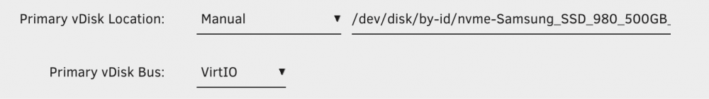

  2. @casperse - Short answer is "yes". I was able to pass the NVMEs thru another way and get pretty good performance. I'm not sure what this method is called. It looks like passing thru the raw partitions but it's really the root above the partitions. Using the VirtIO driver yields fast speeds at the expense of CPU cycles. Nice thing about Epyc is that we've got enough cores to afford it. (screenshot attached) I will continue to tinker with passing the bare-metal NVMe thru. I have not been able to pass the bare-metal NVMe controller thru without severe crashes. I was trying to bind them to VFIO and pass them thru like a GPU. I feel like this is an issue with the motherboard or BIOS. Before this board, I was trying to use Supermicro's equivalent. I was able to pass the bare-metal NVMes on the SuperMicro but had to RMA three of them for dead BMCs before getting the AsRockRack ROMED8-2T. The BIOS has a lot of options. It took me a few sessions to get the BIOS dialed in for my workload. It's definitely an enthusiast board. Having said that, I don't think Ryzen 3 requires all the tinkering/optimization that I've read about from Ryzen 1 & 2. I have two of my three GPUs passed thru. I expect the third to work just fine, I just haven't set it up yet. Sometimes I have to disconnect my USB devices to boot after a complete disconnect from power.
