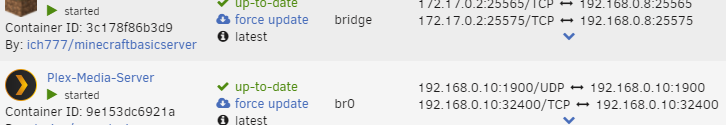

  1. Ahh, okay, that seems to be how plex is getting through. Good to note. I have gotten it to work, it appears the issue was with my changes not updating for port forwarding. Simply needed to restart my equipment. Thanks for your time (also for making all of the containers I see attributed to your name!)
  2. I've attached a screenshot of my router settings for the port forwarding as well as a screenshot of my containers. I included the plex info because I am able to access it externally. I am testing the external access to the minecraft server over a hotspot. Taking a deeper look into my ISP to see if that could be the issue.
  3. Please let me know if this isn't close enough to the topic of this thread. I'm trying to setup a minecraft server from my unraid server. I currently have it accessable locally (LAN) but cannot access it externally (WAN). I've have looked over my port forwarding settings enough to go cross-eyed. My question is, when forwarding a port to a game server on an unraid server is there something unique about that type of port forward? From my router, I'm forwarding port 25565 to 192.168.0.8 (my unraid server). The docker container is setup as Bridge thereby making the port mapping show as 172.17.0.2:25565 <-> 192.168.0.8:25565.
