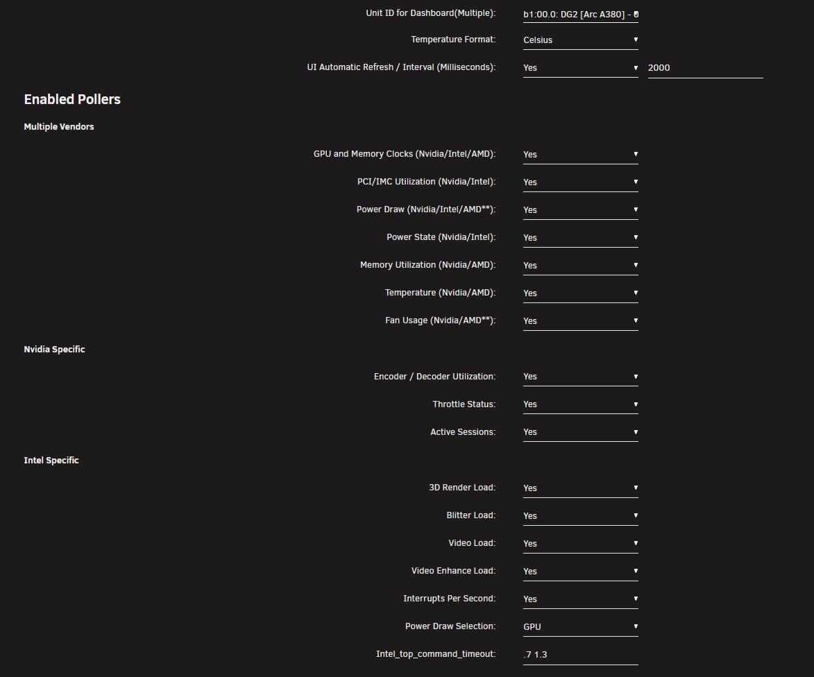

  1. Using this file and a timing of .7 1.3 returns this error
  2. I saw on one of your other replies to try ".7 1.9" for the time out and it looks like it is working now. Thanks for your help.

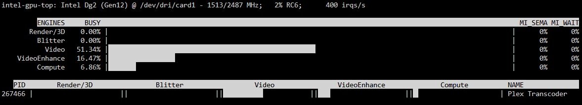

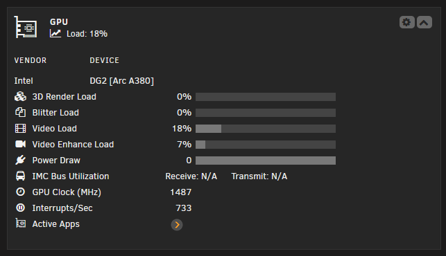

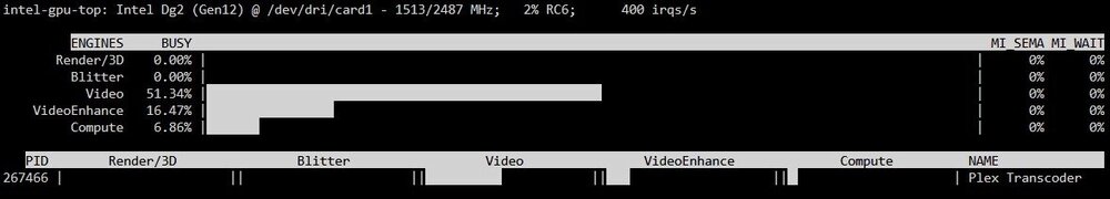

  3. I am getting the error message "Vendor command returned unparseable data." with an intel A380 running Unraid 7.0 I've included screenshots of intel_gpu_top and the dashboard also. I've also un-installed and re-installed both GPU stats and Intel GPU Top. This was happening on 6.12 also but was hoping 7.0 would fix it Here are the outputs for support timeout -k .500 .400 intel_gpu_top -J -s 250 I also tried timeout -k .7 1.3 intel_gpu_top -J -s 250 Here is the contents of /boot/config/plugins/gpustat/gpustat.cfg MULTIGPU = "b1:00.0" TEMPFORMAT = "C" UIREFRESH = 1 UIREFRESHINT = 2000 DISPCLOCKS = 1 DISPPCIUTIL = 1 DISPPWRDRAW = 1 DISPPWRSTATE = 1 DISPMEMUTIL = 1 DISPTEMP = 1 DISPFAN = 1 DISPENCDEC = 1 DISPTHROTTLE = 1 DISPSESSIONS = 1 DISP3DRENDER = 1 DISPBLITTER = 1 DISPVIDEO = 1 DISPVIDENH = 1 DISPINTERRUPT = 1 DISPPWRDRWSEL = "GPU" IGTTIMER = ".7 1.3" DISPEVENT = 1 DISPVERTEX = 1 DISPTEXTURE = 1 DISPSHADEREXP = 1 DISPSEQUENCER = 1 DISPSHADERINTER = 1 DISPSCANCON = 1 DISPPRIMASSEM = 1 DISPDEPTHBLK = 1 DISPCOLORBLK = 1 DISPGFXTRANS = 1 MULTIGPUJSON = "%7B%22b1%3A00.0%22%3A%7B%22id%22%3A%22b1%3A00.0%22%2C%22model%22%3A%22DG2+%5BArc+A380%5D%22%2C%22vendor%22%3A%22intel%22%2C%22guid%22%3A%220000%3Ab1%3A00.0%22%7D%7D" Thanks for you help
