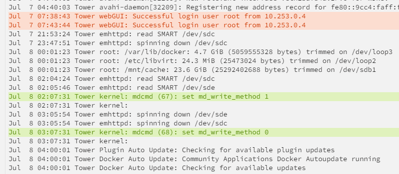

Thanks you for info! Is there some method to define a reason of my case? As can I see there are not any processes before SMART and spinning down in the logs

Hi all! I'm trying to set up so that the disks do not spin up outside the time allotted for this. I almost succeeded, but the logs show that the disks spin up at a certain time. As I understand it does SMART. How can I configure the launch of SMART at a certain time? or just turn off automatic checking, with further manual control. Thanks in advance!

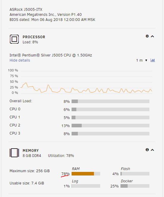

Hello! Today I have been noticed with this error. Could you help me please with this error? If you take a look at the screen below you will see that my server usually use about 73-78% of RAM. Before update of Unraid system I did not get this errors. What is wrong? Please see attached logs and picture. Thanks you! Unraid version 6.10.2-rc3 tower-syslog-20220530-0709.zip

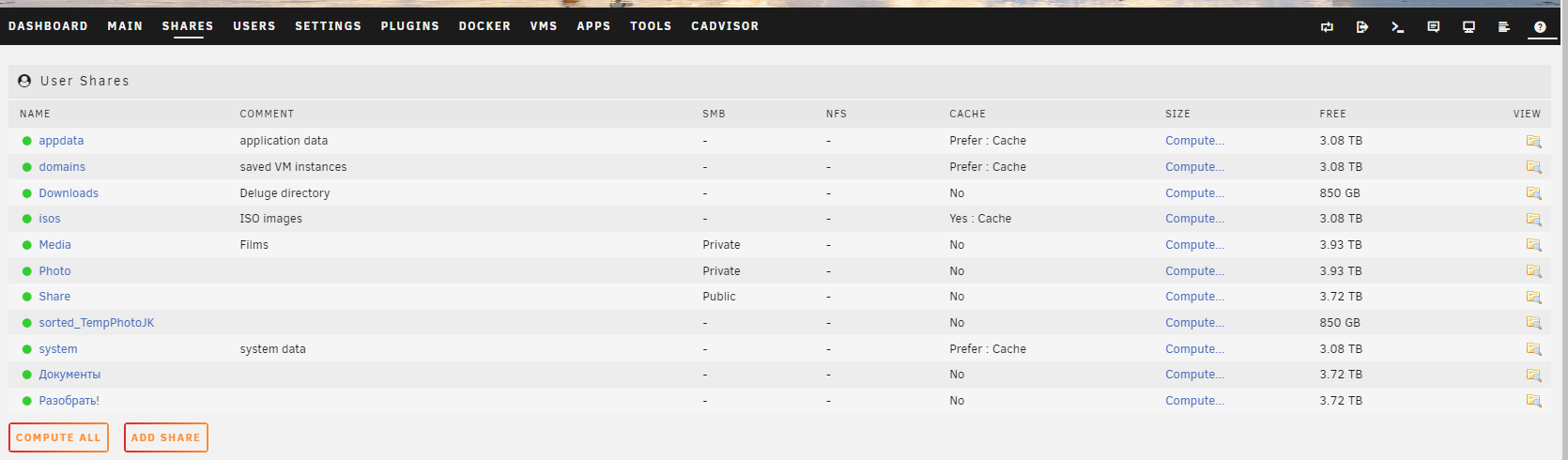

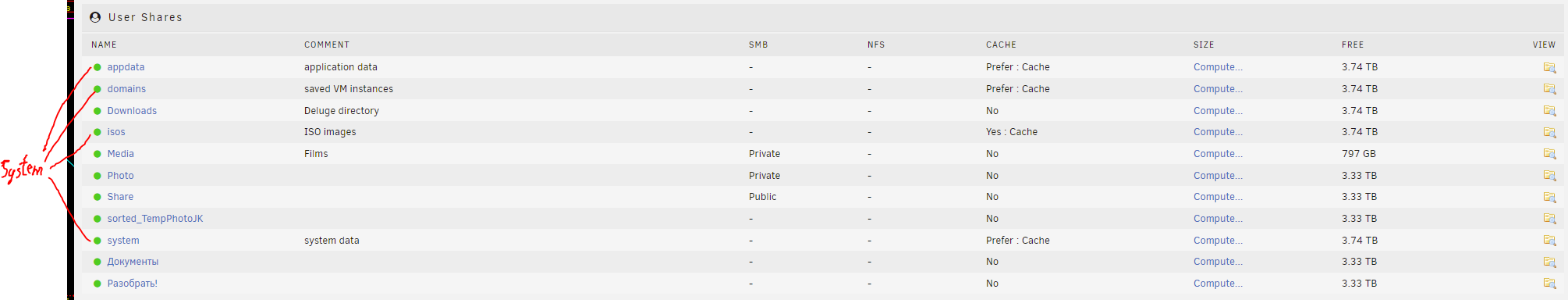

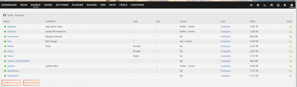

How to re-install Unraid correct

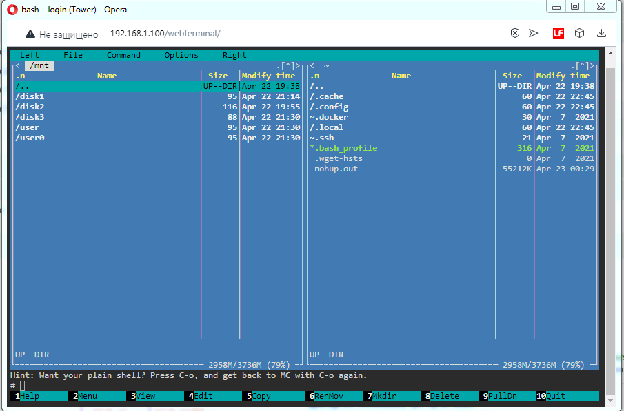

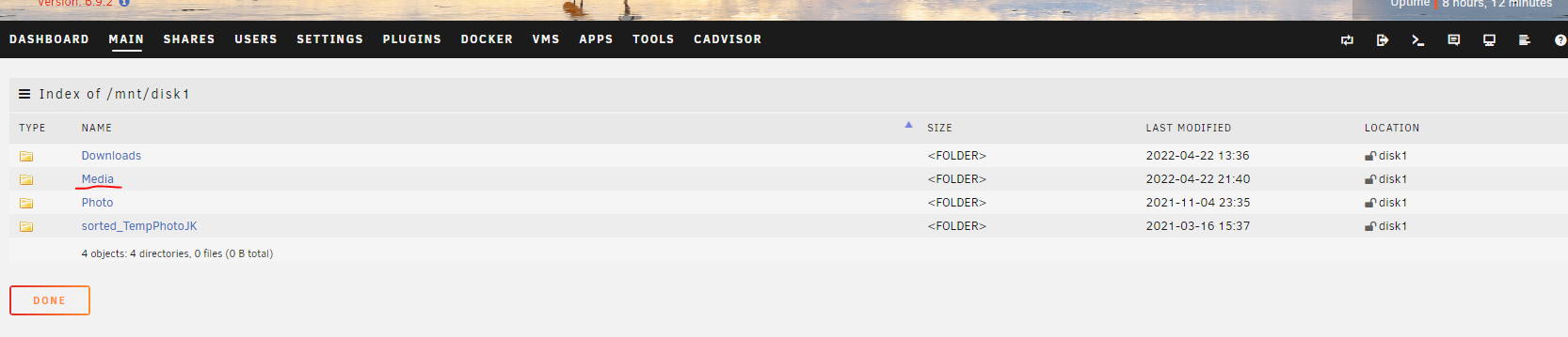

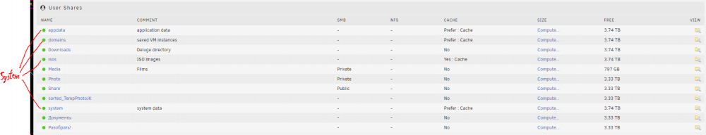

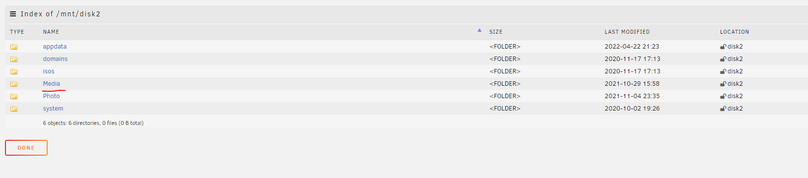

Hello! Sorry for my English. Over the past few days I have been trying to optimize my system. Because I'm new to this business, I configured the Share incorrectly from the very beginning. As a result, these Share ended up on different disks. I tried to move the files and share from one drive to another. That is, I made a lot of mistakes, as I found out later that you can not copy from Share to disk and vice versa. I used the cp and mv commands to make it all work. For example, the Media folder had multiple copies on disks 2 and 3 (because disk 2 ran out of space). I moved both folders (which are Share) to 1 disk. Please see pictures. And so I did for all Share. Now it is not clear yet whether I have lost the information or not, but I cannot enter any container: a connection error. So my question is how to re-install system to fix all my possible troubles which I will know and will not know and of course save data. Please step by step if possible. P.S.: What are the user and user0 folders in the lowest picture? They have the same content.
