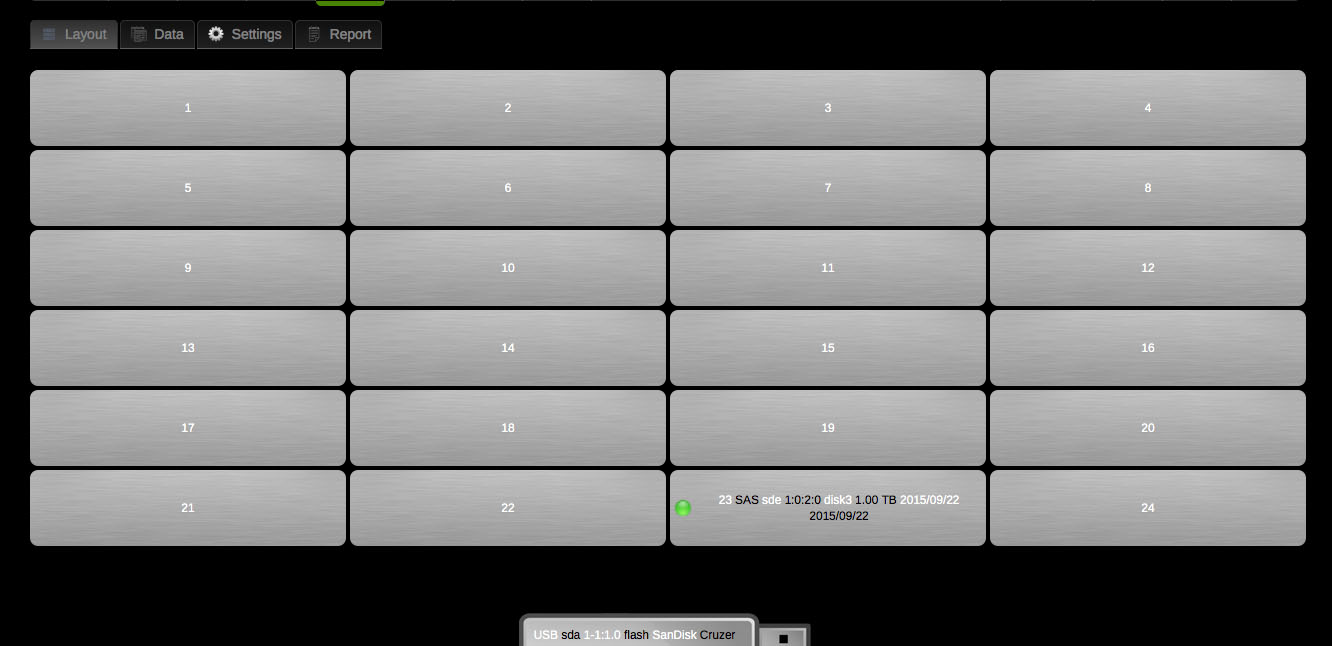

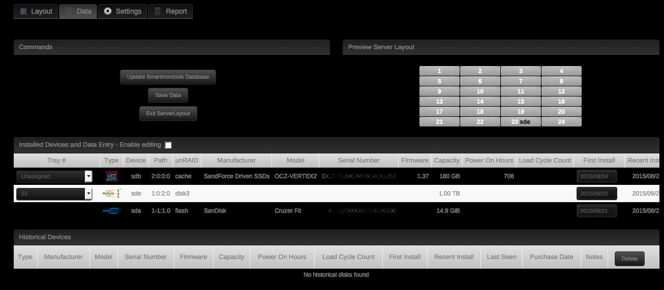

  4. Please retry with the latest plugin version. The latest update fixed my issue! You truly are THEONE! All my SAS drives are now visible and can be assigned in the 'Data' tab. Manufacturer, Model, S/N, Firmware and Capacity fields populate correctly. Thank you once again for outstanding plugin and all the extra work to accommodate my particular use case.
  5. Please test new version and post screenshot of Layout and DATA tab if possible. First off, Big thanks for the plugin and especially for working to add a fix for this non-typical device type. It is very much appreciated. So... I now see one of the SAS devices on the "Data" page. Yaaaay!!! But, not the other 7 that are currently installed. Here is what I have done so far: 1 - updated Server Layout plugin (SAS drive sde shows up on data page) 2 - rebooted & clicked "update Smartmontools Database" (sde is still present but no other SAS drives) 2 - updated unRaid to 6.1.3 & reboot & clicked "update Smartmontools Database" (sde is still present but no other SAS drives) I should also note, and this is not related to this plugin, but I think it may be relevant. When my array is started and the disks show 'green' on the Main page, I never see drive temps. Also, when I select a disk from the main page it always says the SAS drives are "Unavailable - disk must be spun up". When I select spin-up the page refreshes but nothing changes. I think support of SAS drives in unRaid as a whole is minimal. - EDIT - I forgot to mention that even when drives show active all 'smart' option buttons are greyed out with the exception of the afore mentioned 'spin-up' and the 'download'. Please post output of "ls -las /dev/disk/by-id". and "lsscsi" and "lsscsi -t" and "smartctl --all /dev/sdx" of one of the drives connected to the SAS. Are you using an Areca controller? Starting with the last question first then I will get to the outputs of the requested commands. The controller is a SuperMicro AOC-SAS2LP-MV8. Not sure which firmware rev., but I will check when I have a chance. I will also try adding a couple more SAS drives but connect them with a reverse cable directly to the MB SATA ports (been meaning to do that any way). Now for the requested command outputs: ls -las /dev/disk/by-id total 0 0 drwxr-xr-x 2 root root 800 Sep 22 14:50 ./ 0 drwxr-xr-x 6 root root 120 Sep 22 14:50 ../ 0 lrwxrwxrwx 1 root root 9 Sep 22 14:50 ata-OCZ-VERTEX2_OCZ-7139ICMP6O4OG353 -> ../../sdb 0 lrwxrwxrwx 1 root root 10 Sep 22 14:50 ata-OCZ-VERTEX2_OCZ-7139ICMP6O4OG353-part1 -> ../../sdb1 0 lrwxrwxrwx 1 root root 9 Sep 22 14:50 scsi-35000c50010176e8f -> ../../sdg 0 lrwxrwxrwx 1 root root 10 Sep 22 14:50 scsi-35000c50010176e8f-part1 -> ../../sdg1 0 lrwxrwxrwx 1 root root 9 Sep 22 14:50 scsi-35000c5001019aadb -> ../../sdi 0 lrwxrwxrwx 1 root root 10 Sep 22 14:50 scsi-35000c5001019aadb-part1 -> ../../sdi1 0 lrwxrwxrwx 1 root root 9 Sep 22 14:50 scsi-35000c500101d1def -> ../../sdd 0 lrwxrwxrwx 1 root root 10 Sep 22 14:50 scsi-35000c500101d1def-part1 -> ../../sdd1 0 lrwxrwxrwx 1 root root 9 Sep 22 14:50 scsi-35000c50010202287 -> ../../sdc 0 lrwxrwxrwx 1 root root 10 Sep 22 14:50 scsi-35000c50010202287-part1 -> ../../sdc1 0 lrwxrwxrwx 1 root root 9 Sep 22 14:50 scsi-35000c5001020228f -> ../../sdh 0 lrwxrwxrwx 1 root root 10 Sep 22 14:50 scsi-35000c5001020228f-part1 -> ../../sdh1 0 lrwxrwxrwx 1 root root 9 Sep 22 14:50 scsi-35000c500102089a7 -> ../../sdf 0 lrwxrwxrwx 1 root root 10 Sep 22 14:50 scsi-35000c500102089a7-part1 -> ../../sdf1 0 lrwxrwxrwx 1 root root 9 Sep 22 14:50 scsi-35000c5001020c6ff -> ../../sdj 0 lrwxrwxrwx 1 root root 10 Sep 22 14:50 scsi-35000c5001020c6ff-part1 -> ../../sdj1 0 lrwxrwxrwx 1 root root 9 Sep 22 14:50 scsi-35000c50020e5c55b -> ../../sde 0 lrwxrwxrwx 1 root root 10 Sep 22 14:50 scsi-35000c50020e5c55b-part1 -> ../../sde1 0 lrwxrwxrwx 1 root root 9 Sep 22 21:42 usb-SanDisk_Cruzer_Fit_4C532000040713109330-0:0 -> ../../sda 0 lrwxrwxrwx 1 root root 10 Sep 22 14:50 usb-SanDisk_Cruzer_Fit_4C532000040713109330-0:0-part1 -> ../../sda1 0 lrwxrwxrwx 1 root root 9 Sep 22 14:50 wwn-0x5000c50010176e8f -> ../../sdg 0 lrwxrwxrwx 1 root root 10 Sep 22 14:50 wwn-0x5000c50010176e8f-part1 -> ../../sdg1 0 lrwxrwxrwx 1 root root 9 Sep 22 14:50 wwn-0x5000c5001019aadb -> ../../sdi 0 lrwxrwxrwx 1 root root 10 Sep 22 14:50 wwn-0x5000c5001019aadb-part1 -> ../../sdi1 0 lrwxrwxrwx 1 root root 9 Sep 22 14:50 wwn-0x5000c500101d1def -> ../../sdd 0 lrwxrwxrwx 1 root root 10 Sep 22 14:50 wwn-0x5000c500101d1def-part1 -> ../../sdd1 0 lrwxrwxrwx 1 root root 9 Sep 22 14:50 wwn-0x5000c50010202287 -> ../../sdc 0 lrwxrwxrwx 1 root root 10 Sep 22 14:50 wwn-0x5000c50010202287-part1 -> ../../sdc1 0 lrwxrwxrwx 1 root root 9 Sep 22 14:50 wwn-0x5000c5001020228f -> ../../sdh 0 lrwxrwxrwx 1 root root 10 Sep 22 14:50 wwn-0x5000c5001020228f-part1 -> ../../sdh1 0 lrwxrwxrwx 1 root root 9 Sep 22 14:50 wwn-0x5000c500102089a7 -> ../../sdf 0 lrwxrwxrwx 1 root root 10 Sep 22 14:50 wwn-0x5000c500102089a7-part1 -> ../../sdf1 0 lrwxrwxrwx 1 root root 9 Sep 22 14:50 wwn-0x5000c5001020c6ff -> ../../sdj 0 lrwxrwxrwx 1 root root 10 Sep 22 14:50 wwn-0x5000c5001020c6ff-part1 -> ../../sdj1 0 lrwxrwxrwx 1 root root 9 Sep 22 14:50 wwn-0x5000c50020e5c55b -> ../../sde 0 lrwxrwxrwx 1 root root 10 Sep 22 14:50 wwn-0x5000c50020e5c55b-part1 -> ../../sde1 0 lrwxrwxrwx 1 root root 9 Sep 22 14:50 wwn-0x5e83a97f59908210 -> ../../sdb 0 lrwxrwxrwx 1 root root 10 Sep 22 14:50 wwn-0x5e83a97f59908210-part1 -> ../../sdb1 lsscsi [0:0:0:0] disk SanDisk Cruzer Fit 1.26 /dev/sda [1:0:0:0] disk HP DB1000BABFF HPD5 /dev/sdc [1:0:1:0] disk HP DB1000BABFF HPD8 /dev/sdd [1:0:2:0] disk HP MB1000FAMYU HPD2 /dev/sde [1:0:3:0] disk HP DB1000BABFF HPD5 /dev/sdf [1:0:4:0] disk HP DB1000BABFF HPD5 /dev/sdg [1:0:5:0] disk HP DB1000BABFF HPD5 /dev/sdh [1:0:6:0] disk HP DB1000BABFF HPD5 /dev/sdi [1:0:7:0] disk HP DB1000BABFF HPD5 /dev/sdj [2:0:0:0] disk ATA OCZ-VERTEX2 1.37 /dev/sdb lsscsi -t [0:0:0:0] disk usb: 1-1:1.0 /dev/sda [1:0:0:0] disk sas:0x5000c50010202285 /dev/sdc [1:0:1:0] disk sas:0x5000c500101d1ded /dev/sdd [1:0:2:0] disk sas:0x5000c50020e5c559 /dev/sde [1:0:3:0] disk sas:0x5000c500102089a5 /dev/sdf [1:0:4:0] disk sas:0x5000c50010176e8d /dev/sdg [1:0:5:0] disk sas:0x5000c5001020228d /dev/sdh [1:0:6:0] disk sas:0x5000c5001019aad9 /dev/sdi [1:0:7:0] disk sas:0x5000c5001020c6fd /dev/sdj [2:0:0:0] disk ata: /dev/sdb smartctl --all /dev/sdc - for a SAS drive that does not show up in the plugin smartctl 6.2 2013-07-26 r3841 [x86_64-linux-4.1.7-unRAID] (local build) Copyright (C) 2002-13, Bruce Allen, Christian Franke, www.smartmontools.org === START OF INFORMATION SECTION === Vendor: HP Product: DB1000BABFF Revision: HPD5 User Capacity: 1,000,204,886,016 bytes [1.00 TB] Logical block size: 512 bytes Rotation Rate: 7200 rpm Logical Unit id: 0x5000c50010202287 Serial number: 9QJ6D0S000009022A1LG Device type: disk Transport protocol: SAS Local Time is: Thu Sep 24 10:58:57 2015 MDT SMART support is: Available - device has SMART capability. SMART support is: Enabled Temperature Warning: Enabled === START OF READ SMART DATA SECTION === SMART Health Status: OK Current Drive Temperature: 37 C Drive Trip Temperature: 68 C Elements in grown defect list: 0 Vendor (Seagate) cache information Blocks sent to initiator = 2540508505 Blocks received from initiator = 3437671110 Blocks read from cache and sent to initiator = 606203452 Number of read and write commands whose size <= segment size = 6325773 Number of read and write commands whose size > segment size = 0 Vendor (Seagate/Hitachi) factory information number of hours powered up = 6514.35 number of minutes until next internal SMART test = 43 Error counter log: Errors Corrected by Total Correction Gigabytes Total ECC rereads/ errors algorithm processed uncorrected fast | delayed rewrites corrected invocations [10^9 bytes] errors read: 0 0 0 0 0 0.000 0 write: 0 0 0 0 0 0.000 0 Non-medium error count: 0 No self-tests have been logged smartctl --all /dev/sde - for a SAS drive that DOES show up in the plugin smartctl 6.2 2013-07-26 r3841 [x86_64-linux-4.1.7-unRAID] (local build) Copyright (C) 2002-13, Bruce Allen, Christian Franke, www.smartmontools.org === START OF INFORMATION SECTION === Vendor: HP Product: MB1000FAMYU Revision: HPD2 User Capacity: 1,000,204,886,016 bytes [1.00 TB] Logical block size: 512 bytes Rotation Rate: 7200 rpm Form Factor: 3.5 inches Logical Unit id: 0x5000c50020e5c55b Serial number: 9WK0FR710000C038DKM1 Device type: disk Transport protocol: SAS Local Time is: Thu Sep 24 10:59:02 2015 MDT SMART support is: Available - device has SMART capability. SMART support is: Enabled Temperature Warning: Enabled === START OF READ SMART DATA SECTION === SMART Health Status: OK Current Drive Temperature: 37 C Drive Trip Temperature: 65 C Manufactured in week 19 of year 2010 Specified cycle count over device lifetime: 10000 Accumulated start-stop cycles: 11 Specified load-unload count over device lifetime: 300000 Accumulated load-unload cycles: 11 Elements in grown defect list: 0 Vendor (Seagate) cache information Blocks sent to initiator = 263640184 Blocks received from initiator = 1514716588 Blocks read from cache and sent to initiator = 32749626 Number of read and write commands whose size <= segment size = 143666 Number of read and write commands whose size > segment size = 0 Vendor (Seagate/Hitachi) factory information number of hours powered up = 825.18 number of minutes until next internal SMART test = 42 Error counter log: Errors Corrected by Total Correction Gigabytes Total ECC rereads/ errors algorithm processed uncorrected fast | delayed rewrites corrected invocations [10^9 bytes] errors read: 0 0 0 5903552 0 134.984 0 write: 0 0 0 0 0 776.068 0 verify: 0 0 0 30575 0 0.000 0 Non-medium error count: 333 No self-tests have been logged
  6. Please test new version and post screenshot of Layout and DATA tab if possible. First off, Big thanks for the plugin and especially for working to add a fix for this non-typical device type. It is very much appreciated. So... I now see one of the SAS devices on the "Data" page. Yaaaay!!! But, not the other 7 that are currently installed. Here is what I have done so far: 1 - updated Server Layout plugin (SAS drive sde shows up on data page) 2 - rebooted & clicked "update Smartmontools Database" (sde is still present but no other SAS drives) 2 - updated unRaid to 6.1.3 & reboot & clicked "update Smartmontools Database" (sde is still present but no other SAS drives) I should also note, and this is not related to this plugin, but I think it may be relevant. When my array is started and the disks show 'green' on the Main page, I never see drive temps. Also, when I select a disk from the main page it always says the SAS drives are "Unavailable - disk must be spun up". When I select spin-up the page refreshes but nothing changes. I think support of SAS drives in unRaid as a whole is minimal. - EDIT - I forgot to mention that even when drives show active all 'smart' option buttons are greyed out with the exception of the afore mentioned 'spin-up' and the 'download'.
  7. Here is the lsscsi. @DeadPool:~# lsscsi [0:0:0:0] disk SanDisk Cruzer Fit 1.26 /dev/sda [1:0:0:0] disk HP DB1000BABFF HPD5 /dev/sdc [1:0:1:0] disk HP DB1000BABFF HPD8 /dev/sdd [1:0:2:0] disk HP MB1000FAMYU HPD2 /dev/sde [1:0:3:0] disk HP DB1000BABFF HPD5 /dev/sdf [1:0:4:0] disk HP DB1000BABFF HPD5 /dev/sdg [1:0:5:0] disk HP DB1000BABFF HPD5 /dev/sdh [1:0:6:0] disk HP DB1000BABFF HPD5 /dev/sdi [1:0:7:0] disk HP DB1000BABFF HPD5 /dev/sdj [2:0:0:0] disk ATA OCZ-VERTEX2 1.37 /dev/sdb And here is an ls -las /dev/disk/by-id as well just for good measure. DeadPool:~# ls -las /dev/disk/by-id total 0 0 drwxr-xr-x 2 root root 720 Aug 24 09:25 ./ 0 drwxr-xr-x 6 root root 120 Aug 24 09:25 ../ 0 lrwxrwxrwx 1 root root 9 Aug 24 09:25 ata-OCZ-VERTEX2_OCZ-7139ICMP6O4OG353 -> ../../sdb 0 lrwxrwxrwx 1 root root 9 Aug 24 09:25 scsi-35000c50010176e8f -> ../../sdg 0 lrwxrwxrwx 1 root root 10 Aug 24 09:25 scsi-35000c50010176e8f-part1 -> ../../sdg1 0 lrwxrwxrwx 1 root root 9 Aug 24 09:25 scsi-35000c5001019aadb -> ../../sdi 0 lrwxrwxrwx 1 root root 10 Aug 24 09:25 scsi-35000c5001019aadb-part1 -> ../../sdi1 0 lrwxrwxrwx 1 root root 9 Aug 24 09:25 scsi-35000c500101d1def -> ../../sdd 0 lrwxrwxrwx 1 root root 10 Aug 24 09:25 scsi-35000c500101d1def-part1 -> ../../sdd1 0 lrwxrwxrwx 1 root root 9 Aug 24 09:25 scsi-35000c50010202287 -> ../../sdc 0 lrwxrwxrwx 1 root root 10 Aug 24 09:25 scsi-35000c50010202287-part1 -> ../../sdc1 0 lrwxrwxrwx 1 root root 9 Aug 24 09:25 scsi-35000c5001020228f -> ../../sdh 0 lrwxrwxrwx 1 root root 9 Aug 24 09:25 scsi-35000c500102089a7 -> ../../sdf 0 lrwxrwxrwx 1 root root 10 Aug 24 09:25 scsi-35000c500102089a7-part1 -> ../../sdf1 0 lrwxrwxrwx 1 root root 9 Aug 24 09:25 scsi-35000c5001020c6ff -> ../../sdj 0 lrwxrwxrwx 1 root root 10 Aug 24 09:25 scsi-35000c5001020c6ff-part1 -> ../../sdj1 0 lrwxrwxrwx 1 root root 9 Aug 24 09:25 scsi-35000c50020e5c55b -> ../../sde 0 lrwxrwxrwx 1 root root 10 Aug 24 09:25 scsi-35000c50020e5c55b-part1 -> ../../sde1 0 lrwxrwxrwx 1 root root 9 Aug 24 10:44 usb-SanDisk_Cruzer_Fit_4C532000040713109330-0:0 -> ../../sda 0 lrwxrwxrwx 1 root root 10 Aug 24 09:25 usb-SanDisk_Cruzer_Fit_4C532000040713109330-0:0-part1 -> ../../sda1 <further lines omitted>
