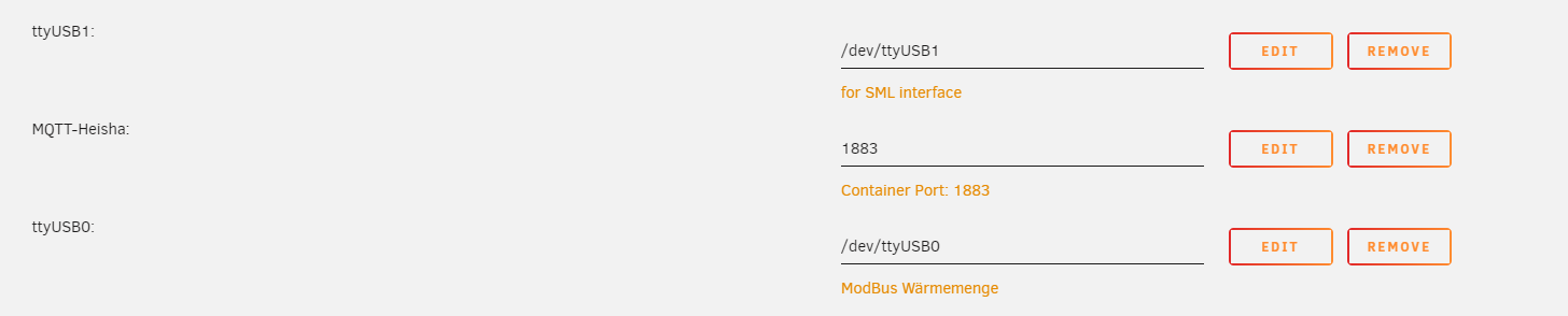

  2. Hi, USB device assignement and order changing very often, how ist it possible to assign fixed /dev/ttyUSBx to USB devices ? USB devices are plugged in to same port for month and no chaning, removing or any else dynamic actions with USB. My most important docker for home automations ( SYMCON ) needs license assignmement after hardware changes. Yesterday order was ttyUSB0 an ttyUSB1 and now ttyUSB2 and ttyUSB1 Docker configuration, from yesterday and devices from today root@server:/dev/serial/by-id# ls -l total 0 lrwxrwxrwx 1 root root 13 Feb 12 11:16 usb-Prolific_Technology_Inc._USB-Serial_Controller_AMAAn114J20-if00-port0 -> ../../ttyUSB2 lrwxrwxrwx 1 root root 13 Feb 11 23:54 usb-Silicon_Labs_CP2102_USB_to_UART_Bridge_Controller_0069-if00-port0 -> ../../ttyUSB1 root@server:/dev/serial/by-id# BTW USB mamanger is installed and with VM´s I have no problems.
