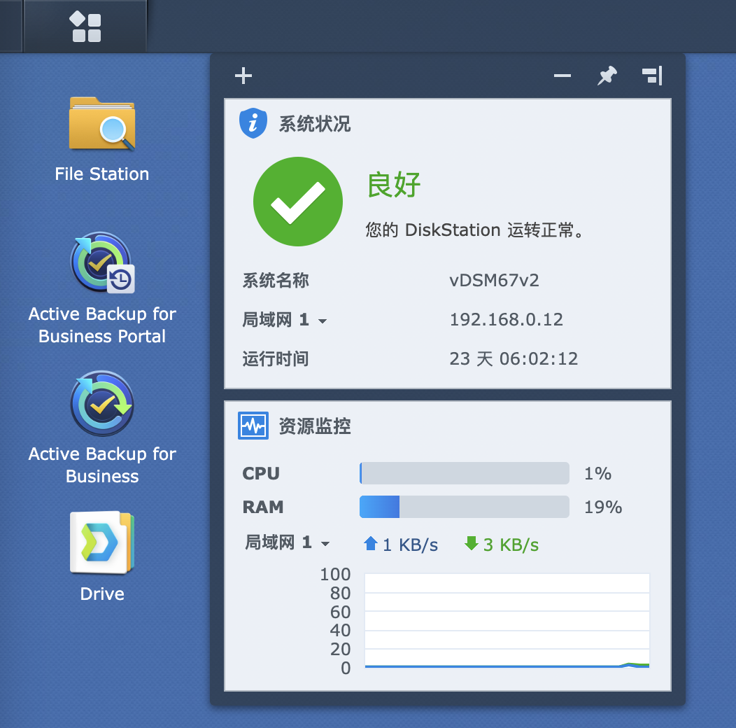

  4. 朋友们,大佬们。 我现在的配置算是一个伪All In One,具体是这样的: 主机是戴尔的PowerEdgeR720八盘位,主机的系统是ESXi, 虚拟了一个Unraid直通四个4T盘(1校验+3数据盘,就存放电视电影,以及一个jellyfin的docker,一句话就是用来看电视) 虚拟了一个黑裙直通两个8T盘(做Raid1,就两个功能一个是drive套件,一个是active backup套件备份除了unraid,黑裙本体和下载及安机之外的所有虚拟机) 主机上还插了三块硬盘,一块satassd(做esxi系统盘),一块2T盘(下文说用途),至此八盘尾插满,额外PCIE槽还有一块1T的nvme(用作存放除上面两个之外的虚拟机的系统盘) 虚拟了一个windows10额外直通了2T盘当迅雷下载器,削挂器之类的。 虚拟了一个docker运行kms,ddns之类的平时不在意但是又不可缺的小玩意。 以及分别虚拟了一堆工作用的工具,服务在各自虚拟机里,以及一堆私服,mc,wow,rust之类的。 目前运行良好,但是缺点是esxi直通导致的unraid和黑裙并不能完整的识别硬盘的smart信息,只能靠手动的在主机ssh敲命令来确认硬盘健康。 因为上述的一个缺点,我觉得要是哪块硬盘哪天出问题了也并不能很好的提前预警,所以想请教各位如果我主机就直接安装Unraid,然后可以把除黑裙之外(群晖要么直接不要了要么重新用白群额外用在主机之外,暂时再议)的所有虚拟机和docker服务搭建在Unraid上,如果这么操作的话: 1,数据安全有保障吗? 2,硬盘来得及读取吗?(因为unraid阵列听说不论加入多少块硬盘,他的读取性能始终就是单盘的水平,说实话我虚拟机挺多的而且有些还挺重要的) 谢谢朋友们解答。

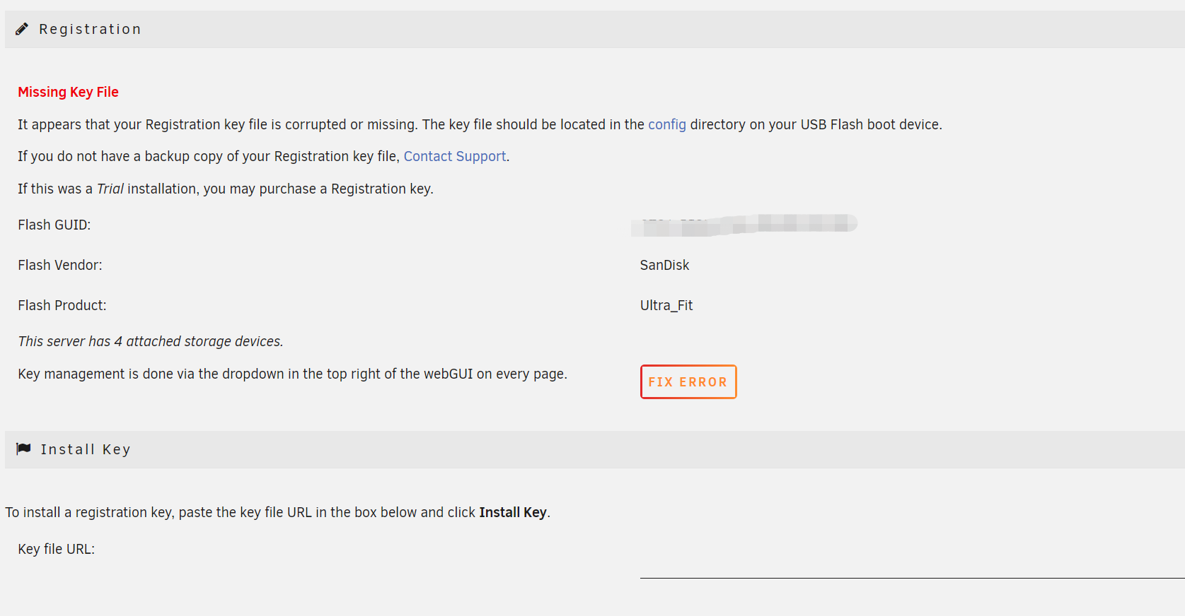

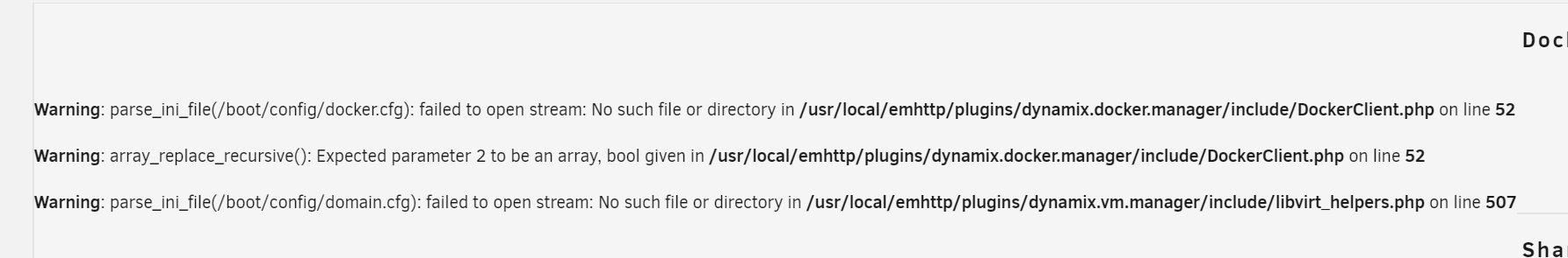

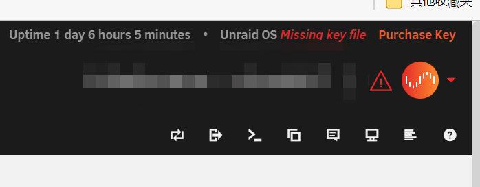

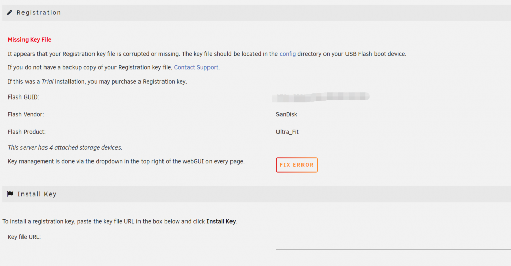

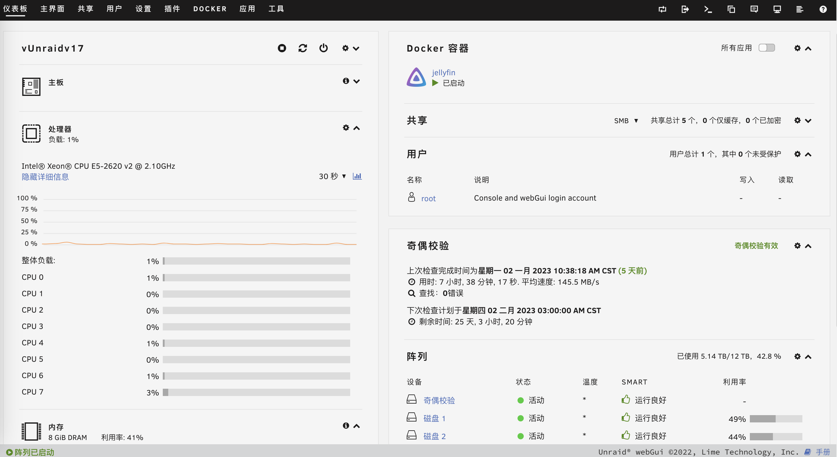

  7. Yes sure, sorry i forgot it. vunraidv17-diagnostics-20220613-0035.zip
  8. Hello everyone and wish all of you the best. This is the second time that it happens. Just i thought my unraid is running fine, that i noticed that i couldn`t open the smb shared folder(from unraid of crouse) by use my laptop, so i opened unraid server web console, and it said on top right corner: "Missing Key File" , as image#1 and this is how it shows on dashboard: and this is show on tools/registration menu: And yes by the way, my key is bought legally on the official unraid page with coupon code, definitely. Please if anyone could let me know that the problem is on my key or on my USB drive? Thanks a lot really.

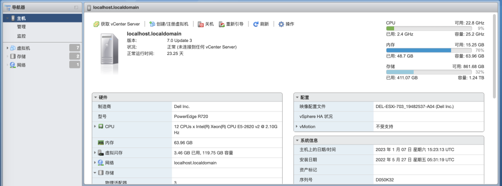

  9. Hi and thank you. So it is s esxi6.x issue it is. I think my server don`t have a official 7.x support sadly. FYI, it is a machine that just retired from our business so now i used it to my personal use, so i should say it is just setup and start to run both esxi and unraid. Again thank you for your information, now know issue is in esxi, i can start to solve it.
