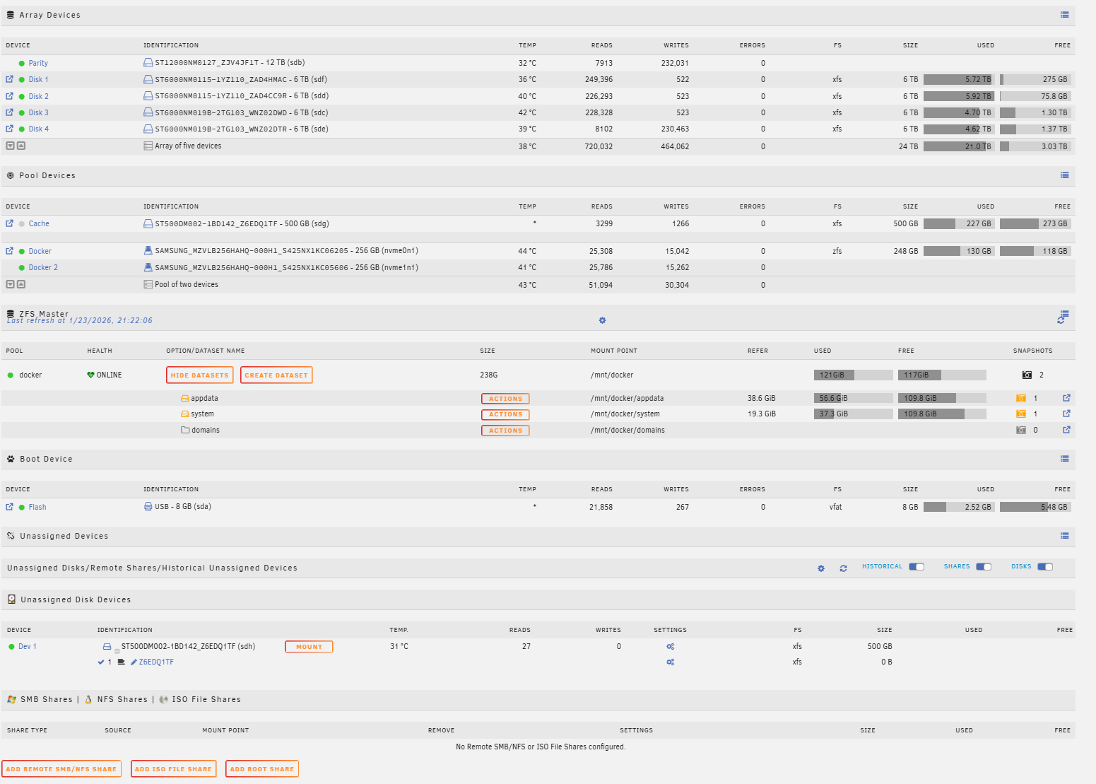

  7. okay so after a bit more trialing. after array starts all looks normal until the cache drive gets a few writes going (after dock containers start up) then the drive also shows up under unassigned devices, the shares disappear. cant navigate to the contents of the cache drive via unraid GUI or windows network share. in terms of my hard drives phyical config all hdds are connected via Dell TD2NM H330 HBA (sold via theartofserver) with 2x StarTech.com 1m Internal Mini SAS to SATA Cable (lifetime warranty) no other drives are having any issues that i can see, i also changed the sata connector the cache drive was using just incase. cables have also been checked. 2 diags uploaded. one right after server boot and one after array started and the issue occurs. screenshot after issue occurs. Thanks All after array start + writes.zip right after reboot.zip

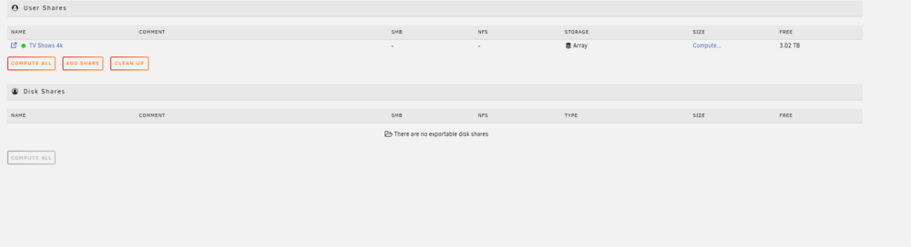

  9. scratch that, still happening even with mover disabled. oddly enough i deleted the 'tv shows 4k' share (it was empty anyway) usually that was the only share left being shown but now with the issue occurring it showed 3 shares but not the rest. this share issue is happening pretty soon after starting the array after server reboot. mover disabled. fresh logs attached from right after. storageserver-diagnostics-20260123-1237.zip
  10. have run this and confirmed only shares are now listed with the rest being removed. have then also confirmed it breaks the shares when invoking mover. (happens within 30 seconds or so)

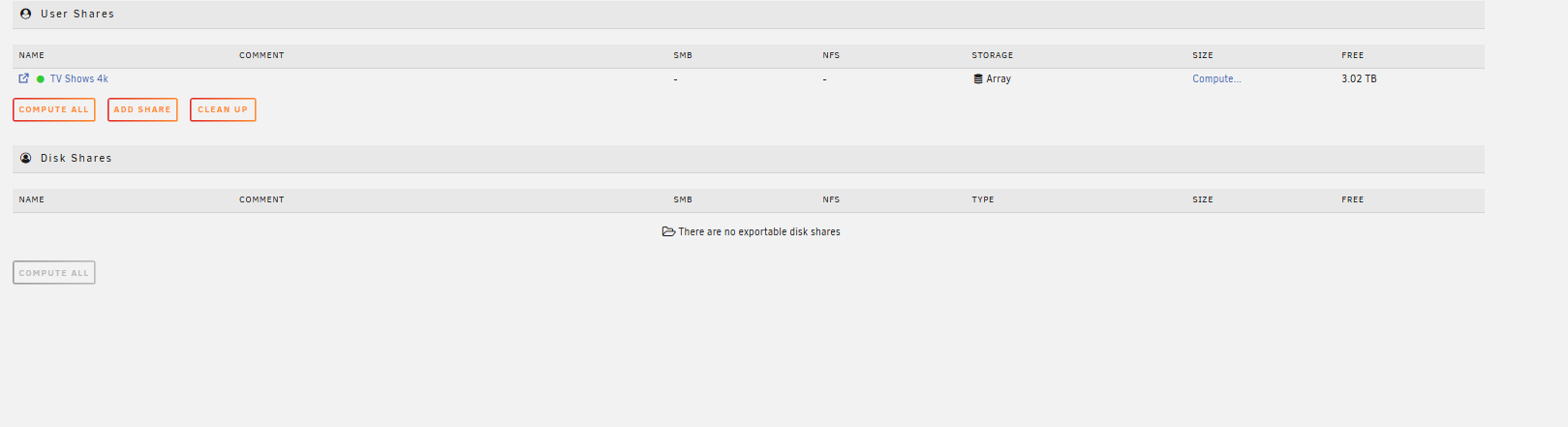

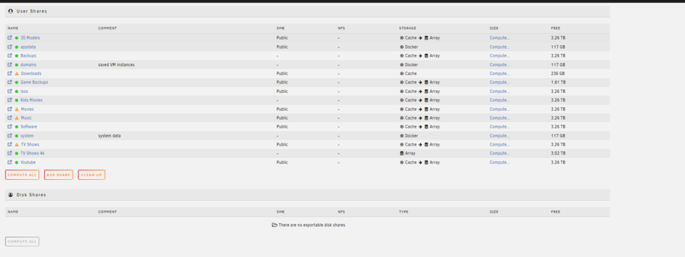

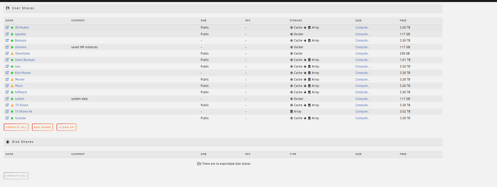

  13. Hi All I've recently been having this issue daily where all except one share is missing when i first look at my server each day. have never had this issue before and now i believe today is 3 days in a row running the latest stable version of unraid. a reboot resolves this issue but doesn't prevent it happening again. is anyone else having this issue? image 1 is during the issue, image 2 is after a reboot. Thanks all

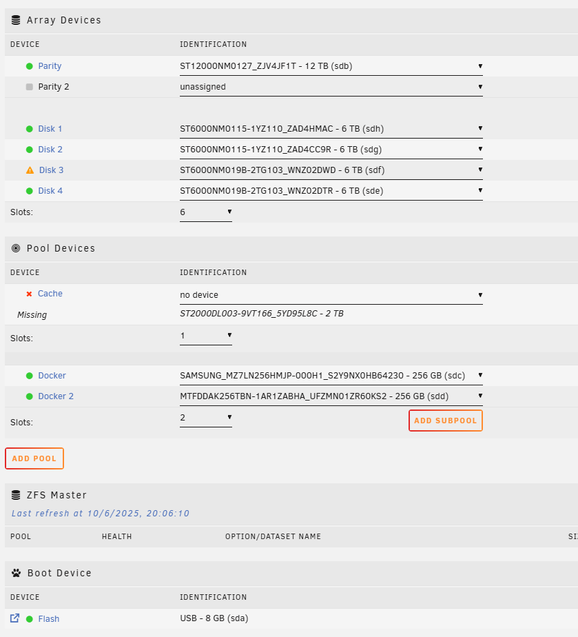

  14. Hi All I'm hoping to get some reassurance before making any moves. I'm currently in a situation most likely caused by a fake HBA Card which requires me to rebuild a drive all drives are now connected via motherboard sata ports. when trying to rebuild drive 3 the whole system hangs , cant connect via GUI and cant ping system. Looking at diagnostics it seems the 'cache drive' is causing this, it is an old drive so could be the reason (drive is just for downloads) I'm trying to remove this drive so that i can then rebuild the array and avoid the hanging. but simply unassigning it and then trying to start the array shows the following error message: Wrong Pool State cache - too many wrong or missing devices Chat GPT thinks i should unassign the disk and then do a new config and retain all drives but the warning around that say that i wont be able to rebuild a drive after doing that, so I'm naturally anxious. Any advice would be appreciated Thanks Zass
