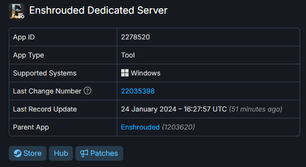

  5. Isn't that a windows only server app?
