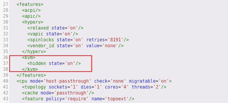

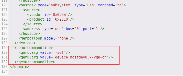

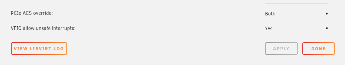

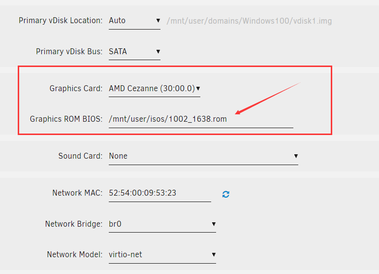

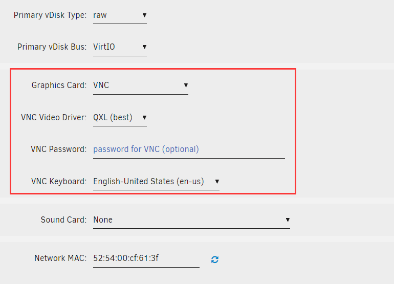

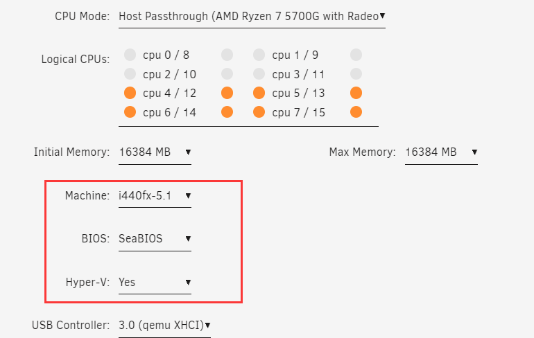

  8. I have been running stably for more than 24 hours on the unraid 6.9.2 through the i440fx-5.1 model through the 5700g igpu If you use Q35-5.1 unsuccessfully, you can try i440fx-5.1 I can only speak simple English,only google translate. My motherboard is MSI B450M MORTAR MAX, bios version 7B89v2G My CPU 5700G. Use UBU_v1.79.17 to extract vbios.rom of you motherboard bios kernel /bzimage append pcie_acs_override=downstream,multifunction vfio_iommu_type1.allow_unsafe_interrupts=1 video=efifb:off initrd=/bzroot Create a new vm win10 Machine:i440fx-5.1 BIOS:SeaBIOS Hyper-V:Yes Graphics Card just use vnc installing win10, installing virtio-win. My Computer - Properties - Advanced System Settings - Hardware - Device Installation Settings - Set to No. Don't let win10 download and install old amd drivers automatically。 Remember to change it back later. It is best to open the remote desktop, which is convenient for debugging later. Download the latest AMD 22.5.2 driver and RadeonResetBugFix in vm win10 https://github.com/inga-lovinde/RadeonResetBugFix Unzip the amd driver to any directory. shutdown win10。 edit win10 Modify the vnc of Graphics Card to AMD Cezanne (30:00.0),Specify the vbios.rom obtained earlier click update edit win10 again XML VIEW Add hidden state <kvm> <hidden state='on'/> </kvm> Add x-vga=on <qemu:commandline> <qemu:arg value='-set'/> <qemu:arg value='device.hostdev0.x-vga=on'/> </qemu:commandline> Ps:not very familiar with unradi。The following is not very clear。 if you modify the vm in the Virtual Machines GUI, it will automatically delete x-vga=on, and you have to manually add it in the XML VIEW mode each time. update. boot win10 If it is the first time to pass through the igpu。 The monitor lights up directly, enter the system (pass-through keyboard, mouse or remote desktop), install the amd driver, do not restart after the driver installation is complete, cmd RadeonResetBugFixService.exe install Wait a few minutes for the RadeonResetBugFixService installation to complete. Restart win10 again. When start win10 again, my monitor will be black for 1-2 minutes, wait patiently for RadeonResetBugFixService to activate the amd graphics card, and the monitor will light up again. Finally, remember to turn off the hibernation of win10, I found that hibernation may cause the host to crash. The second time my machine boots up vm win10 it starts to go black for a few minutes. Just be patient for a while. I don't know if it's because of my B450 motherboard or because of my dp interface But I tested with 6.10.2 yesterday. It can directly light up the display every time, and 6.10.2 has fixed the problem of gpu reset, but brought code 43. See the specific principle https://github.com/inga-lovinde/RadeonResetBugFix the bottom description. Windows100.xml

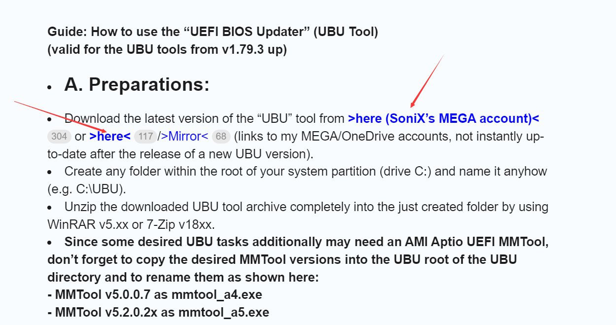

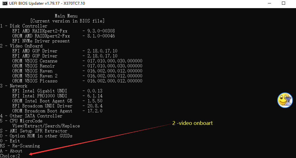

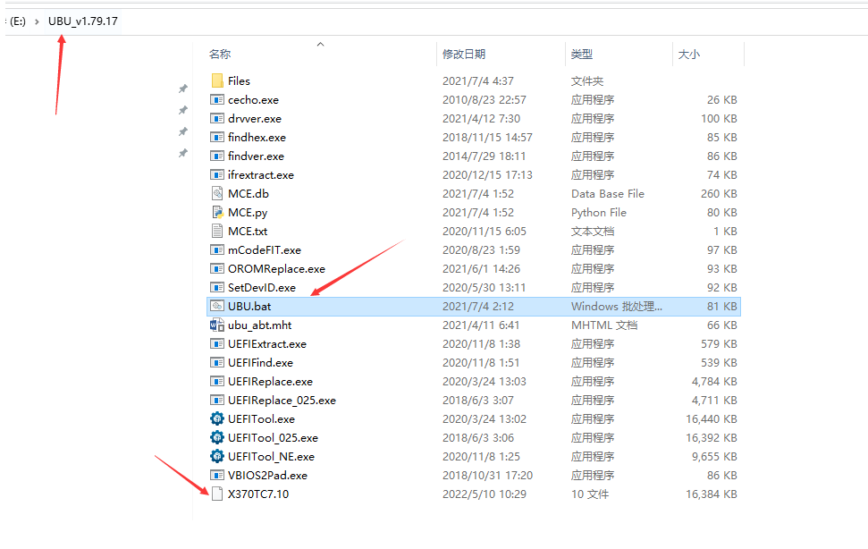

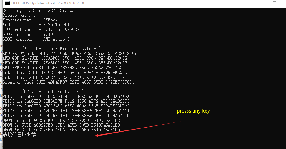

  9. down UBU_v1.79.17.rar https://winraid.level1techs.com/t/tool-guide-news-uefi-bios-updater-ubu/30357 Unzip the English directory For example E:\UBU_v1.79.17 Copy X370TC7.10 into E:\UBU_v1.79.17 Double click UBU.bat Wait for the prompt to press any key chioce 2 enter S enter choice 0 exit or just close At the same time you can open E:\UBU_v1.79.17\Files\AMD\VBIOS\_List_vbios.txt # 504349520210 vbis_xxx.dat rb " OROM VBIOS Rembrant - " 5043495202103F16 vbios_163F.dat vg " OROM VBIOS Van Gogh - " 5043495202103816 vbios_1638.dat ce " OROM VBIOS Cezanne - " 5043495202103616 vbios_1636.dat re " OROM VBIOS Renoir - " 504349520210D815 vbios_15D8.dat pi " OROM VBIOS Picasso - " 526176656E322047656E vbios_15DD_2.dat ra2 " OROM VBIOS Raven 2 - " 526176656E2047656E vbios_15DD_1.dat ra1 " OROM VBIOS Raven - "

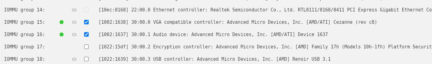

  11. Hi all,I succeeded!!! But my system is a HACKED QNAP 5.0 TS-877, basically following the techhit process. I'm not familiar with unraid, nor have unraid installed. So just for your reference.。 Thank you all very much !!! The following are the settings on my qnap system, please refer to My motherboard: MSI B450M MORTAR MAX My CPU: 5700G Linux kernel: 5.10.60-qnap grub.cfg: amd_iommu=on iommu=pt pcie_acs_override=downstream,multifunction video=efifb:off Get vbios rom: My motherboard is MSI B450M MORTAR MAX, bios version 7B89v2G,down motherboard BIOS。 down UBU_v1.79.17 https://winraid.level1techs.com/t/tool-guide-news-uefi-bios-updater-ubu/30357 extracted motherboard bios to UBU,run UBU.BAT Get file Extracted--VBIOS--017.010.000.030.000000--vbios_1638.dat This is you Cezanne's vbios.rom My Cezanne's vbios.rom version 017010.000.030.0000 BIOS setp: Re-Size BAR Support --enable Above 4G memory/Crypto --enable SR-IOV Support --enable Initiate Graphic Adapter --IGD Integrated Graphics --Force UMA Frame Buffer Size --4G IOMMU --enable DMA Protection --auto DMAr Support --auto SVM Mode --enable NX Mode --enable other all auto BOOT UEFI CSM cloese IOMMU Group: IOMMU Group 15: 30:00.0 VGA compatible controller [0300]: Advanced Micro Devices, Inc. [AMD/ATI] Device [1002:1638] (rev c8) IOMMU Group 16: 30:00.1 Audio device [0403]: Advanced Micro Devices, Inc. [AMD/ATI] Device [1002:1637] IOMMU Group 17: 30:00.2 Encryption controller [1080]: Advanced Micro Devices, Inc. [AMD] Device [1022:15df] IOMMU Group 18: 30:00.3 USB controller [0c03]: Advanced Micro Devices, Inc. [AMD] Device [1022:1639] Bios: seabios <kvm> <hidden state='on'/> </kvm> <cpu mode='host-passthrough' check='none'> <topology sockets='1' cores='8' threads='1'/> </cpu> <type arch='x86_64' machine='pc-i440fx-4.1'>hvm</type> #My qnap only set pc-i440fx-4.1 </hostdev> <hostdev mode='subsystem' type='pci' managed='yes'> <source> <address domain='0x0000' bus='0x30' slot='0x00' function='0x0'/> </source> <rom bar='on' file='/share/CACHEDEV1_DATA/.qpkg/.QKVM/romfile/1002_1638_1002_1636.rom'/> <address type='pci' domain='0x0000' bus='0x00' slot='0x05' function='0x0'/> </hostdev> <memballoon model='virtio'> <address type='pci' domain='0x0000' bus='0x00' slot='0x06' function='0x0'/> </memballoon> </devices> <qemu:commandline> <qemu:arg value='-set'/> <qemu:arg value='device.hostdev0.x-vga=on'/> </qemu:commandline> ps: on my system hidden state ; machine='pc-i440fx-4.1' ; rom file; x-vga=on is required My qnap qemu only set pc-i440fx-4.1 my qemu virsh version: 4.1 Last: 1.win10-21h2 2.amd drive 22.5.2 3.RadeonResetBugFix https://github.com/inga-lovinde/RadeonResetBugFix No more code 43 No reset bug Perfect !!!! Thanks again everyone and good luck !!!!
