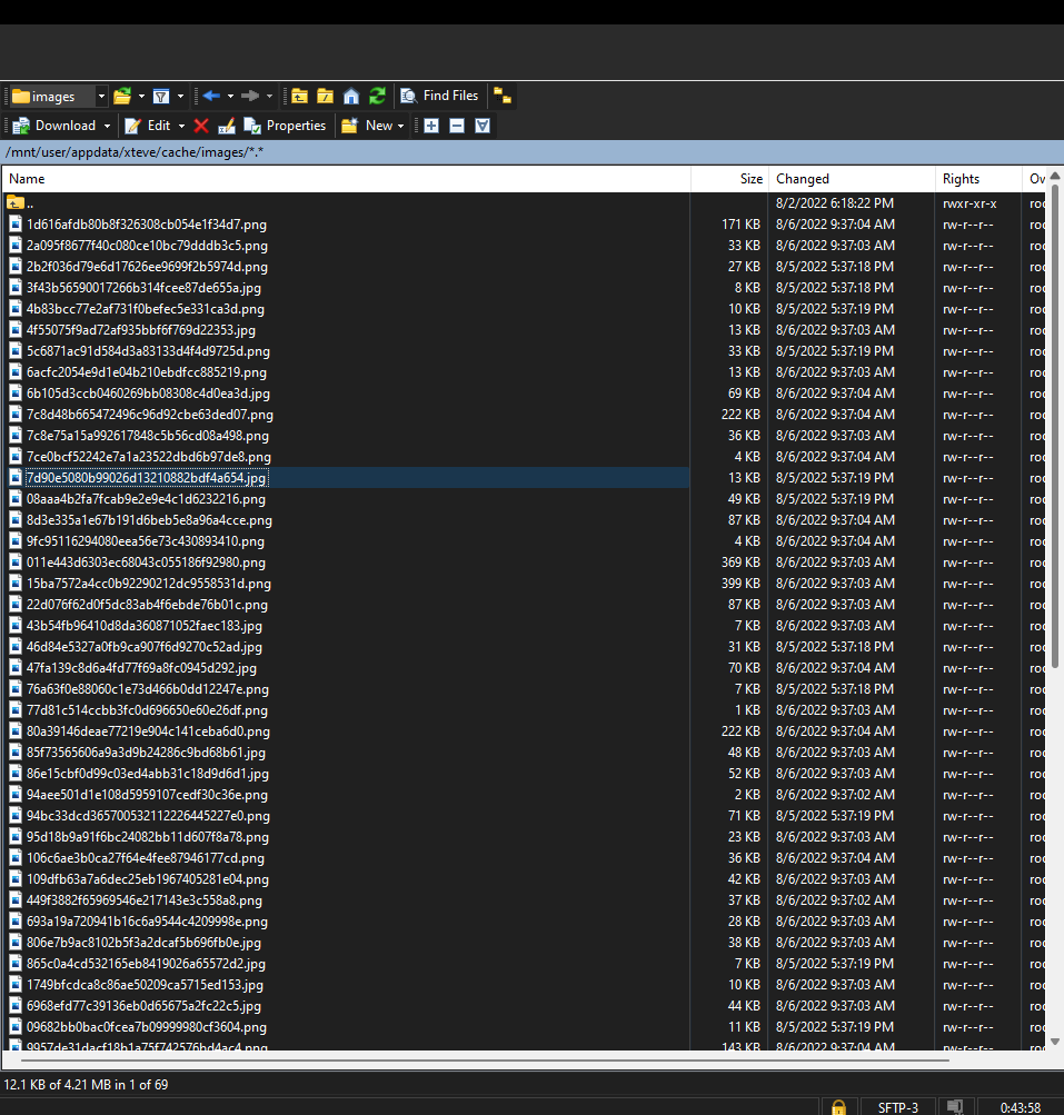

  4. hello im back with an update on my issue .. on the xteve web admin page i go to mapping section and delete the icon link uncheck the channel so is not active anymore and then click on DONE the channel became in red and no icon shown .. but for some reason the changes aren't being saved .. because as soon i hit refresh on the browser the channel name comes back like i didnt changed nothing .. always do the same no mater what channel i try to modify the icon url or something it always go back to the default settings send by the EPG provider thanks

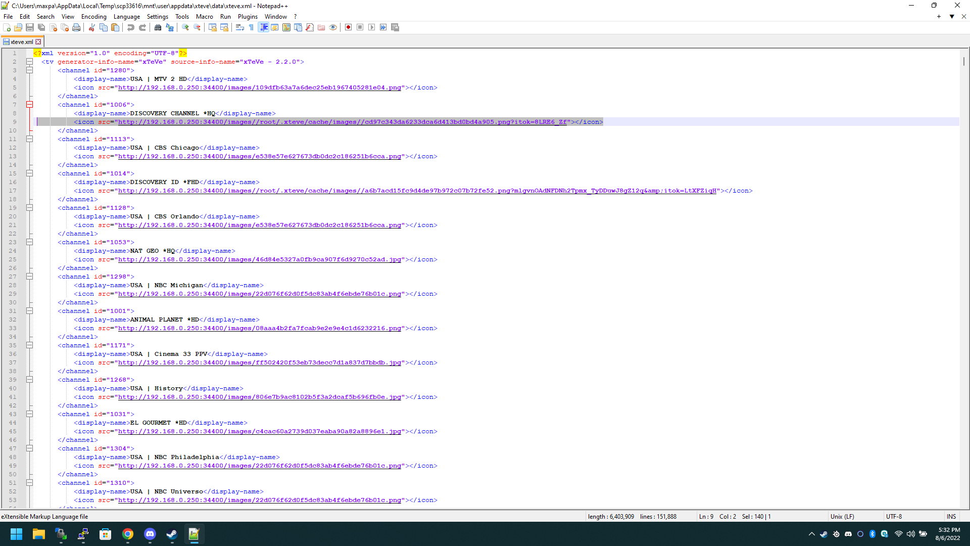

  5. hello you are correct on your thoughts about my issue i will answer as you asked to me and thanks so much for taking time for helping me if its that you are trying to solve, some infos are missing ... = YES xteve and plex on the same mashine ? = YES xteve and plex are running on latest version on unraid server xteve running in host mode as recommended (or at custom br0) ? = YES is running under HOST network type image caching in xteve enabled or not ? = YES buffer in xteve enabled or not ? = No buffer enabled as it says client connects to the streaming server which docker are you using exactly ? = I got this one installed from community applications under unraid apps page Details Application TypeDocker CategoriesMediaApp:Other, Network:Proxy AddedJul 24, 2019 DownloadsMore than 5,000,000 Repository alturismo/xteve DockerHub Stars:20 Last Update:Aug 3, 2021 to start looking into it may a hint, xteve generates a xteve.xml file in the data dir, here are the links which are given to plex as icon source, take a look what you got there if they are reachable from the plex mashine ... i took a loot on the file mentioned ... all images are cached and openning from my local network in this case i was working in my laptop on google chrome tried a few links and all came up to the image logos ... only the one selected on the picture with the //root/.xteve path isnt working they are 10 to be exact but all the rest are working from my local network ill attach the path to the image cached folder on my server to see if it helps a little bit on the matter :*( .. thanks PD: i notice the folder name on the last picture is different from the one on the other picture but i assume is a sym link to the other folder i am guessing that thanks a lot
