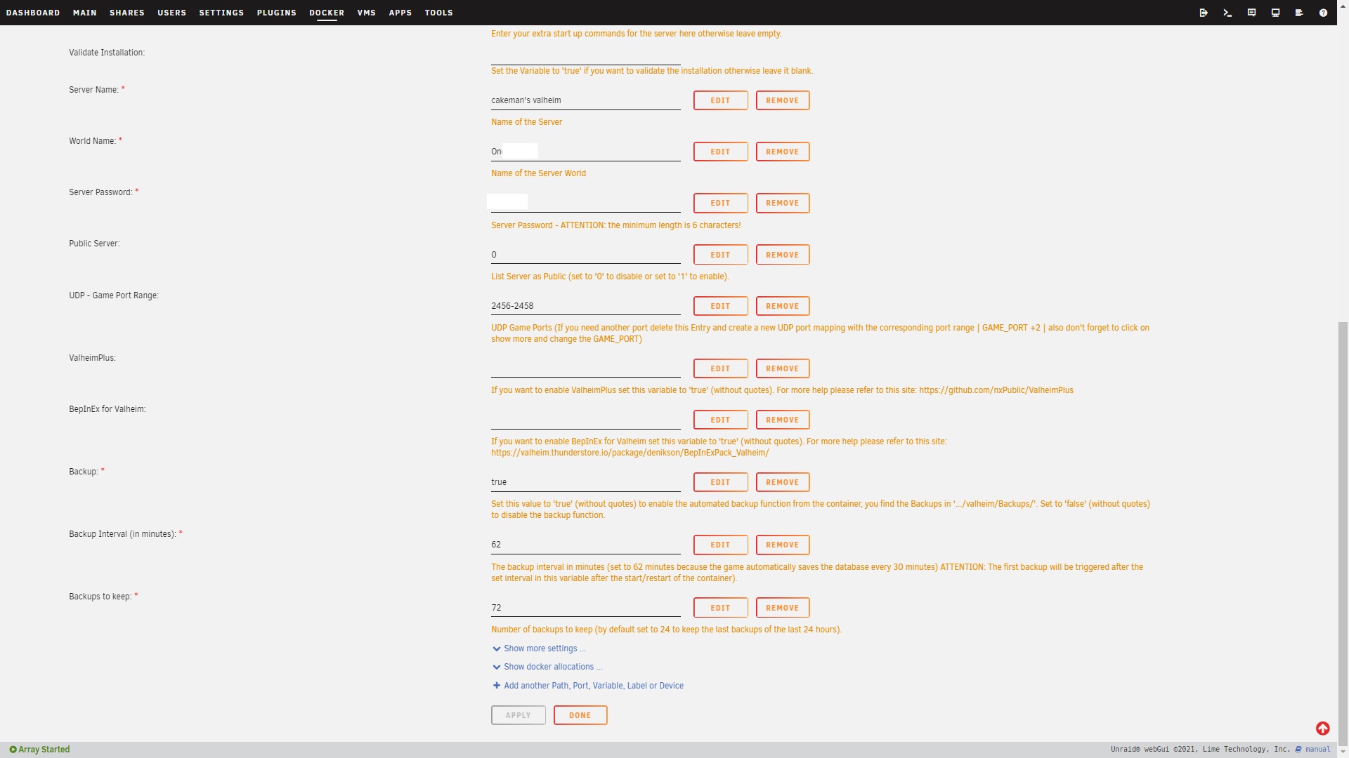

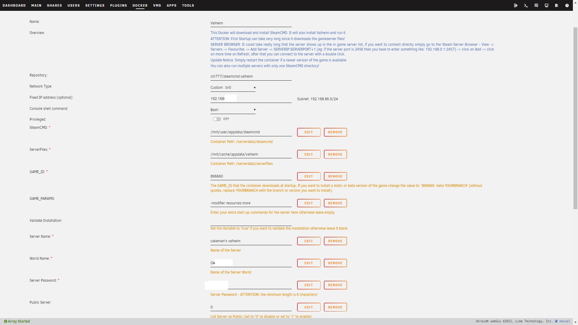

  1. Hi, i was here a couple weeks back after getting my Valheim server up and running for the first time with your docker.. then on a reboot, the whole install was nuked and started fresh somehow. Once i had it up and running again.. it was great for 11 days, until today, when I noticed save file corruption and high memory usage, so I shut down the docker, restarted my NAS and the docker. I know your product has nothing to do with the potential memory leak and save files.. but upon restarting the Docker my entire valheim install was again wiped. I was hoping you could have a quick look through the attached Docker log and see if you recognize a reason why it might have reinstalled everything and wiped me again. That would help me figure out where to start my newbie troubleshooting thanks.. valheim log.txt
  2. Ahhhh, and heres where my 'pretty much a newb to Unraid and Linux' has bit me in the ass, haha. My cache drive failed/unmounted itself last week, before I installed the docker and Valheim server, and I havent got around to fixing it.. and now that I've found some logs in the Steam folder, it seems like maybe this is what happened. From content.log [2023-12-20 17:13:25] Client version: 1702079268 [2023-12-20 17:13:25] Load failed: /serverdata/serverfiles/Steam/steamapps/libraryfolders.vdf. [2023-12-20 17:13:25] Load failed: /serverdata/serverfiles/Steam/config/libraryfolders.vdf. [2023-12-20 17:13:25] Steam library folders configuration will be reset. [2023-12-20 17:13:25] No install folder configuration files found. [2023-12-20 17:13:26] Loaded 0 apps from install folder "/serverdata/serverfiles/Steam/steamapps\appmanifest_*.acf". [2023-12-20 17:13:26] Triggered async write of Steam library folders configuration (1 libraries). [2023-12-20 17:13:32] Client version: 1702079268 [2023-12-20 17:13:32] Loaded Steam library folders configuration: /serverdata/serverfiles/Steam/steamapps/libraryfolders.vdf [2023-12-20 17:13:33] Loaded 0 apps from install folder "/serverdata/serverfiles/steamapps\appmanifest_*.acf". [2023-12-20 17:13:33] Triggered async write of Steam library folders configuration (1 libraries). [2023-12-20 17:13:34] AppID 896660 state changed : Update Required, [2023-12-20 17:13:34] AppID 896660 user config changed : added depots 1006,896661 [2023-12-20 17:13:34] AppID 896660 scheduler update : Priority First, not played for 1 seconds, update disabled for 0 seconds [2023-12-20 17:13:34] AppID 896660 state changed : Update Required,Update Queued, [2023-12-20 17:13:34] AppID 896660 scheduler update : Priority First, not played for 1 seconds, update disabled for 0 seconds [2023-12-20 17:13:34] AppID 896660 config changed : added depots 1006,896661 [2023-12-20 17:13:34] AppID 896660 state changed : Update Required,Update Queued,Update Running, [2023-12-20 17:13:34] AppID 896660 update changed : Running Update, [2023-12-20 17:13:34] AppID 896660 update changed : Running Update,Reconfiguring, [2023-12-20 17:13:34] Got 10 download sources and 0 caching proxies via ContentServerDirectoryService::BYieldingGetServersForSteamPipe (CellID 94 / Launcher 3) [..] It sounds like I should move my ServerFiles path onto the array instead of the cache.. yes? I do see a directory structure with files in it when I browse to that location, but I didnt recognize that the ../cache/appdata/.. was just that .. a temporary cache. derp. Thank you very much for your help.. I'm trying to learn to use Linux/Unraid but theres too much I dont know, haha.
  3. So I got my Valheim server running yesterday with this docker.. I moved my local world into it and put a few hours in. My buddies logged into my 'new to them' world and put a few hours building and exploring and mucking about. I had to shutdown the whole NAS this morning due to some electrical work at my house and I just restarted it. When Valheim docker ran on restart it, as expected, did an update. It seems to have wiped the entire previous install, including my Backups folder and the entire worlds_local folder. I have backups enabled in the docker and its instructed to keep 24 revisions, but the ../Valheim/Backups folder is empty. Is this somehow something I've done or an unfortunate docker error and I should be setting up a backup script?
