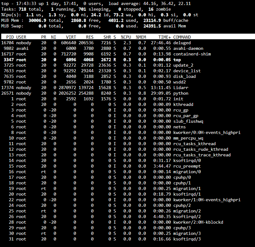

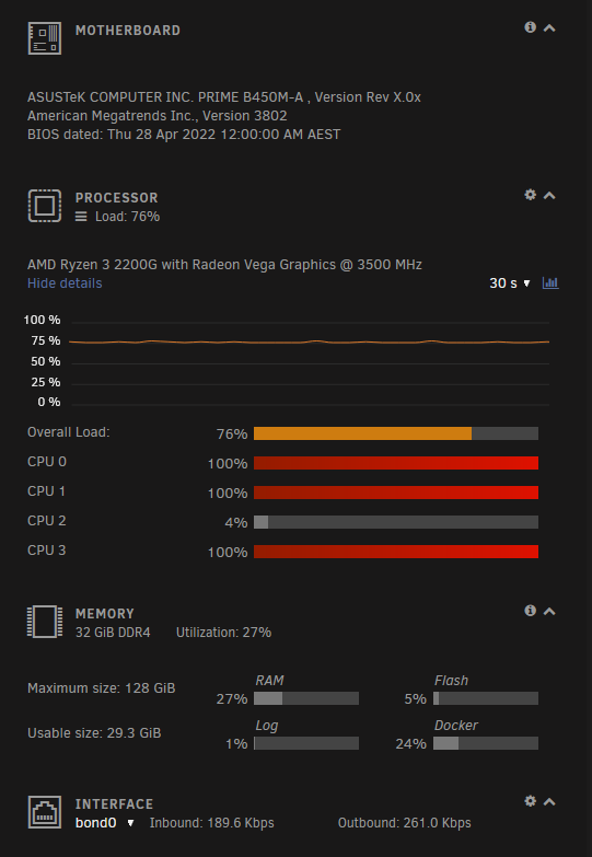

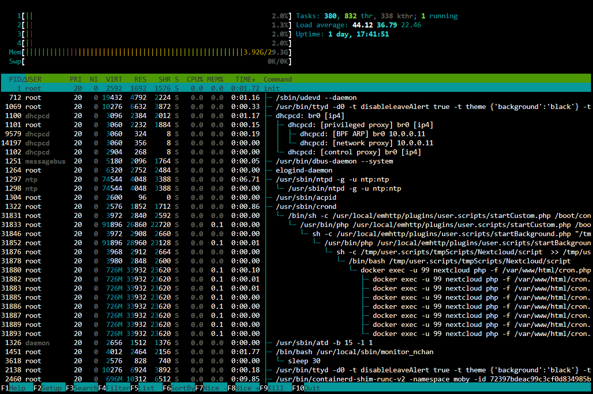

I usually notice it first as my Docker containers become unresponsive. Checking the web UI, 2 or 3 CPU cores will be at 100% but the UI will still work as long as I don't click on the Docker tab. If I leave it for a few minutes or click on the Docker tab, the UI becomes unresponsive and I have to manually restart the server.

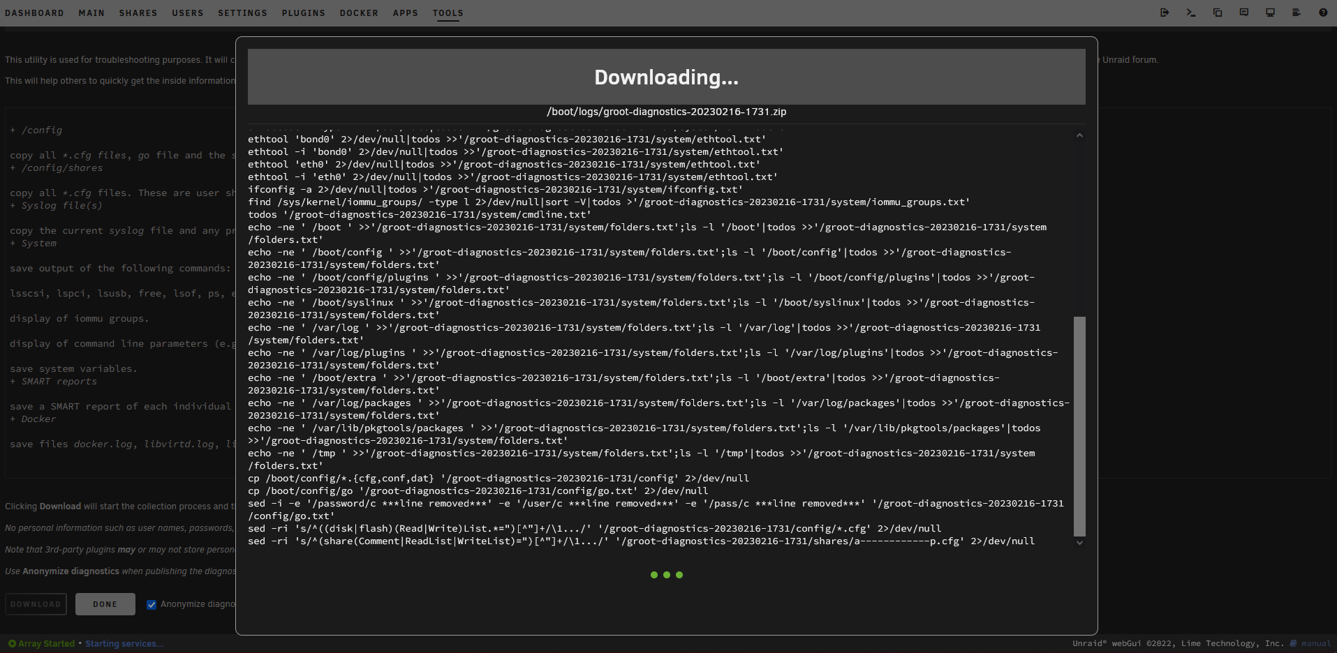

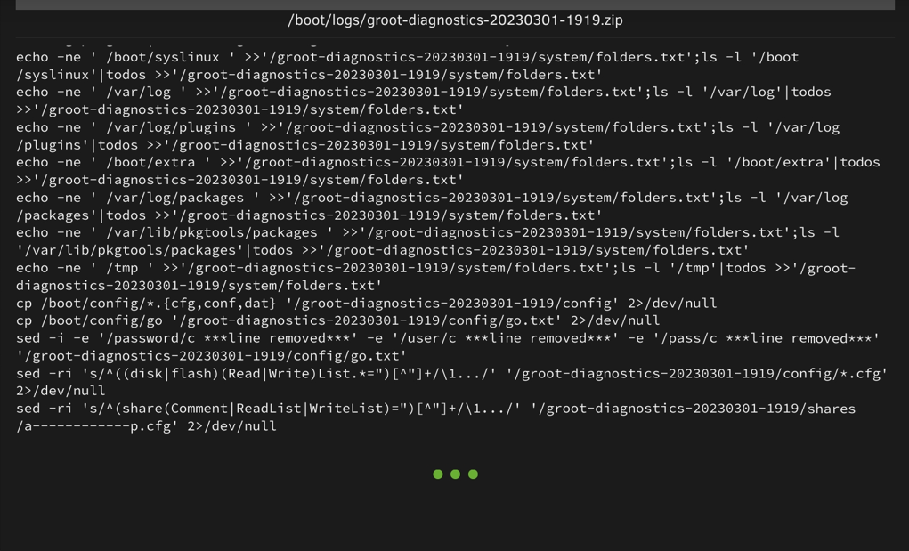

Trying to generate diagnostics fails in the generation process as seen in the attached images. The syslog doesn't contain anything consistent and just stops logging at the time the server becomes unresponsive.

When it happens, what do you get from command line with this?
df -h /

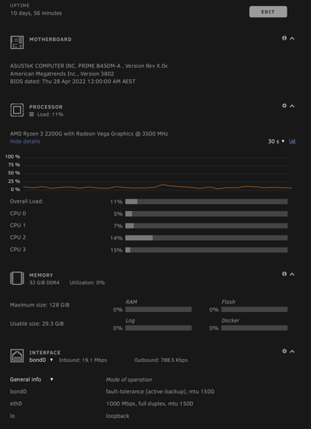

It seems the Shinobi Docker wasn't the root cause. It happened again tonight (after 10 days). It was a slightly different crash this time though. There was no 100% CPU usage and CPU usage appeared to show correctly, updating every second as usual but the RAM, Flash, Log and Docker sections showed 0%. It required a "/sbin/reboot" twice in the console before the server would restart. Here's a screenshot of the dashboard:
At this point, Docker is unresponsive, although my downloads (at 19Mbps) appear to still be transferring. Attempting to generate diagnostics stops at the same spot it did before:
@trurl: Running that command shows this output:
