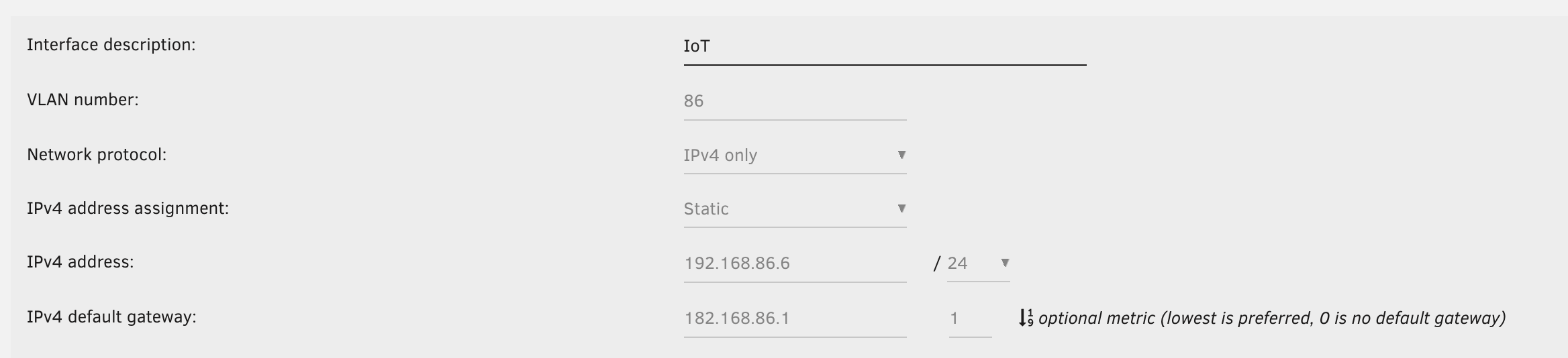

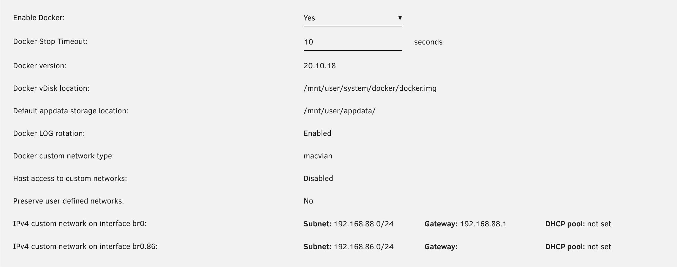

  4. Hi. First of all, thanks for the post. It is very easy to follow and to understand what are you doing. I've followed it and I've made a little reasearch in Internet and I don't understand why is this not working for me. I've created the VLAN and assigned it manually an IP address: But I've seen that the gateway doesn't appears in the docker's settings: As you can see, in the main one it is working correctly and I've containers running, but when I change the container's VLAN I'm not able to access it. The browser says that the site is not accesible. but the container is, apparently, running ok: I don't understand why the gateway doesn't appear in the docker settings. Thanks in advance.
  5. Hi, how you have set the VLAN in Unraid? I've been trying it a few days and I'm not able to create a valid VLAN. Can you share with me yours? By the way, Docker has its own DHCP server, so the best way to solve is to reserve some IP addresses in the router. Regards.
