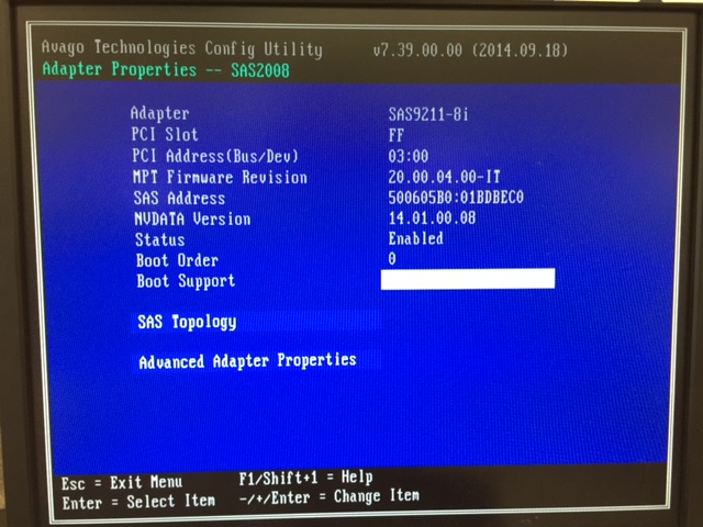

  10. I'm quite confused. I'v got a LSI 9211-8i card and I'm trying to prepare it so I can install it in my unRAID box. I've downloaded 9211-8i_Package_P20_IR_IT_Firmware_BIOS_for_MSDOS_Windows.zip and UEFI_BSD_P20.zip. Do I just need to update BIOS and flash it to IT mode with the firmware, and make sure boot support is disabled in the BIOS and I should be ready to go? Thank you. Edit: OK I think I'm good I'm following the instructions from here. File names appear to be the same but I'm using the P20 (20.00.04) version. http://lime-technology.com/forum/index.php?topic=34081.0 Edit 2: OK I'm set.
