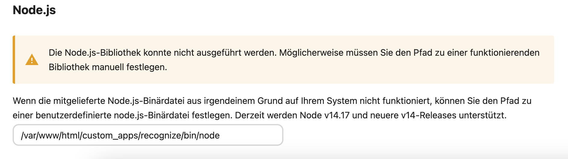

  8. Reinstalling (two times) helped. It seems that Node.js binary was not downloaded completely or could not be decompressed. Thank you very much!
  9. I don't understand. The file seems to exist, but cannot be executed: root@ae995bd20a60:/# /var/www/html/custom_apps/recognize/bin/node -v bash: /var/www/html/custom_apps/recognize/bin/node: No such file or directory root@ae995bd20a60:/# cd /var/www/html/custom_apps/recognize/bin/ root@ae995bd20a60:/var/www/html/custom_apps/recognize/bin# dir node x64.tar.gz root@ae995bd20a60:/var/www/html/custom_apps/recognize/bin# ./node -v bash: ./node: No such file or directory root@ae995bd20a60:/var/www/html/custom_apps/recognize/bin# /node -v bash: /node: No such file or directory root@ae995bd20a60:/var/www/html/custom_apps/recognize/bin# node -v bash: node: command not found
  10. That's strange. It can not be found on me? root@ae995bd20a60:/# node -v bash: node: command not found In the Nextcloud settings you can also set a path to the Node.JS. I just don't know where that should be?
  11. The new version supports object recognition, but requires Node.js. Is there a way to make this work? https://apps.nextcloud.com/apps/recognize https://nextcloud.com/blog/press_releases/nextcloud-hub-3-release-ai-photos/
