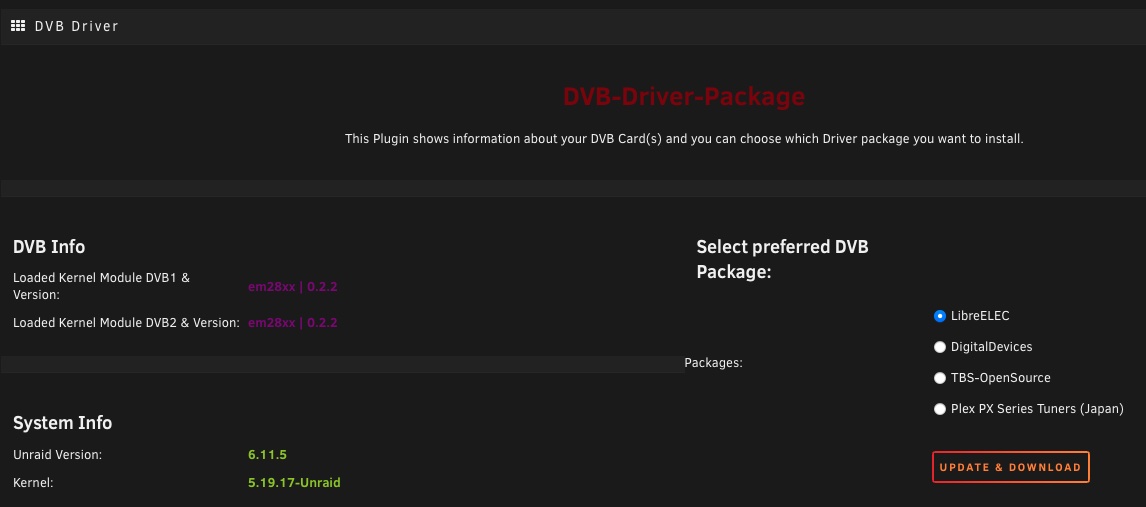

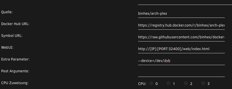

  14. Wow, thank you very much, I would probably never have thought of that.
