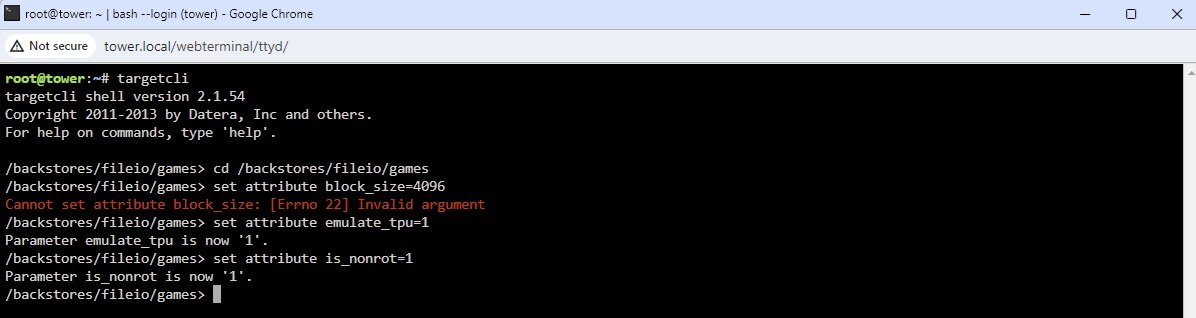

  1. those commands were the answer, thank you very much. I am getting the full speed my network can provide so i wasnt looking forward to going back to smb shares again.

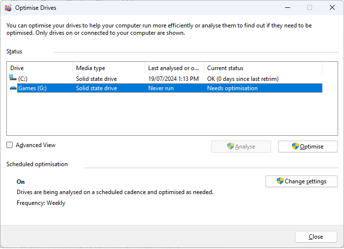

  2. thanks for the reply, its not a VM , its a bare metal pc on the local network in need of a steam drive. I created a fileio img so i assume thats why the block_size command fails? Ill reboot the pc and see if windows see it as thin provisioned or as an ssd.
  3. afternoon, This may be impossible but ive created a fileio img on my unraid cache ssd. I dont have a whole drive to use as a block device. How do i manage TRIM in widows 11? At the moment the iscsi disk shows as a HDD in the optimise drives window. If i add then delete a large file the space is not reclaimed on unraid, even after running trim now from the scheduler tool in settings. Am i missing something? Cheers
