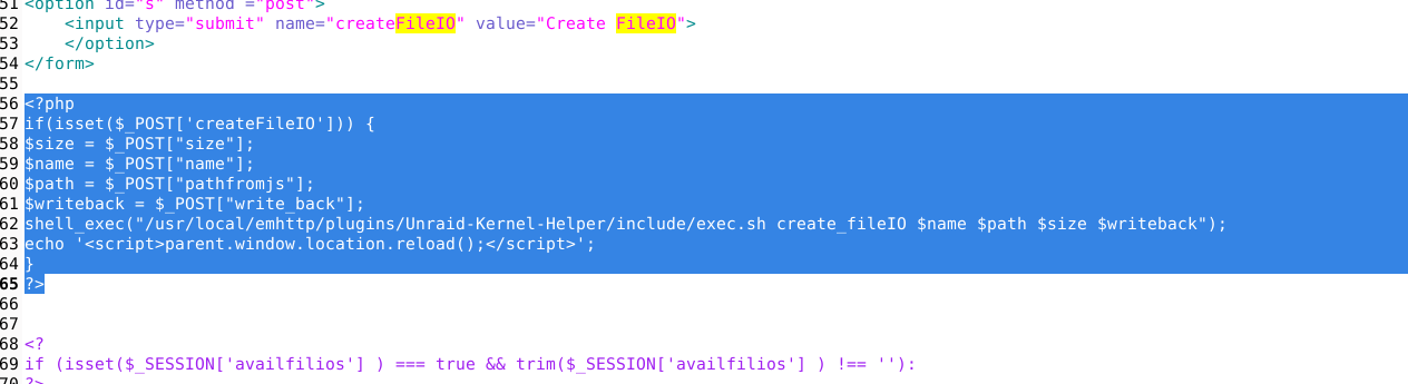

yeah it was that and also the config location was wrong
also it needed an initiator name for the machine which might need to be part of the setup that it creats a standard one automatically.

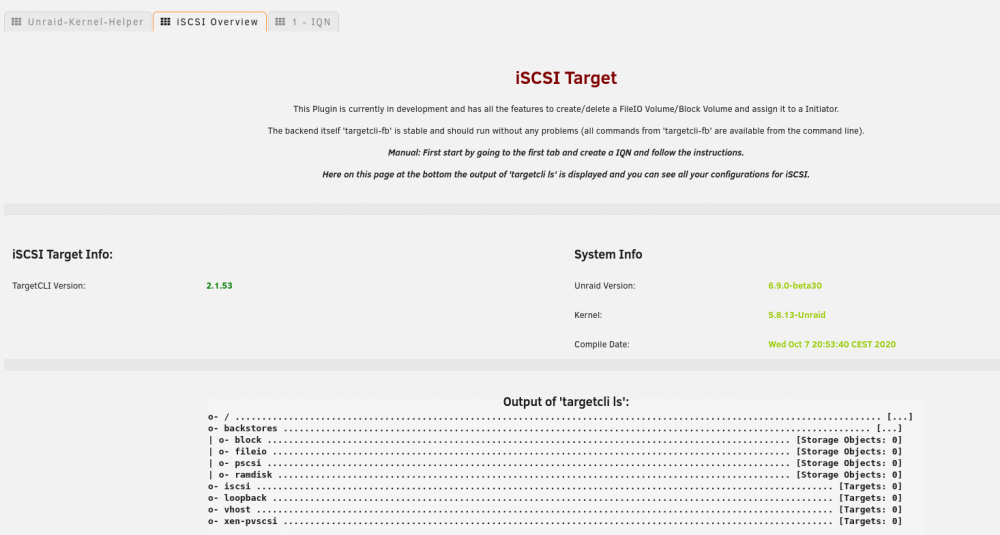

Can you please be a little bit more specific what is throwing errors and when, never got a problem in the GUI or does this happen when you install this plugin?
You know that the Unraid-Kernel-Helper has now support for iSCSI and you can create Targets?
it is when it is initially installed and it didn't create the config file, it was looking for it and when i manually put it in that place it worked but of course the buttons don't work yet and unsure if the queries work as it is not showing the initiator that i created manually in the plugin.
i will have a look at the files today and adjust them for what we need, thanks for your help.

No, it's the Unraid-Kernel-Helper-Plugin on the CA App.
It will show you your targets, drives (now limited to FileIO and Block Targets),...

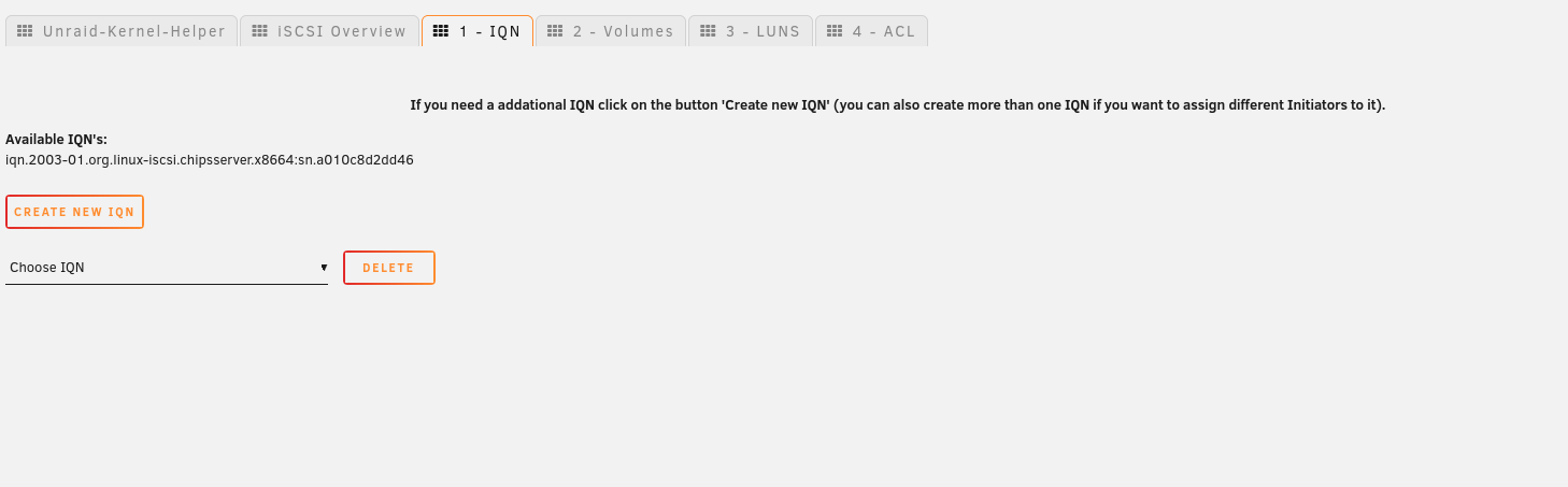

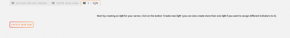

no the plugin does not create the config file at all, i have modified it so if the config does not exist then it will create it.

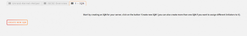

Oh my god, you saved my life, I had a bug in the Kernel-Helper-Plugin if no IQN was found the IQN page wouldn show up, now it should be fixed after a plugin update:
EDIT: After you created a IQN the other tabs will show up. ;)

Thank you, I replaced the working version with a non working version... :D
@Joedy The plugin is now working but you have to delete it from your plugins and install it new through the CA App.
That happens when you migrating something newer to something older... :P

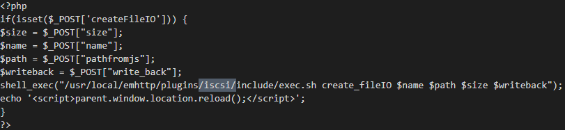

The pathway to run the script when creating an iqn is wrong
we are pushing the change to you to fix this
also the IQN does not show up under the IQN tab when created only the overview page is this by design?
if your plugin is working and ours isnt seems we have issues with the paths that you are using in the files it is not standard like
should be unraid-kernel-helper and this is across quite a few lines of code.

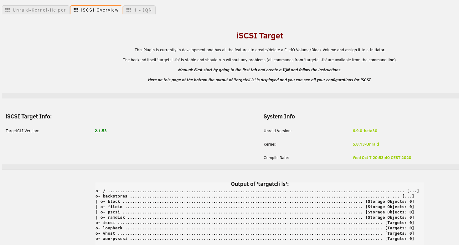

Sorry but you still have the old version of the plugin the new version looks like this:

The code is not very beautiful but it's the best I can do, never learned any webcoding...
thats ok we are looking at it now and will push any changes and you can decide if you want it or not
