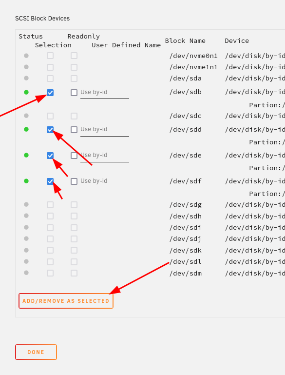

Hy All
Urgent question (My Production is offline due to changes, and this is one of them):
I ran my Unraid NAS on Dell R730XD and changed to HW raid to use device block instead of FileIO.
My problem is I see the 3 volumes, but I'm unable to add them as storage lun.
Unraid doesn't let me tick just one of them, only the three together, and he gives a wait msg for 2-3 sec and doesn't add them.
I need the help urgently so I can start restore the lost data from my backups.

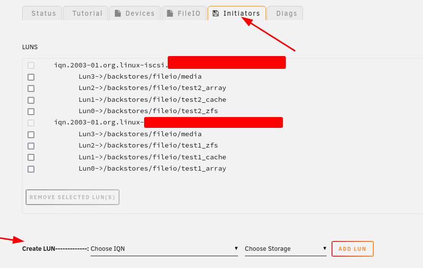

You have to assign them here:
You should be always be able to add them as a storage pool here:

Not working. I added a FileIO container (or whatever it's called) of 500GB. Done. Then I created a target using that file, created a LUN using that target, and used the iSCSI Initiator panel in Windows 10 to connect to it. Host is found, LUN is found, but when I connect to it, it just says `Unable to Login to the target.`
No further information appears to be available.
I don't know what to do next.
Also could you, author, please read your own tutorial? It's really difficult to follow, because it's written quite poorly. Not just typos and grammar errors (which to me stand out like a thorn), but also skipping over things as if to assume the user knows everything about it already. I guess it just needs some love, and love is not what it's gotten so far.

  | | | o- alua ................................................................................................... [ALUA Groups: 1]
  | | |   o- default_tg_pt_gp ....................................................................... [ALUA state: Active/optimized]
  | | o- test2_cache .................................. [/mnt/disks/misc_cache/iSCSI/test2_cache.img (50.0GiB) write-back activated]
  | | o- test2_zfs ....................................... [/mnt/disks/misc_cache/iSCSI/test2_zfs.img (5.0GiB) write-back activated]
  | o- pscsi .................................................................................................. [Storage Objects: 0]
  | o- ramdisk ................................................................................................ [Storage Objects: 0]
  o- iscsi ............................................................................................................ [Targets: 2]
  | o- iqn.2003-01.org.linux-iscsi.chipsserver.x8664:test.1 .............................................................. [TPGs: 1]
  | | o- tpg1 ............................................................................................... [no-gen-acls, no-auth]
  | |   o- acls .......................................................................................................... [ACLs: 1]
  | |   | o- iqn.2005-08.net.unraid:test.1 ........................................................................ [Mapped LUNs: 4]
  | |   |   o- mapped_lun0 .......................................................................... [lun0 fileio/test1_array (rw)]
  | |   |   o- mapped_lun1 .......................................................................... [lun1 fileio/test1_cache (rw)]
  | |   |   o- mapped_lun2 ............................................................................ [lun2 fileio/test1_zfs (rw)]
  | |   |   o- mapped_lun3 ................................................................................ [lun3 fileio/media (ro)]
  | |   o- luns .......................................................................................................... [LUNs: 4]
  | |   | o- lun0 ............................ [fileio/test1_array (/mnt/disks/misc_cache/iSCSI/test1_array.img) (default_tg_pt_gp)]
  | |   | o- lun1 ............................ [fileio/test1_cache (/mnt/disks/misc_cache/iSCSI/test1_cache.img) (default_tg_pt_gp)]
  | |   | o- lun2 ................................ [fileio/test1_zfs (/mnt/disks/misc_cache/iSCSI/test1_zfs.img) (default_tg_pt_gp)]
  | |   | o- lun3 ........................................ [fileio/media (/mnt/disks/misc_cache/iSCSI/media.img) (default_tg_pt_gp)]
  | |   o- portals .................................................................................................... [Portals: 1]
  | |     o- 0.0.0.0:3260 ..................................................................................................... [OK]
  | o- iqn.2003-01.org.linux-iscsi.chipsserver.x8664:test.2 .............................................................. [TPGs: 1]
  |     | o- iqn.2005-08.net.unraid:test.2 ........................................................................ [Mapped LUNs: 4]
  |     |   o- mapped_lun0 ............................................................................ [lun0 fileio/test2_zfs (rw)]
  |     |   o- mapped_lun1 .......................................................................... [lun1 fileio/test2_cache (rw)]
  |     |   o- mapped_lun2 .......................................................................... [lun2 fileio/test2_array (rw)]
  |     | o- lun0 ................................ [fileio/test2_zfs (/mnt/disks/misc_cache/iSCSI/test2_zfs.img) (default_tg_pt_gp)]
  |     | o- lun1 ............................ [fileio/test2_cache (/mnt/disks/misc_cache/iSCSI/test2_cache.img) (default_tg_pt_gp)]
  |     | o- lun2 ............................ [fileio/test2_array (/mnt/disks/misc_cache/iSCSI/test2_array.img) (default_tg_pt_gp)]
  o- loopback ......................................................................................................... [Targets: 0]
  o- vhost ............................................................................................................ [Targets: 0]
  o- xen-pvscsi ....................................................................................................... [Targets: 0]
