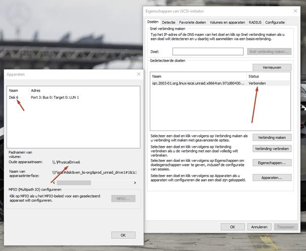

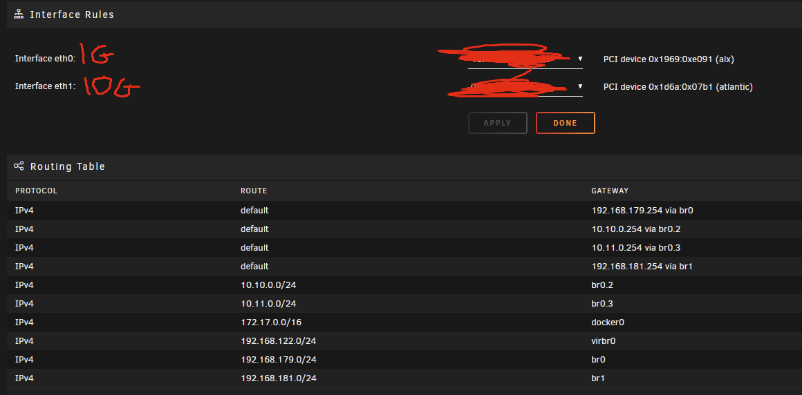

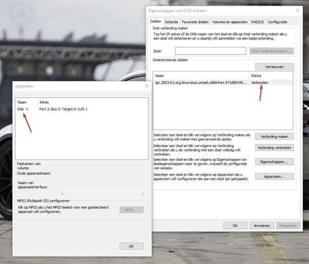

I'm having an issue with this:
I have 2 network cards, 1 is the main 1GbE connection (home network and others (VLAN's) are all connected to this), the other is a 10GbE connection (peer 2 peer pc-server).
The issue I am having is that when I try to connect via the 10GbE it connects, but doesn't seem to load in the disks, and makes the whole service just lock up (I actually need to restart my PC to get it to work).
Does anyone have an advise what to do? (Is there maybe a way to lock ISCSI to an IP or interface?)
btw: My firewall is also a vm which has access to both networks.
See the differences in the pictures (verbonden means connected)

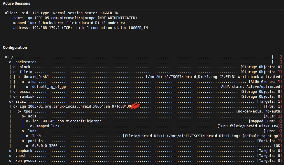

12 minutes ago, ich777 said:
Please also post a picture from the overview from the iSCSI plugin where the configuration is visible.
This is a picture with it now connected to 1GbE:

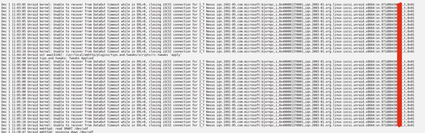

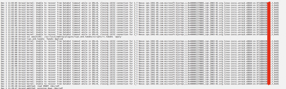

So yesterday I got it all working, and seems to work quite good, except that I get these messages in my log:
Any idea what this is?
Is the Initiator still working, so to speak the client side or does it freeze?
Does this happen all the time or only on heavy writes?
Usually this means that the Initiator sends too much data to the Target who can't handle it in time.

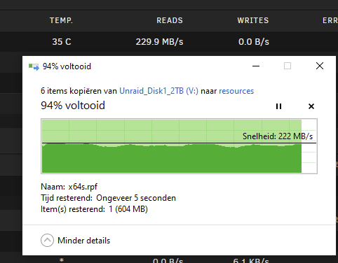

In addition to that I also noticed this happening while copying ~8GB files:
Notice the 'hills' created, swerving from 15MB/s upto 375, while the disk can do around 160-200MB/s
It seems to be a bit 'stuttery' pushing all the data trough:
Edited by maxstevens2
It seems to write data onto the image, write onto the actual disk, then gets hung up due to the upload speed being too much, then de disk is ready (goes to 0MB/s) and then the upload goas upto 400MB/s again.

Well the weird thing is (that I saw with iotop on unraid), see screenshot after this quote:
"Actual Disk Write 0 B/s", while on the picture before the quote it was running at 165MB/s (while probably exhausting buffer).
