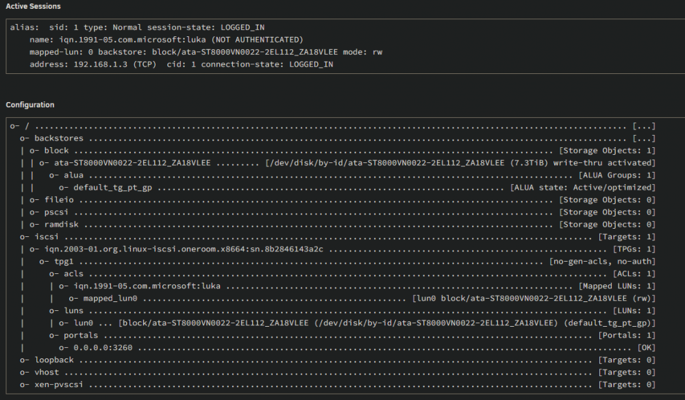

35 minutes ago, ich777 said:
Looking good to me, here is a screenshot from my system:
I don't think that's necessary, I see you are trying to connect from a Linux initiator, maybe you have to turn off Authentication on that system or turn it on in iSCSI (but you have to do that through the command line if you really want to), for home use I would recommend to turn off Authentication.
It stopped working over night, not sure if there was an unraid update or an windows update before it happened.
Still, no matter what I try, Windows10 says "Authorization Failure"
  • Replies 480
  • Views 127.2k
  • @gingerdude & @dreadu & @isvein please update the plugin to version 2022.11.06 and the issue should be fixed.
  • I just wanted to say thank you for the plugin. For the first time yesterday I was able to boot from efi using ipxe and then network boot with iscsi as the disk. The plugin is going to make experimenti
  • I have added zfs support.   Example command if you want to create a block device to be used for iSCSI    zfs create -V 1G zfs/vol1

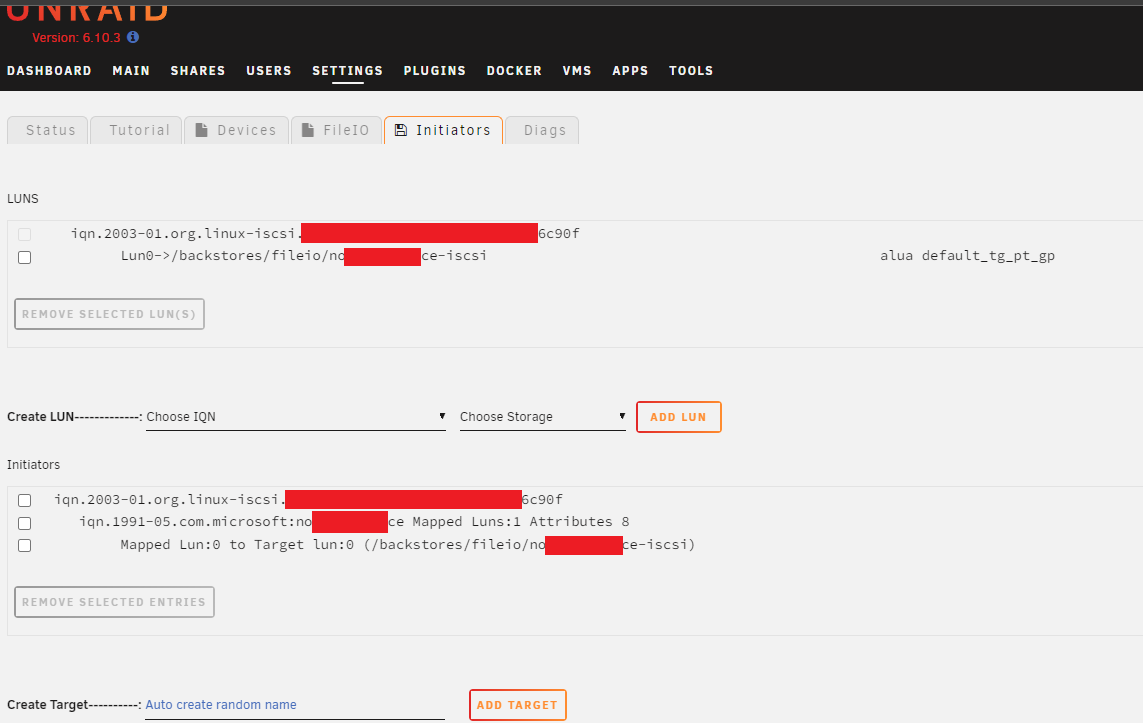

Look at your acls there is a IQN in there with "linux" and you say that you want to connect from Windows, there is something wrong with your config.
Windows usually has "microsoft" in there not "linux".
There we go :D
I had to map the LUN to the remote IGN (windows pc) (Under Settings-->Iscsi-->initiators-->Create IQN)
I cant remember I had to do that before tho, has there lately been an iscsi update that require you to do this manually? Or maybe the config for it dropped during one of the rc updates.
Edited by isvein
To both things no...
Seems like something messed up your config, but I don't think this was caused by an RC update or something like that.
Who knows, I guess we never find out, but Im glad its working now and if the same happens again I know where to start :)
Thanks for the help.

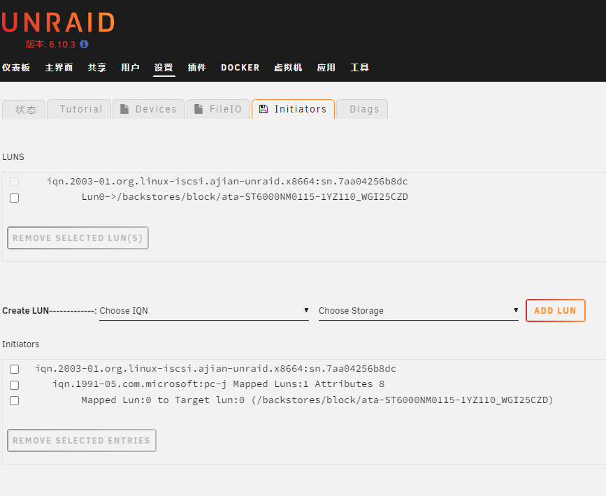

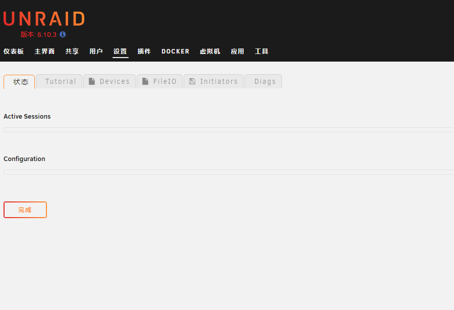

在unraid系统6.10.3下更新iscsi插件到2022.04.22版本,pc上没有iscsi链接。查看插件状态栏什么都不显示,安装栏内已有信息无法删除,移除iscsi插件并删除U盘插件内容后,重新安装,硬盘无法选择,安装栏没有信息。

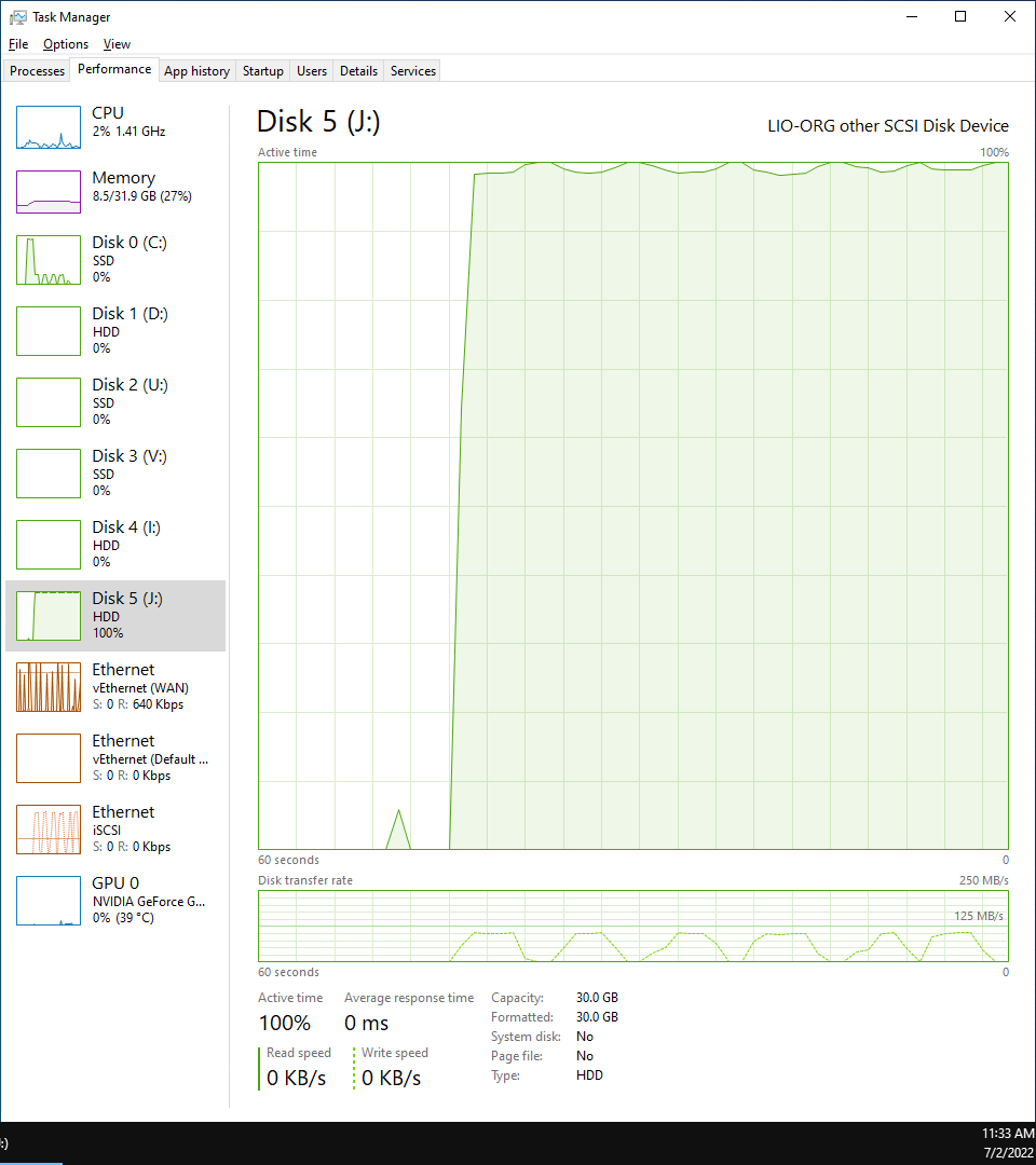

Hey !
Firstly, sorry for my bad english.
Today, I want use iSCSI on unraid for my steam and origin library.
With SMB sharing, no problem, I've continues between 110 - 113mo/s transfer rate.
With iSCSI, it's very strange. My transfer rate fall to 0mo/s during 3-4 sec, and go to 110mo/s during 3-4 sec... My disk in use 100%...
My problem it's for write data, when I read data the transfer rate is good.
I haven't see a similar problem on this topic. Have you an idea ?
Edited by nolhan6417
forgot important information of my problem
How is your target defined? is it a drive, fileio?
It's a fileio.
add screen
On 6/28/2022 at 12:55 AM, SimonF said:
您可以发布屏幕截图吗?
升级到最新版后,状态栏空白,安装栏里内容无法删除。PC上无iscsi链接,无法连到磁盘
Can you provide the output for:, It works for me on 6.10.3 and current version. Also does targetcli work for you?
root@Tower:~# ls -l /root/.targetcli/prefs.bin
lrwxrwxrwx 1 root root 39 Jul  3 07:35 /root/.targetcli/prefs.bin -> /boot/config/iscsi/.targetcli/prefs.bin
root@Tower:~# ls -l /etc/target/saveconfig.json
lrwxrwxrwx 1 root root 34 Jul  3 07:35 /etc/target/saveconfig.json -> /boot/config/iscsi/saveconfig.json
root@Tower:~# targetcli ls
o- / ......................................................................................................................... [...]
  o- backstores .............................................................................................................. [...]
  | o- block .................................................................................................. [Storage Objects: 0]
  | o- fileio ................................................................................................. [Storage Objects: 2]
  | | o- UNRAID .................................................... [/mnt/user/pxeboot/UNRAID.img (20.0GiB) write-back deactivated]
  | | | o- alua ................................................................................................... [ALUA Groups: 1]
  | | |   o- default_tg_pt_gp ....................................................................... [ALUA state: Active/optimized]
  | | o- unraidboot ................................................................ [unraidboot.img (20.0MiB) write-back activated]
  | o- pscsi .................................................................................................. [Storage Objects: 0]
  | o- ramdisk ................................................................................................ [Storage Objects: 0]
  o- iscsi ............................................................................................................ [Targets: 1]
  | o- iqn.2003-01.org.linux-iscsi.tower.x8664:sn............. ........................................................... [TPGs: 1]
  |   o- tpg1 ............................................................................................... [no-gen-acls, no-auth]
  |     o- acls .......................................................................................................... [ACLs: 1]
  |     | o- iqn.1991-05.com.microsoft:desktop-xxxxxxxx............................................................ [Mapped LUNs: 1]
  |     |   o- mapped_lun0 ........................................................................... [lun0 fileio/unraidboot (rw)]
  |     o- luns .......................................................................................................... [LUNs: 1]
  |     | o- lun0 .......................................................... [fileio/unraidboot (unraidboot.img) (default_tg_pt_gp)]
  |     o- portals .................................................................................................... [Portals: 1]
  |       o- 0.0.0.0:3260 ..................................................................................................... [OK]
  o- loopback ......................................................................................................... [Targets: 0]
  o- vhost ............................................................................................................ [Targets: 0]
  o- xen-pvscsi ....................................................................................................... [Targets: 0]
root@Tower:~# targetcli -v
/usr/bin/targetcli version 2.1.54
root@Tower:~#
6 hours ago, SimonF said:
root@Tower:~#
2.1.54版本可以正常在unraid6.10.3上运行,升级至2022.04.22后出现问题。
1 hour ago, laidou said:
Does cat /etc/target/saveconfig.json show your saved config?

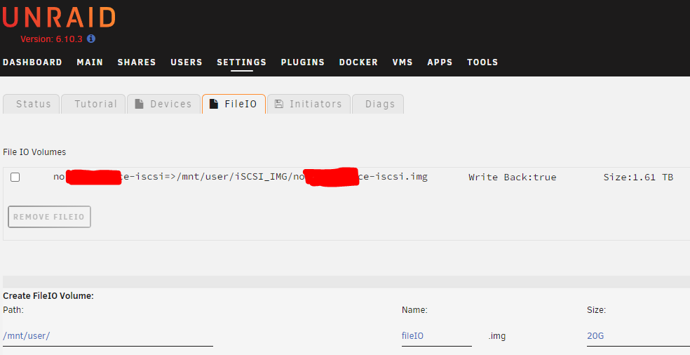

if you run targetcli restoreconfig does that restore you config?
It seems that I cannot remove the fileio because the button is greyed out. Everything else can be removed though.
I'm using unraid 6.10.3. Thanks
Edited by zxhaxdr
Working ok on my machine, but I will continue to see if I can recreated.
What I remember I did is. If I remember, at first, it does work, however it doesn't really delete the img under the /mnt. So I manually removed the .img and created another fileio. Since then, the button is forever greyed out.
BTW, I didn't create the fileio under /mnt/user but under ZFS /mnt/**pool like that.

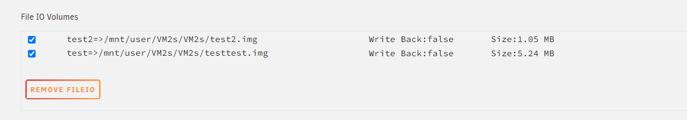

The button enables as soon as you click on a check box, doesn't check any physical files/locations. This will just be processed by the local browser, maybe close your browser and try again?
Thank you for the reply. Still doesn't work. Even in the incognito mode. Maybe the frontend isn't rendered properly. I removed the plugin and reinstalled but that doesn't help. At some point it's broken, and it's broken forever. I will look into in to get more info sometime.
Edited by zxhaxdr
@zxhaxdr It is working fine on all of my machines.
you can edit this line echo '<input id="removeFileIO" disabled type="submit"  value="'._('Remove Fileio').'" onclick="removeFIO();" '.'>';
in (around line 170)
/usr/local/emhttp/plugins/unraid.iSCSI/include/ISCSI.php
and remove the disabled word to get it to work. If you run your browser in debug(F12) do you see any errors on the console.
Edited by SimonF
I have found the problem.

  var matches = document.querySelectorAll("." + this.className);
  for (var i=0, len=matches.length|0; i<len; i=i+1|0) {
    matches[i].checked = this.checked ? true : false;
  $("#removeFileIO").attr("disabled", false);
method querySelectorAll() throws exception
Uncaught DOMException: Failed to execute 'querySelectorAll' on 'Document': '.000test' is not a valid selector.
    at HTMLInputElement.<anonymous> (<anonymous>:3:26)
See the fileIO name is 000test and it seems it desen't like digits in the front. Other name formats are fine, e.g., test or test_test.
So I think we need to regulate the class name by adding a prefix or something.
Cheers
Edited by zxhaxdr
In,
$("#ft1 input[type='checkbox']").change(function() {
Cheers
Thanks for letting me know, will look to see if I can fix that in a future release.
In,
Cheers
targetcli crashes also so need to make sure name starts with an alpha.
