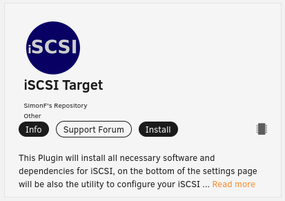

You've posted already in the correct support topic.
iSCSI Target:
iSCSI Target:
iSCSI GUI too? or just iSCSI target
No drivers, nothing special, just this and im done, right?
Thanks
Where do you find iSCSI GUI in the CA App?
The only app you need is iSCSI Target.
I go by the name of this thread, iSCSI GUI and iSCSI Target, so i assumed its 2 plugins
