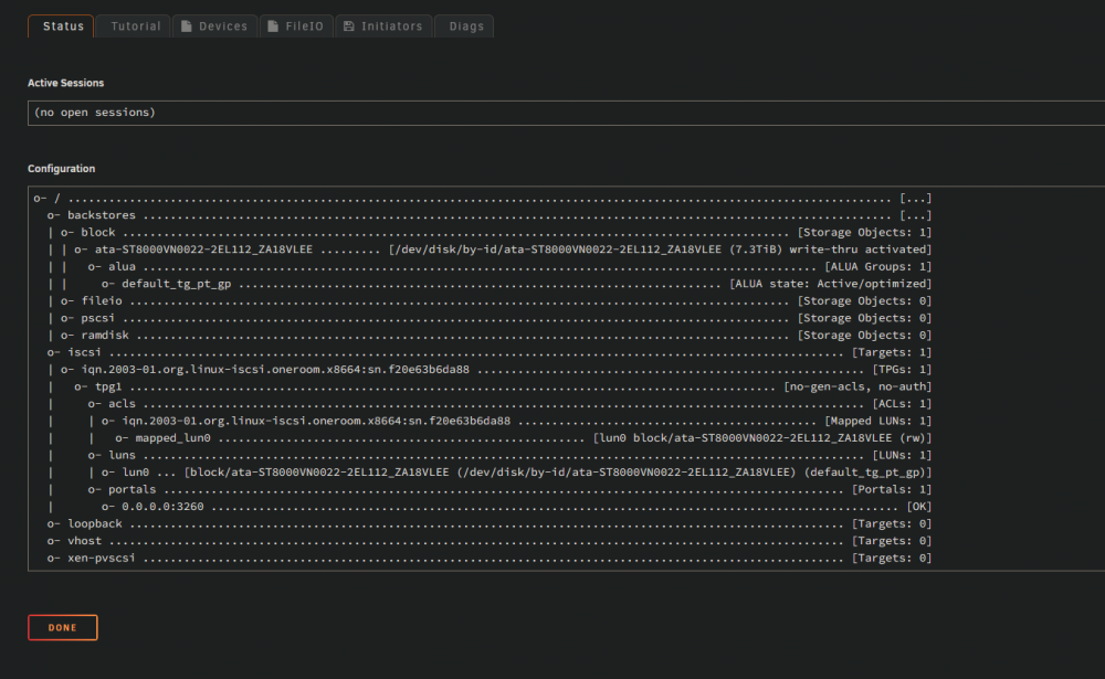

Suddenly windows wont connect to my iscsi drive that worked fine before.
Windows say "Authorization Failure"
I tried to remove and reinstall the plugin.
Running Unraid 6.10 rc8
Tried to remove all settings on both Unraid and Windows now, when I use quick connect in windows it says "Unable to login to the target"
Diag taken after I tied this.
oneroom-diagnostics-20220517-0830.zip
Sorry for the delay... Forgot a bit about that...
I've test it now and I can connect with any issue whatsoever.

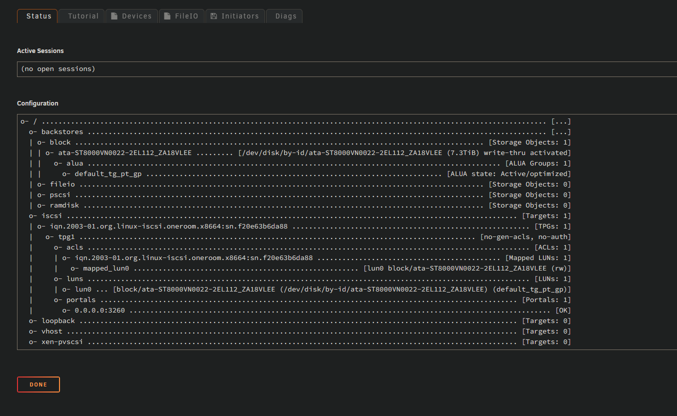

Can you share a screenshot from your configuration on the main iSCSI page?
Is it supposed to say "iSCSI target portal group: 1"?
Or should it be group 0?
Is there some files that are not deleted when removing the plugin, because if there is some files I can delete I can try to reset it all 100% and try again and see if that helps.
Looking good to me, here is a screenshot from my system:
