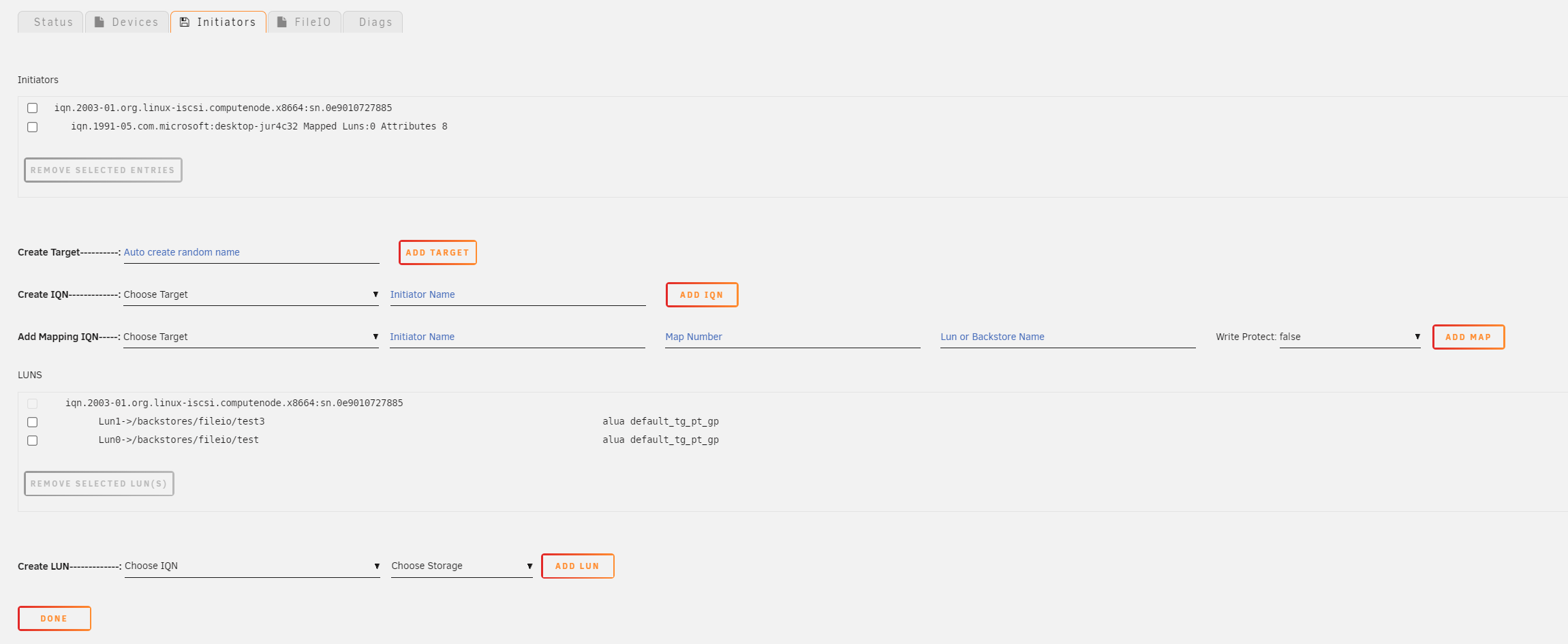

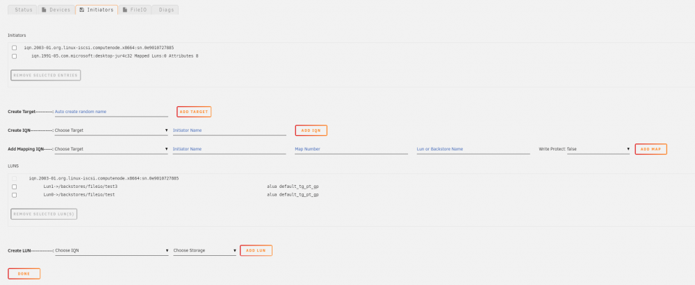

I'm at a loss on how to set this up.  I muddled my way through the other UI setup you all had.  The new one is less straightforward.  Got everything done except for the Add Map step on the Initiators page.  What actually goes into the fields?  Why are these not pre-populated or drop downs from the data that exists elsewhere in the plugins?  I have no idea what format the Lun or Backstore name should be to enter into this form? Is there a set of screenshots where someone shows what those entries should look like?
Actually I dug into the code and found the issue.  The command to add a mapping is populated incorrectly from the UI.  The command that is generated during the Mapping process when using the UI has the word "typename" where it should contain the Lun ID (ie "lun0").  Hence the command will fail every time.   No wonder I was confused.
Had you created the LUN?
Everything was created beforehand.  I now realize it's because the formatting for that Lun Id field is "fileio:test3".  I was trying everything like "lun0" "backstores/fileio/test3" etc.  I just needed to see the fields completed in an example to understand what to do.

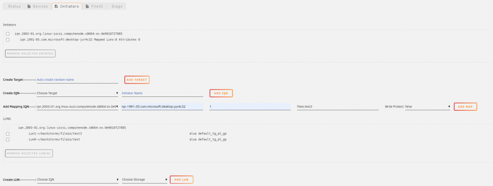

I created initiator and LUN from fileIO, but client on macOS asks for CHAP details, when I enter username and password from unRAID, I get a message that the password must be 12 to 16 characters. And it is impossible to disable it.
client: DAEMON tools
macOS: 11.5.2 (20G95)
unRAID: 6.9.2
When I create such an initiator on the Synology NAS, everything works without any problems.

you need to create  the acl and mapping also.
 o- iqn.2003-01.org.linux-iscsi.computenode.x8664:sn.0e9010727885 ..................................................... [TPGs: 1]
  |   o- tpg1 ............................................................................................... [no-gen-acls, no-auth]
  |     o- acls .......................................................................................................... [ACLs: 1]
  |     | o- iqn.1991-05.com.microsoft:desktop-jur4c32 ............................................................ [Mapped LUNs: 0]
  |     o- luns .......................................................................................................... [LUNs: 2]
  |     | o- lun0 ...................................................... [fileio/test (/mnt/user/iscsi/test.img) (default_tg_pt_gp)]
  |     | o- lun1 .................................................... [fileio/test3 (/mnt/user/iscsi/test3.img) (default_tg_pt_gp)]
  |     o- portals .................................................................................................... [Portals: 1]
  |       o- 0.0.0.0:3260 ..................................................................................................... [OK]

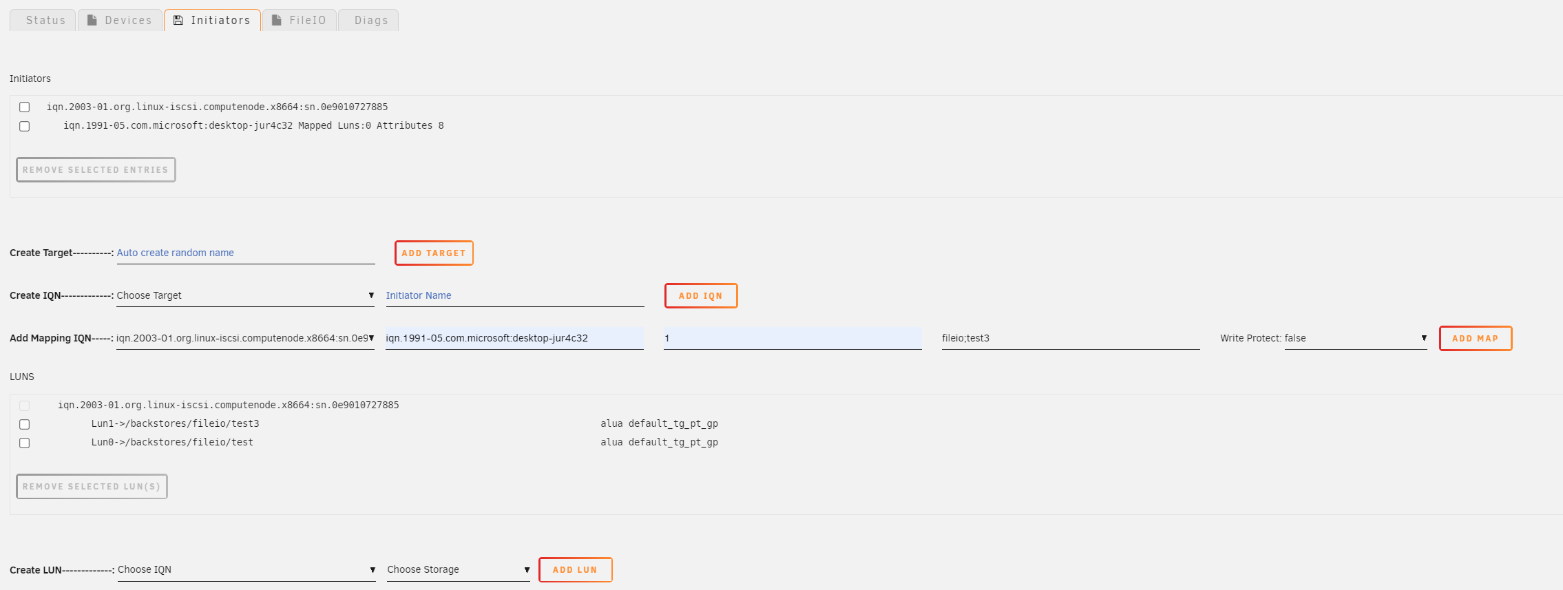

Thanks for the answer, how to do this? Or where can I find information about this?
On the Initiators tab add the IGN for your MAC and add the mapping.
32 minutes ago, SimonF said:
On the Initiators tab add the IGN for your MAC ...
Wow! Works!
Many thanks,
didn’t know it needed to add the name of the initiator. This is not required at Synology.
Edited by XiMA4

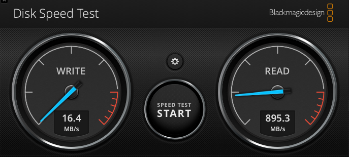

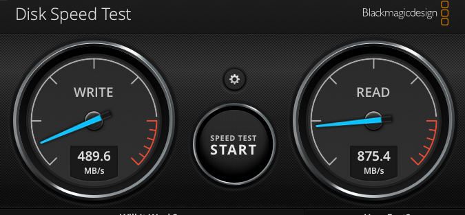

Disastrously low write speed
is it ok for iSCSI Target on unRAID?
I am using FileIO 300GB in Array.
Edited by XiMA4
Do you have Write Back enabled? If not make sure it's enabled.
This is a really common thing with iSCSI and has nothing to do with unRAID. ;)
I run my NVME with a 10Gbit NIC and have no problem reaching 1GB/s, of course I use the whole disk as a initiator and not a FileIO volume.
Exactly!
It was turned off.
Now I am satisfied.
Great plugin!
Thanks for the help.

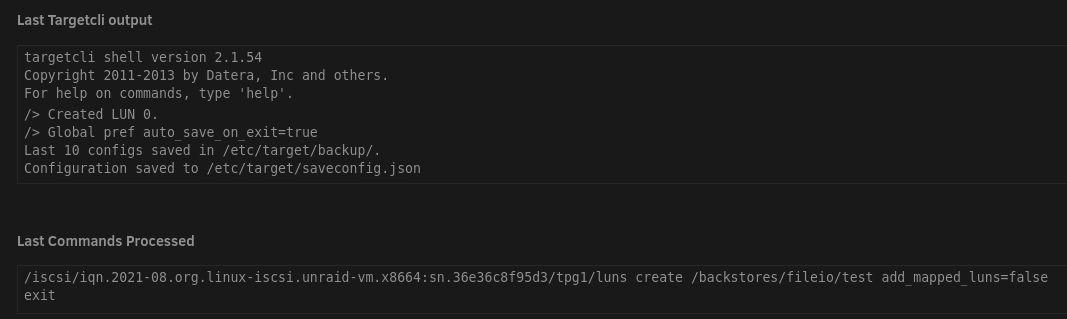

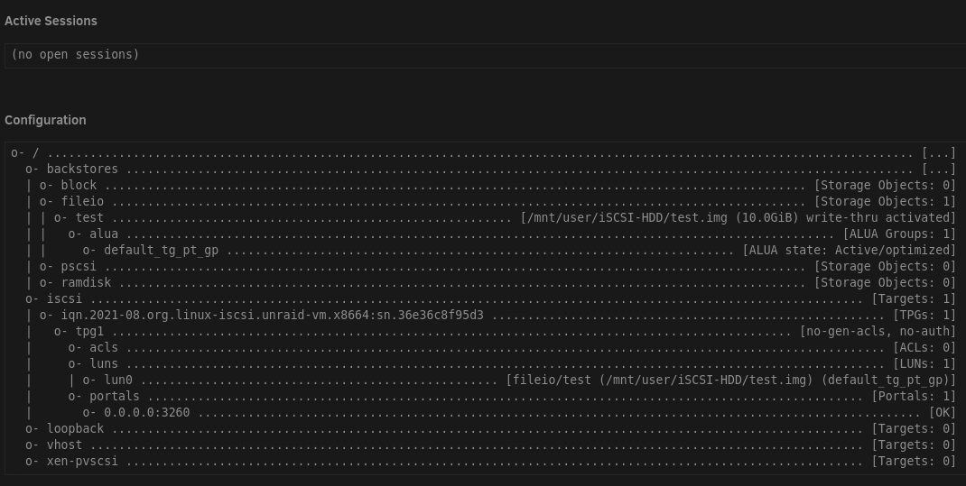

Is there a guild I can follow or instructions to get this working? I have tried to create a target by putting in a name and clicking the add target button but nothing happens.  Clearly I don't know what I am doing.
In the Diags window it says this for the last Targetcli output.
targetcli shell version 2.1.54
Copyright 2011-2013 by Datera, Inc and others.
For help on commands, type 'help'.
/> WWN not valid as: iqn, naa, eui
/> Global pref auto_save_on_exit=true
Last 10 configs saved in /etc/target/backup/.
Configuration saved to /etc/target/saveconfig.json
Thanks
Edited by Asus750
Thanks
What are you trying to connect? Can you provide some screen prints?
You need to create the target, iqn luns, map the luns.
Luns will need either a drive mapped or fileio
It looks like it started working.  I rebooted the server after messing with it for a while and I have an option to choose a target now under create IQN.  I have an sata SSD that I will be using to test it, and it picked that up on the devices tab.
