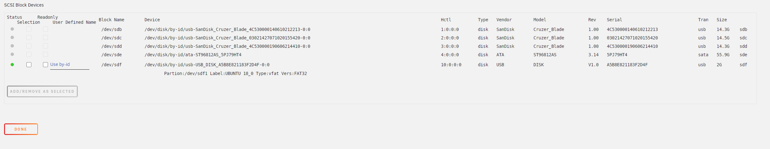

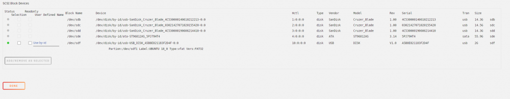

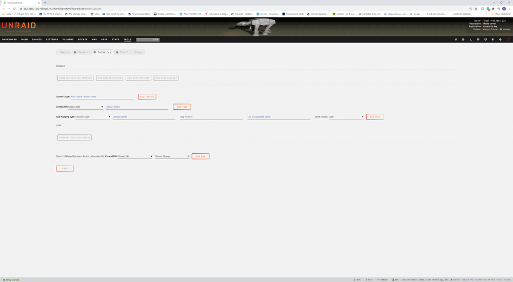

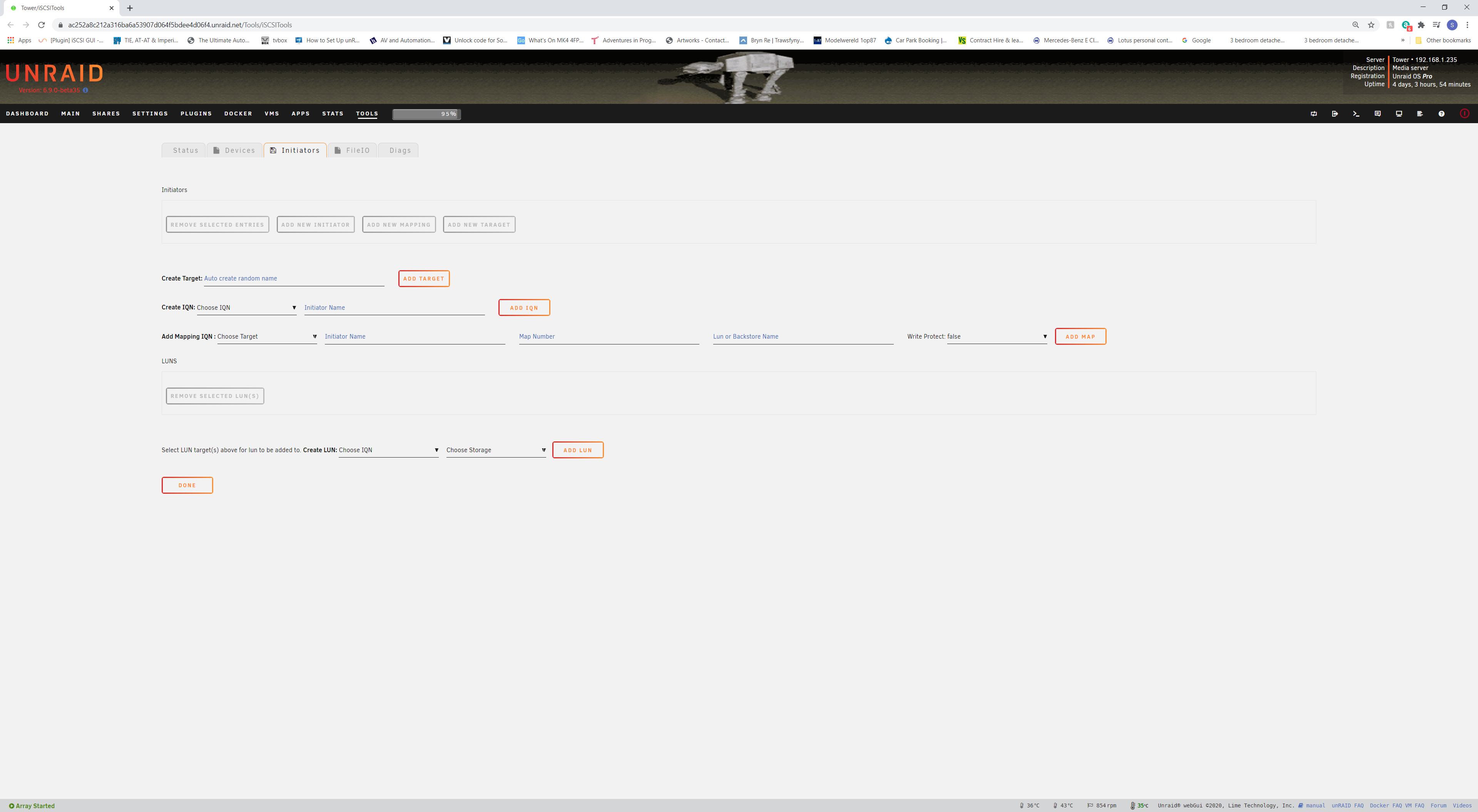

I looked now into the Plugin and at a first glance it looks and feels really good, the mappings from the Plugin page to the Tools menu is wrong, I also would recommend that you put the Plugin on the Systeminformation page and not on the Tools page.
Also where do I create the first IQN if I don't have a IQN yet created? I only get a grey button when I'm on the Initiators page.
Hi @ich777
This is my latest version of my page. I am still working on it as have issues with $POST processing in that it does clear after its processed so if you do a refresh is asks to reconfirm submission. I have raised a question on the programming page to see if anyone has suggestions as i dont have a solution yet.

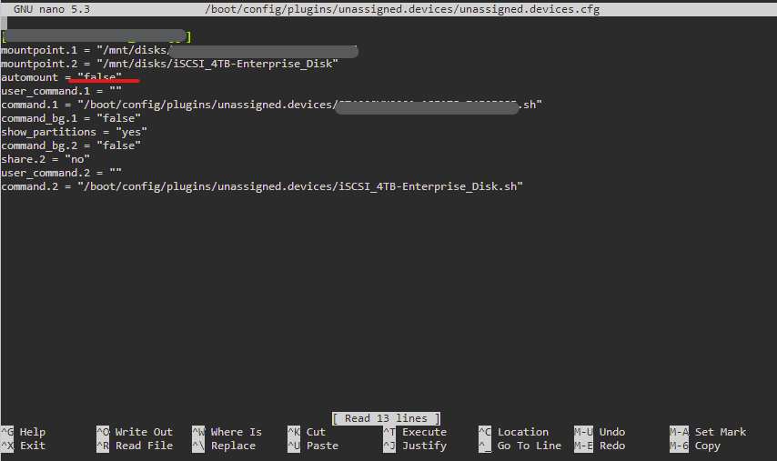

There´s a problem with Unassigned Devices Plugin and this Plugin, when i want to create Blockdevice as a iSCSI-Volume it didn´t recognize if a Partition in it is currently mounted or not, so targetcli can´t create Block-Volume because drive is in busy state as long it´s mounted.
Please fix that.
Simple check on this file would do it if there´s a "yes" entry and set it to "false".

The Problem is that drive partition is mounted by unassigned devices (is the automatic Setting for known filesystems) before "targetcli" can load it as a "block"-device. So targetcli exited with "Drive is Busy..."
So maybe it would be better to passthrough error-message of targetcli to WebUi or check if the marked device is mounted and unmount "before" targetcli is called, only thoughts to make the plugin more comfortable, because no message of targetcli is piped to WebUi.
Edited by stinger2k
The "Passed Through" flag in UD should resolve this
'Passed Through' switch designates a physical disk as passed to a VM or Docker so UD won't mount the disk.
Edited by tjb_altf4
As @tjb_altf4 said, the Passed Through switch within UnassignedDevices should solve this "issue", also you should always use this switch wether the disk is passed through to a VM, iSCSI is using this device or something else.

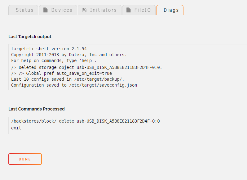

22 hours ago, stinger2k said:
error-message
Looks like you are using the gui within the iscsi-target plugin from ich777.
My gui plugin is a separate plugin, both can co-exist. I don't at present check it the drive is in use but plan is to check, I disable access to Array devices.
I do have a Diags which has the output, but doing a quick check It doesn't pickup the error message so will take a look at that. Fixed in next release.
