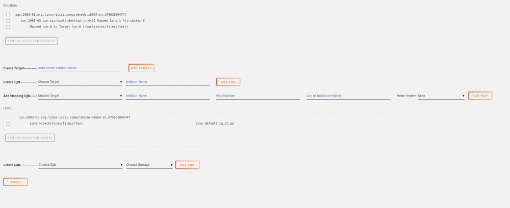

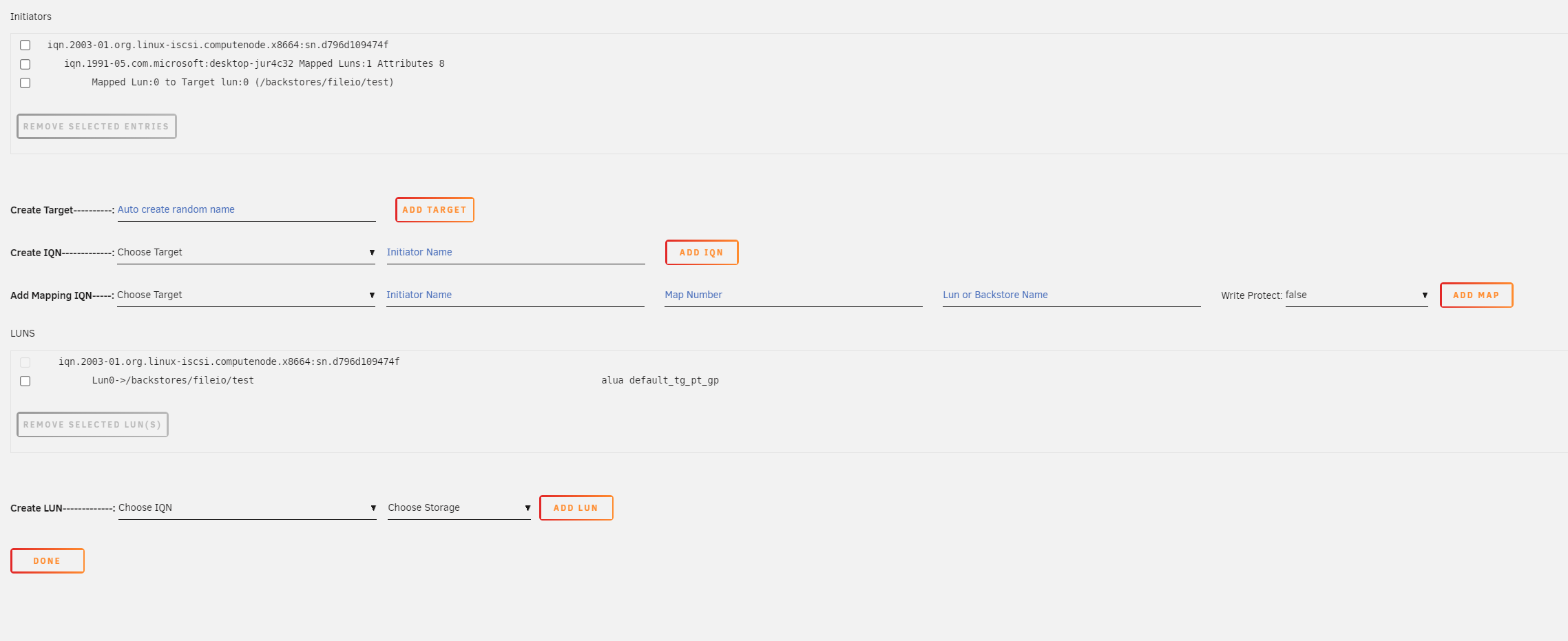

I just installed the plugin and created a initiator by going to "add target", then I added a lun. I am trying to use the client on windows server 2012 r2, it can see the target but the status shows "inactive". what did I miss?
Have you also assigned the initiator identification to the LUN?
What does the syslog from unRAID say?
I think it may be missing which initiators can access the LUN.
I see the below log
Jul 31 13:34:55 UnRAID kernel: iSCSI Initiator Node: iqn.1991-05.com.microsoft:win-ra6eums5oqa is not authorized to access iSCSI target portal group: 1.
Jul 31 13:34:55 UnRAID kernel: iSCSI Login negotiation failed.
Jul 31 13:35:36 UnRAID kernel: iSCSI Initiator Node: iqn.1991-05.com.microsoft:win-ra6eums5oqa is not authorized to access iSCSI target portal group: 1.
Jul 31 13:35:36 UnRAID kernel: iSCSI Login negotiation failed.
Jul 31 13:36:26 UnRAID kernel: iSCSI Initiator Node: iqn.1991-05.com.microsoft:win-ra6eums5oqa is not authorized to access iSCSI target portal group: 1.
how do I assign initiators to the LUN?
Are you able to provide a screen print of the initiators tab or the status page.
I actually
I managed to create the initiator. its working now. I didnt do the "Add IQN" (second line) bit.
Thanks
