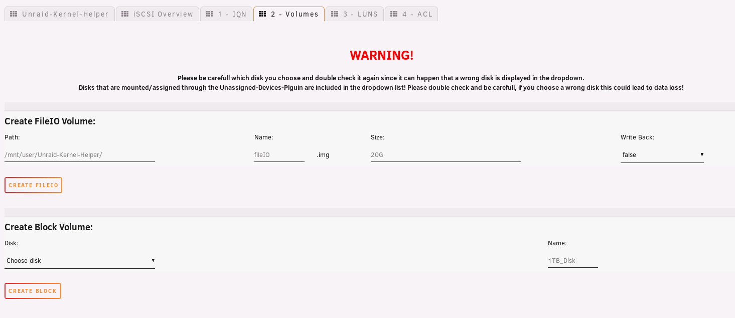

if you fill the name and hit enter it creates it
This isn't the default behaviour there shpuld be a button. But as I said have to look at it again...
yeah we have fixed that part and added a few features to make it a bit more user friendly
also added a bit of ajax to the back end to clean some code up, hope your alright with that.

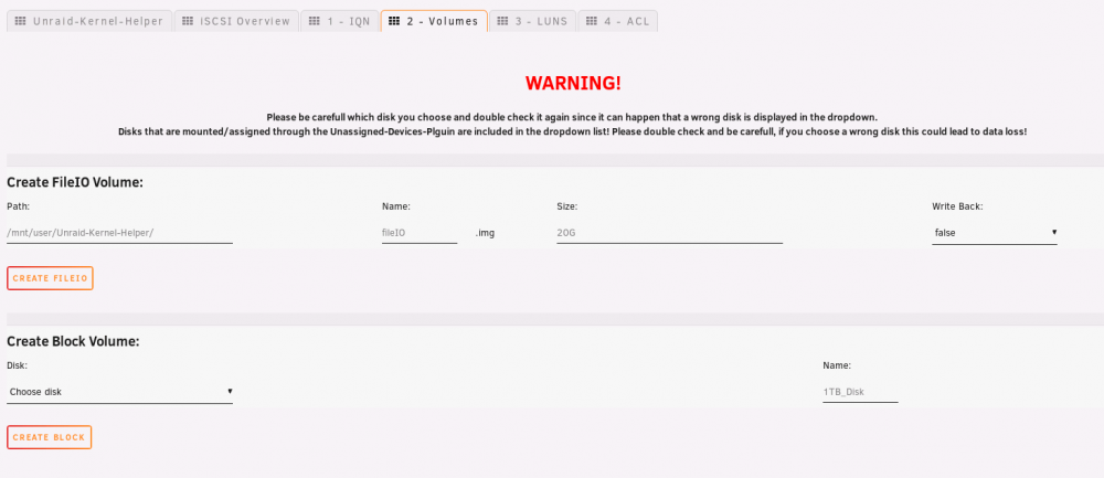

you didn't add the parts
Custom name your own IQN
extended info in volumes tab showing name, sizes and write back of current volumes
info in LUN tab for each one so you can edit or delete current LUN's
info in ACL tab for each one so you can edit or delete them a lot easier and see what you already have setup
we uploaded these to the depository, not something you are interested in for this version?
