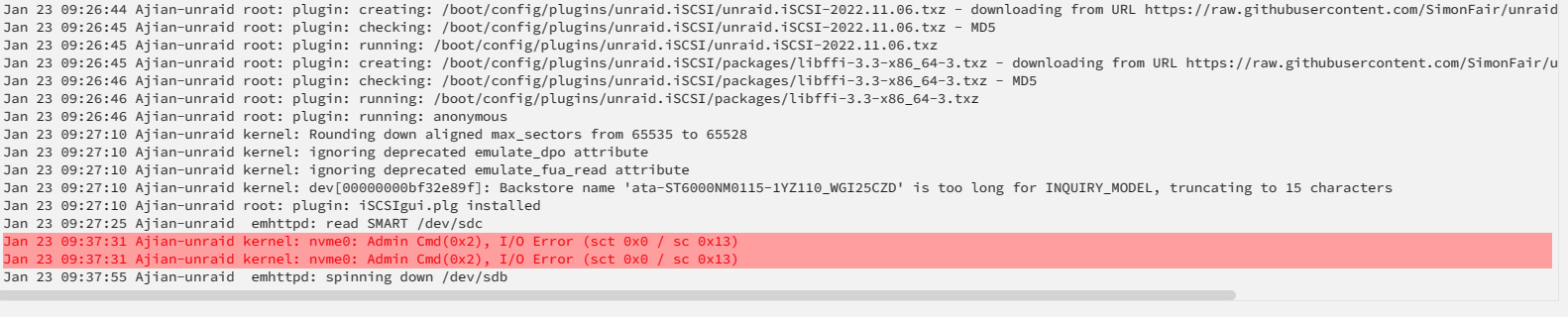

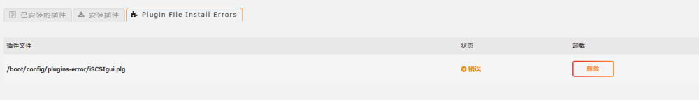

unraid升级6.11.5、iscsi升级 2022.11.06后,重启unraid后,iscsi报错误,无法使用,移除后重新安装恢复使用,但unraid重启后,iscsi还是报错。
5 minutes ago, laidou said:
After unraid was upgraded to 6.11.5 and iscsi was upgraded to 2022.11.06, after restarting unraid, iscsi reported an error and could not be used. After removing it, reinstalled it to resume use, but after restarting unraid, iscsi still reported an error.
What error do you get?
6分钟前,西蒙F说:
你得到什么错误?
3 minutes ago, laidou said:
Can you post diagnostics? Maybe a download failed. Which Version are you using?
Or paste Installer page
Install Plugin
plugin: installing: iSCSIgui.plg
Executing hook script: pre_plugin_checks
plugin: downloading: iSCSIgui.plg ... done
plugin: downloading: unraid.iSCSI-2022.11.06.txz ... done
| Installing new package /boot/config/plugins/unraid.iSCSI/unraid.iSCSI-2022.11.06.txz
Verifying package unraid.iSCSI-2022.11.06.txz.
Installing package unraid.iSCSI-2022.11.06.txz:
PACKAGE DESCRIPTION:
plugin: downloading: libffi-3.3-x86_64-3.txz ... done
Verifying package libffi-3.3-x86_64-3.txz.
Installing package libffi-3.3-x86_64-3.txz:
# libffi (A Portable Foreign Function Interface Library)
# FFI stands for Foreign Function Interface. A foreign function
# interface is the popular name for the interface that allows code
# written in one language to call code written in another language.
# The libffi library really only provides the lowest, machine dependent
# layer of a fully featured foreign function interface.
# Homepage: https://sourceware.org/libffi/
Executing install script for libffi-3.3-x86_64-3.txz.
Package libffi-3.3-x86_64-3.txz installed.
----------------Downloading iSCSI v2.1.54b, please wait...!---------------
----------This could take some time, please don't close this window!----------
--------------Successfully downloaded iSCSI, please wait...!----------------
------------------Installing iSCSI v2.1.54b, please wait...!----------------
---Starting iSCSI Target, please wait...!---
----------------Installation of iSCSI v2.1.54b successful!------------------
unraid.iSCSI has been installed.
Copyright 2016-2022, SimonFair
Version: 2022.11.06
plugin: iSCSIgui.plg installed
Executing hook script: post_plugin_checks
Edited by SimonF

问题是重启unraid系统后,iscsi报错!需移除重新安装,每次重启后都需要重新安装一次。
Do you see errors in boot log for plugin?

The syslog, when installing plugins do you see any errors?
20 minutes ago, laidou said:
报错后无法查看iscsi日志,重新安装后日志空白
Please post your Diagnostics after installing the plugin.
