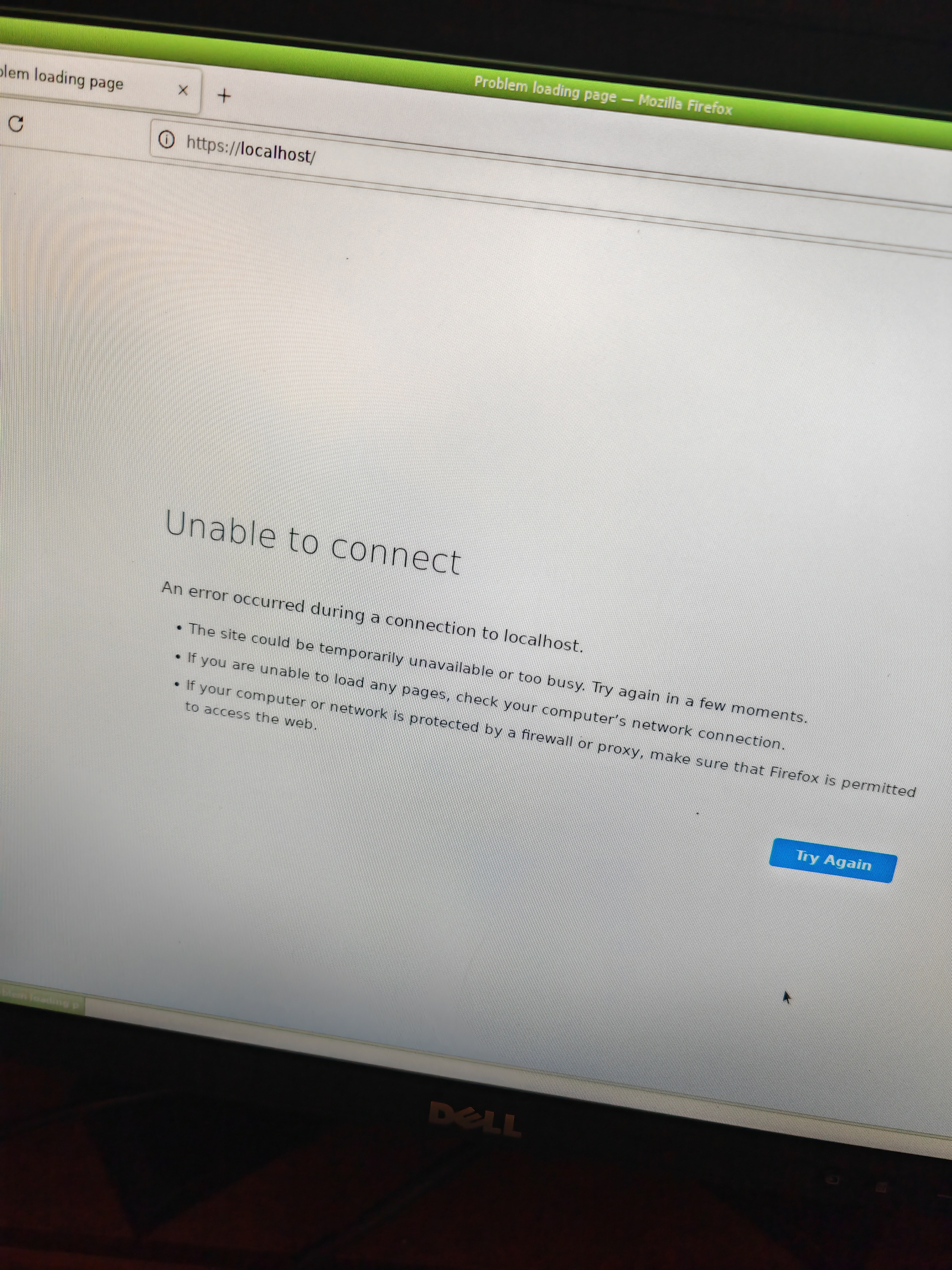

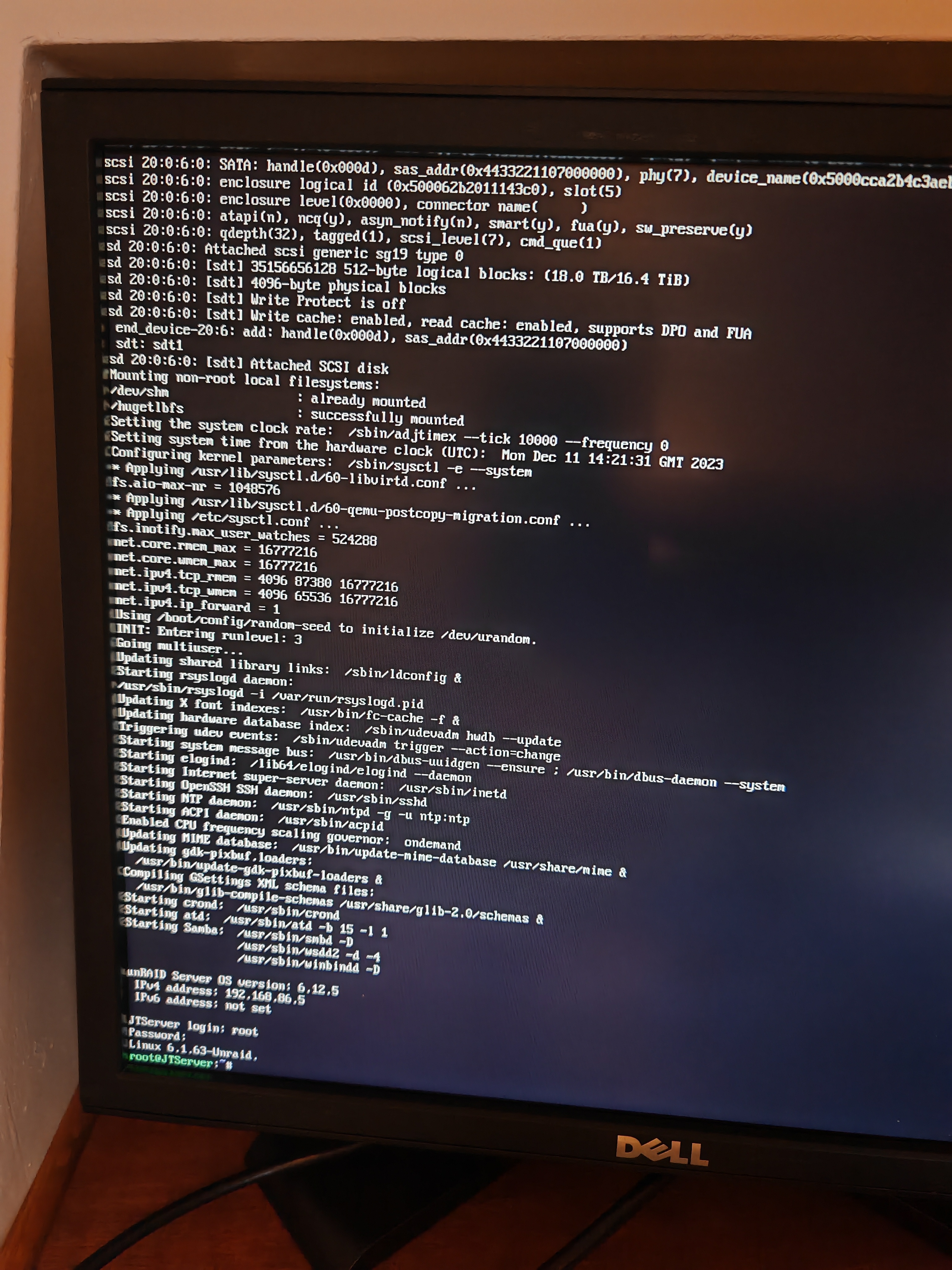

  14. Hi all My Unraid server alerted me to the new version available for download so I allowed it to download and clicked to reboot. I went away to do something but returned 20 minutes later and it still wasn't up and running? I plugged a monitor/keyboard into my server and it seemed to be working normally but I logged in and typed "poweroff" and then rebooted it. Again, it appears to boot normally (see below) ? Still no access to the WebGUI or any shared drives etc. So I tried to boot into Safe Mode with GUI but then I get this... Does anyone have any ideas on what I can do to fix this? Many thanks for any help you can provide.
