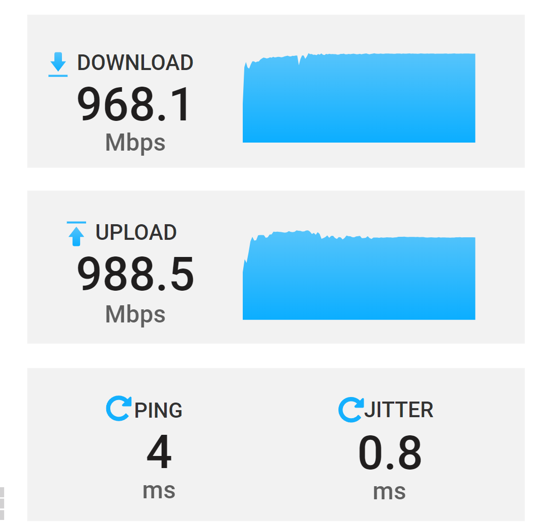

My Unraid server seemed to be responding slowly so I added the "SpeedTest by OpenSpeedTest" app and tested the speed and it's locked around 90Mbps but I should have a 1000Mbps connection ?

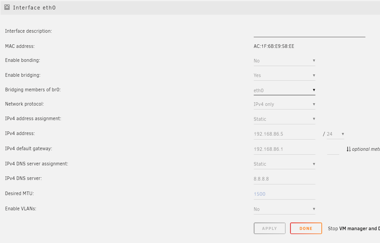

My settings are as follows:
Am I supposed to have Bonding enabled or anything?

Just an update... fitted the cable today and that has sorted it!!
We're now cooking on gas!! Thanks again for all your help :)
