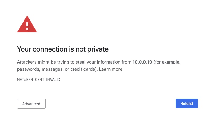

  11. Thanks for all your help. I'm now able to log into the web interface. Just need sort out the ssl cert stuff correctly this time
  12. I have edited the ident.cfg file and set use_ssl to no, but the address in the browser is still getting rewritten, do I need to reboot or send some form of kill to cause the config file to be reread
  13. I enter http://10.0.0.10:1080 and it gets rewritten as https://10.0.0.10:1443
  14. Hi, I was attempting to update the certificates for my Unraid server and some how I have managed to muck up the process and now I can no longer connect to the web interface. I can still ssh in to the server and login on the console. Is there a way I can manually, on the command line, set the connection protocol to http rather than https and ignore the whole certificate problem I have created for my self, so I can get in and try setting up for the new certificates. Thanks for any advise. I have attached a screen shot to the error I'm getting when trying to connect David
