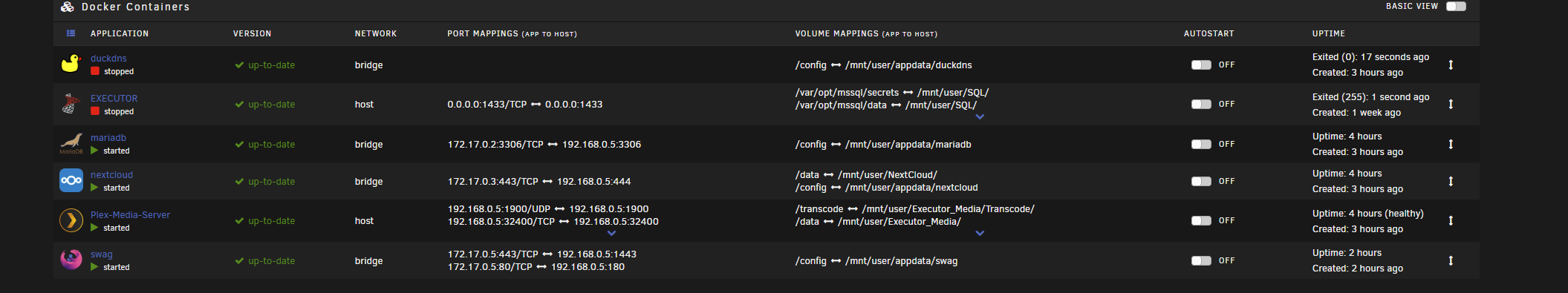

  1. I am using the docker for Microsoft SQL Server and I can connect to it locally. But I have a domain now and I would like to attach it to my domain. I've setup the DNS for it, and I'm using NGINX proxy with Cloudflared tunnel. I've got Nextcloud and my Bitwarden working just fine with this setup but for some reason I keep getting "Bad Gateway" when trying to setup my SQL Server. Everything is setup the same way my Nextcloud and Bitwarden are so I'm not sure what I'm missing. Is there a config file or something that needs to be setup?

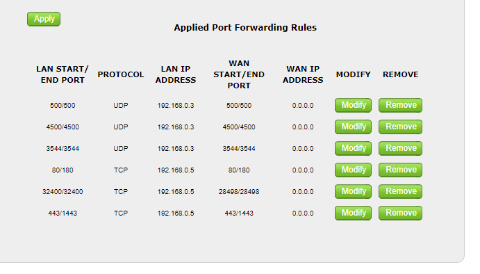

  2. Hi all, I'm hoping someone can help. I'm having a heck of a time getting connected to Nextcloud via the internet and my domain. I've followed SpaceInvader Ones updated tutorial on how to setup NextCloud to the letter and everything was going great. I also followed his tutorials on setting up my own domain, setting up cloudflare and duckdns. Everything looked good as I was setting it up. But I'm stuck on the port forward portion of part 1 of SpaceInvader One's tutorial (roughly the 13 minute mark). I've opened ports starting with 443-1443 as he described But that didn't seem to work. It just says "Site can't be reached". So I though maybe there was a permission I needed to set. Which I did, even tried setting up all ports open but still can't get connected. I then began messing around with some of the advanced settings and found something strange. Which was If I disable NAT it then looks like its gonna connect but only for a second cause then I lose all internet connectivity. Here is my list of containers I'm not sure what I'm missing. I'm very new to all this. Any help would be greatly appreciated!

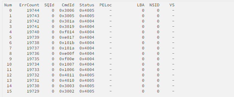

  10. So I followed your command in the terminal and got the following But then nothing happened. I tried to do another format through the array but no luck I attempted to run the SMART short quick self test (The longer one is grayed out) but I click the button and it seems like nothing happens. When I open the error log for the under the same test tab I see this You mentioned me sending you the diagnostics. So I did the format and then ran the diagnostics and have attached them. I hope this is what you are looking for but let me know if you need anything else. Also I really appreciate your help! executor-server-diagnostics-20220929-1127.zip
